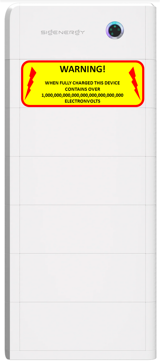

kWh is very confusing, really should be Joules, it has nothing to do with time in spite of having hour in the name.
kWh is the opposite of confusing, it absolutely has everything to do with time, and is far more useful and informative than J.
If I have a battery containing 5kWh of energy, I know instantly that I can power a 5kW appliance for 1 hour, or a 1kW one for 5 hours, or a 5W one for 1,000 hours. I know almost instantly that if I run a 2.5kW kettle for 2 minutes I'll have used 1/60th of it's capacity.
On the other hand, if I have a battery containing 18MJ I'm not going to know those things, and even if the kettle maker had thought to tell me that the device uses 2500 J/s I'd have a less friendly calculation to do.
Could be worse though - you could quote a 5kWh battery as being approximately 0.427 gigafoot-poundals. :D

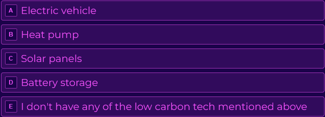

The question is, will they allow you to use "Go" without an EV? It asks me to select 1744469643579.png and when I select solar and battery it only gives me Flux as an option. I went looking at a YouTube video and the rates given were a lot higher for everything, it did say some people have got onto the "Go" without an EV, but you are looking at a minefield of rates, and you would need to do a lot of calculations to work out the best rate.
