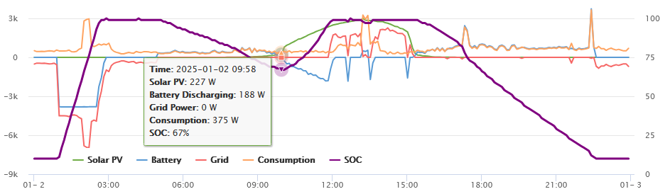

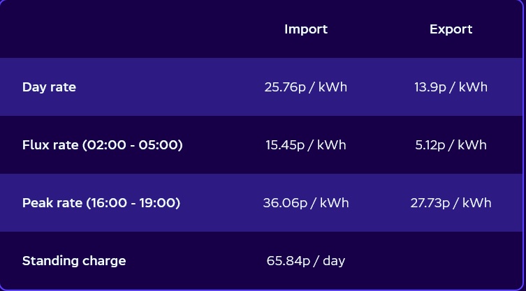

It seems that is the best option for me. But it all changed when I went from 2.88 kWh of useable battery, to 5.76 kWh of useable battery. I say useable as 10% held back in case of a power failure.15p Export + standard tariff - but then there is no value in charging batteries from the grid
To charge a battery at 15.45p per kWh, which results in latter exporting at 13.9p per kWh, does not save money. So have to look at the morning droop in state of charge. Even the 2nd of January
let me look at state of charge, 67% with a 6.4 kWh battery, but would have been 34% with only one battery 3.2 kWh, I exported 4.6 kWh that day, it would have been a lot lower with the old 3.2 kWh battery, I had failed to realised how the extra battery changed how much power exported. It reduced the import in the evening, but caused a larger export around midday.
