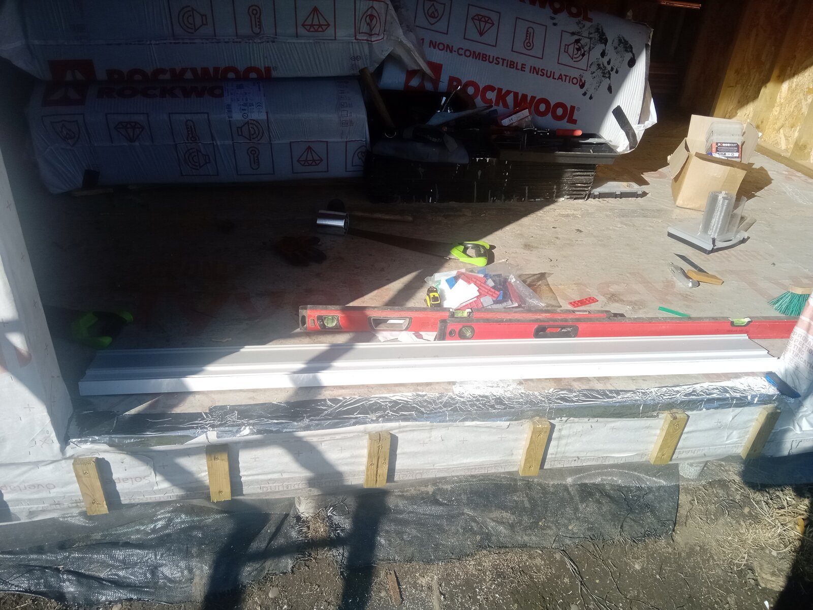

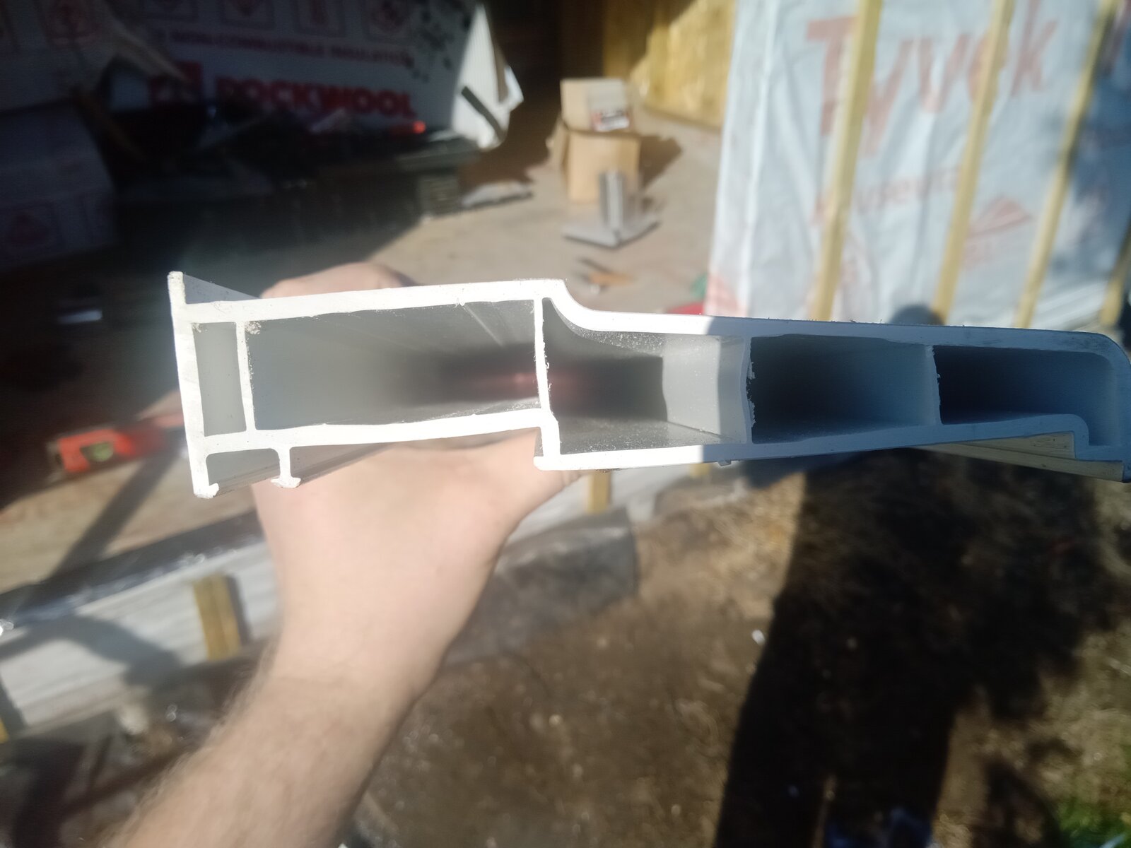

Hey folks,
I got some doors delivered for my garden room today and I can't see any drainage holes in the sill. There isn't anything in the instructions about creating them.
If it's not too daft a question could you kind people tell me if I should make some before fixing the sill?
Cheers
Larry

there won't be any holes through the cill, depending what type of frame you have you will either have ' base ' drain , which drains from under the frame ONTO the cill, or ' Face ' Drain , which has holes out the front of the frame and caps to cover them, which will also drain ONTO the cill
Hi Ronnie, that's great thank you! I found the holes in the frame you were talking about.
