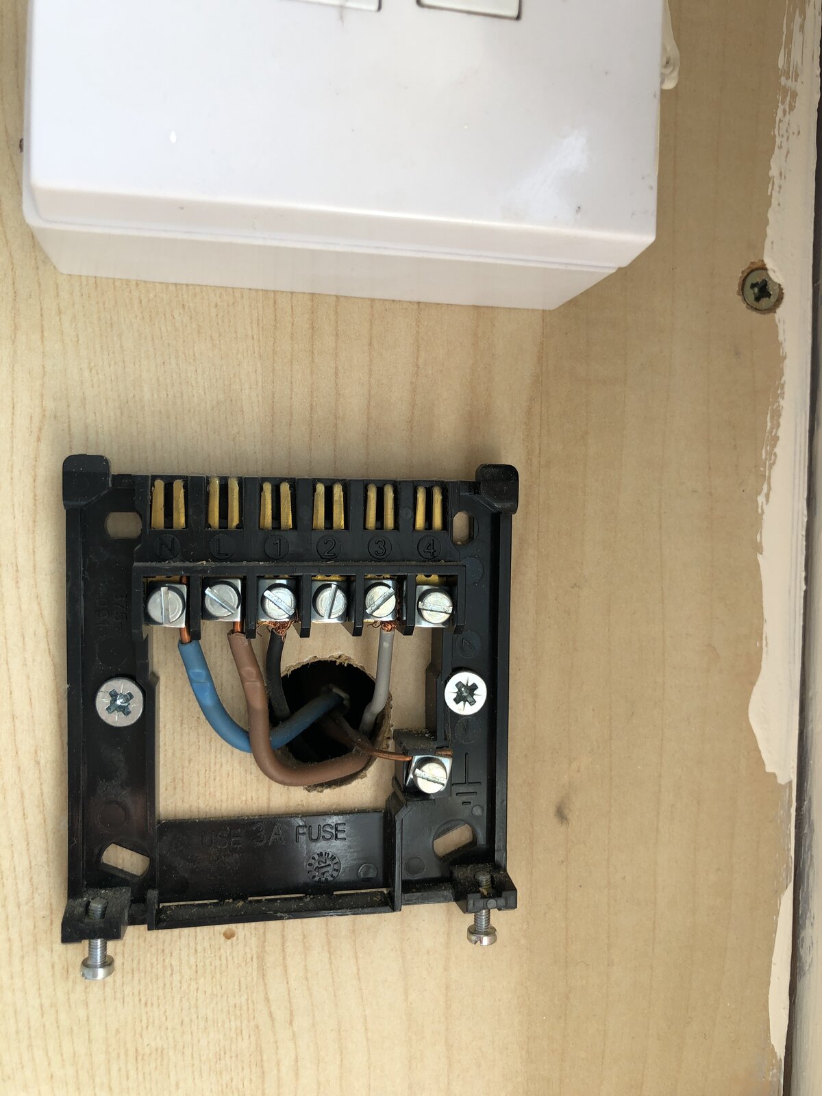

Guys
I’m looking for some assistance please
Setup is a Sime murelle he with a wr1 bg receiver and digitstat
Looking to put a hive in but my receiver is a dual channel.
I have wired into other boilers with a 230v connection
My question is
Is the Sime 230v or can it be switched.
If so where is the switch
Don’t have a manual to hand a small screen with no glassses so any assistance appreciated
Cheers
Pic attached

Yes, apologies. I had written for a single channel, not dual channel, so that would have been useless too.
It’ll be L to L
N to N
Disregard Com and make safe
Connect NO to terminal 4
Hi thanks for that
Will check on how to make it 230v in boiler as that’s the bit I didn’t have
