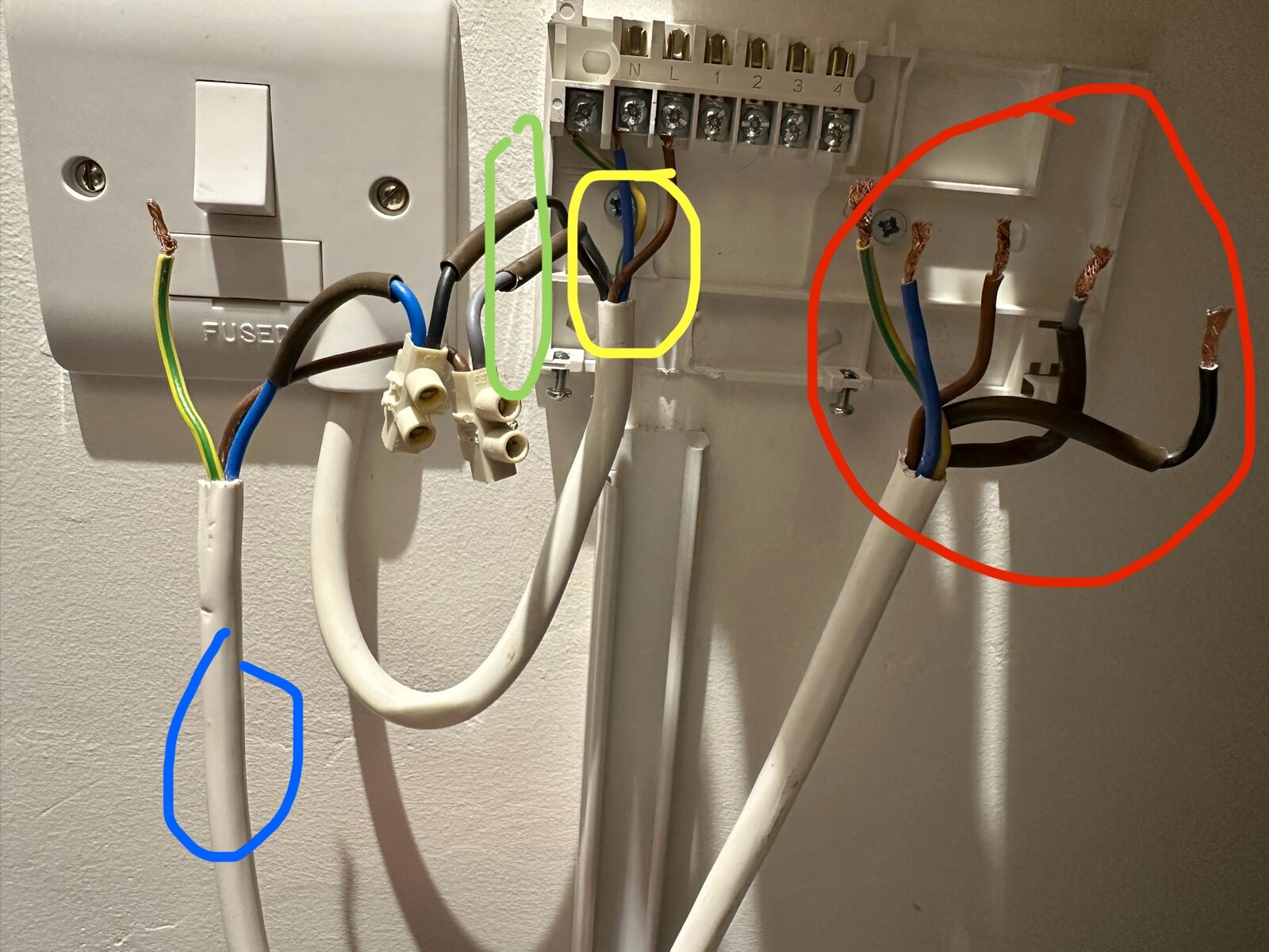

Hi all
Trying to install hive single channel on a combi grant oil boiler
I have removed honeycomb channel programmer. But a bit confused as there are 5 wires come from the fused connection unit, what should l do with Grey and Black from the fused connection unit circled in green?
See attached
The cable red circled is from the boil.
The cable yellow circle is from fused connection unit (the 2 wires in green circle is confusing me)
The cable blue circled is to the thermostat control
To boiler you require a permanent live plus neutral and earth and a switched live to heating with a single channel hive you will probably have to reinstate link on hot water side in boiler and have it permanent on.
Boilers can be wired a number of different ways if your unsure clear pictures of boiler board would be useful.
At a guess I’d say they’re for the thermostat you have already. I ant see where the cable goes down though, can you take a photo from further back?

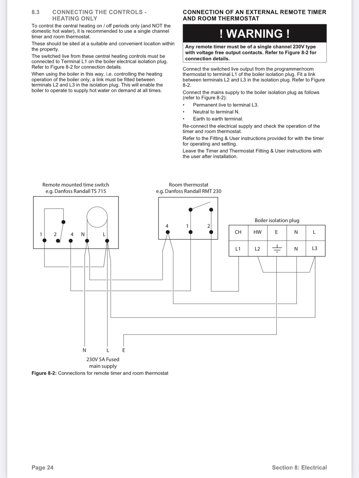

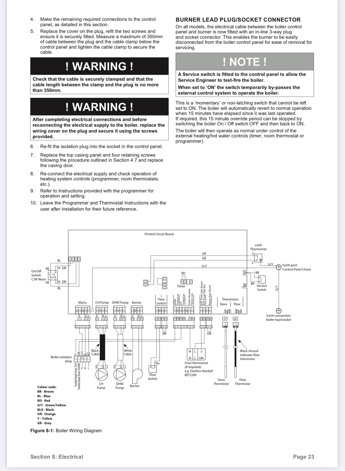

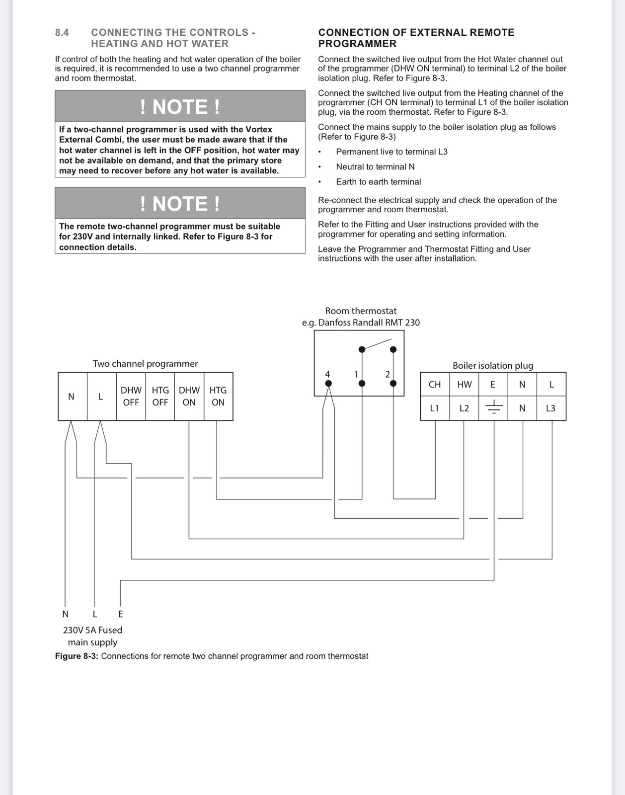

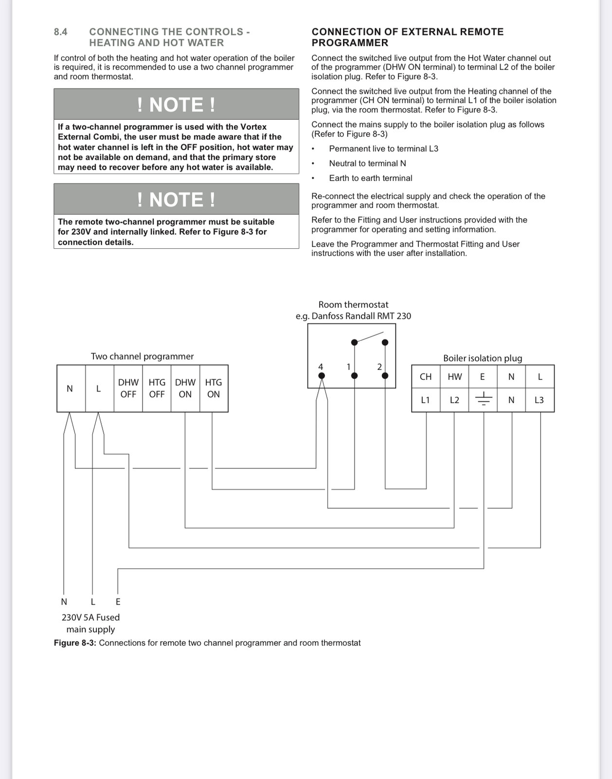

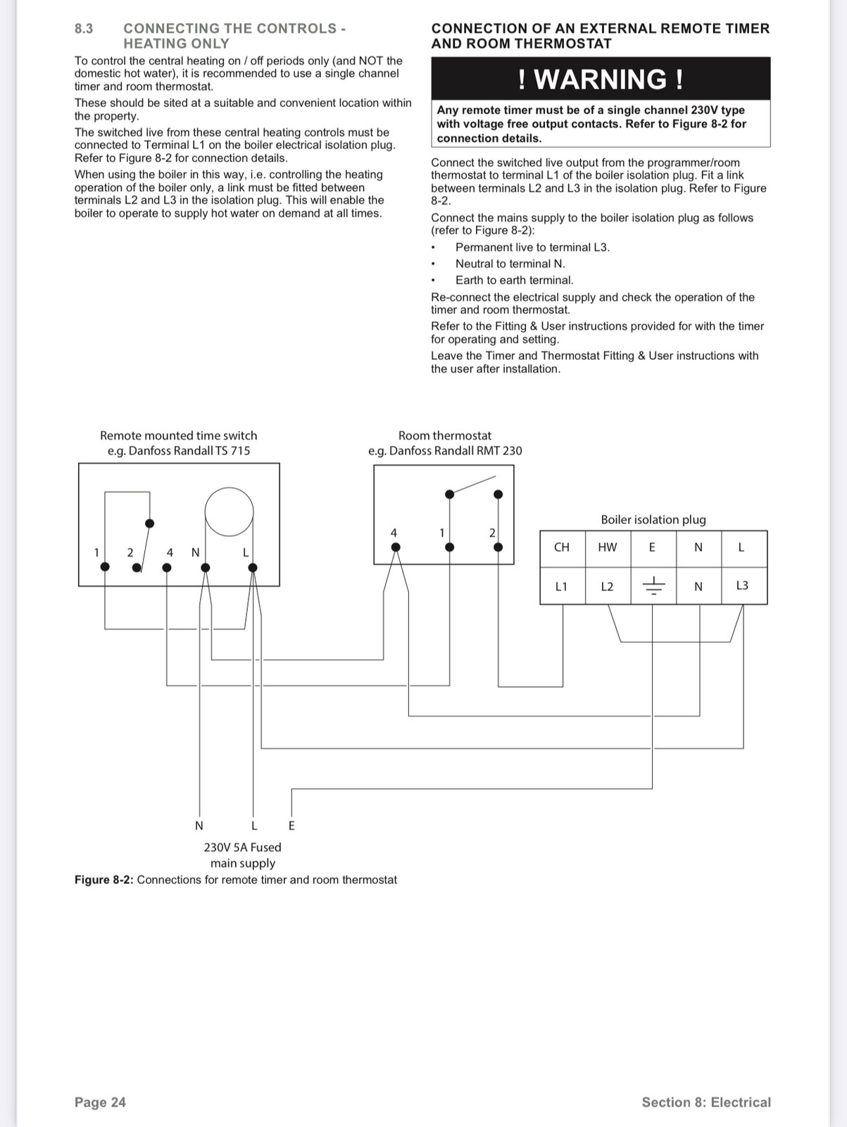

I have also found the manual for the wiring
All straight forward
Earth neutral permanent live to 1 -2-3 switched live from hive to 19 link 17 & 18 if not linked already
Rocker switches to timed on heating switch hot to on.
And how do I disconnect the current thermostat?
Im struggling to find the wiring to the current thermostat
So l tried it
There is a link between 17 and 18 already
19 to 1 on hive
And 20 to 3
But the heating doesn’t come on
What am l doing wrong
Also removed 25 and 26 where it says ROOM STAT so assuming that is for the thermostat
I would have thought either Hive needs to be wired into 25/26 or link needs to be left in
You have already noted cable you have circled blue is to thermostat just don't couple it up . I would replace that cable with a 3 core into fused connection and then to hive .
I take it the 5 core circled red goes to boiler?
I'f so connect as above with a single channel hive you will have one core too many just make spare electricity safe.
You don't need anything to ,20 that's a permanent live feed through board.
Room stat connection needs to be linked.
