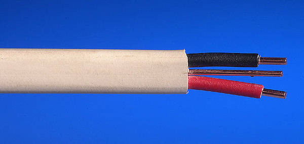

Single/multi refer to the number of conductors in a cable, not the number of strands in each conductor.
This is a single-core cable, even though it is stranded:
This is not a single core cable, even though it has solid cores:
