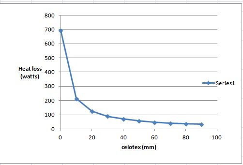

How did you create that graph? What assumptions are you making?

I don't have the exact calc' I used for the single brick width but those below are roughly the same as those in the chart. For the insulation I used the celotex PL4000 data and just changed the insulation entry for each thickness. It's crude as there's no allowances for heat loss through the floor, and roof. If I guess at +50% that would put heat loss at 1000W.
The previous owner put in a 60W tube heater which I thought was odd because my gut feel suggested it'll be woefully inadequate. Though as upthread to heat it would cost £ and be a waste. In this hot weather the walls in there are hot to the touch so assumed the reverse in winter.
Anyway I wanted to run the numbers or atleast at best a crude estimate.
1.bare wall
>wall at U value 4.54, R value of 0.22
>celotex 4040 (40mm+12.5) 0.54, R value of 1.85
>temp change of 20C
>area of 7m2(I did forgot the roof, and the floor) (0.95m*2.4m) + (2m*2.4m)
>so 2.27*20*7
=636W

That's not very convincing; why does "1. bare wall" mention celotex? Where does the number 2.27 come from? etc.
Might plausibly be the right final answers, but no points for showing your working.
