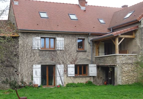

We are looking to install 23m2 (6.6x3.5m) mainly glass single storey extension on the back of our French stone farmhouse as per the pics if I managed to include them correctly.
First of all, with regards to opening up the back wall of the house, ideally we would like to take out what is currently a patio door and a window to create a full width opening spanning 5m. We have had 2 local Macons quote for this and both believe that we will need a central supporting column of about 60cm diameter. Is this really the case? Would a correctly sized 5m RSJ/UB really not be sufficient to support the back of the house? For comparison sake, roughly how much would labour and materials for this aspect cost in the UK?

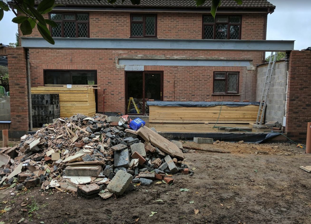

6.5m is long but it's not that unusual in the UK to open the back of houses up and span larger distances than this. Depending on the construction of the original house it may be a pita to do especially is it's rubble infill etc.
Columns don't need to be that big as the weight is in compression but you'll need to make sure you have enough lateral stability but as both ends of the beams as be restrained you should be alight.
Your warm roof is fine and the joists can sit in the ub minimising the head of the windows/door.

A 5m span within the rear wall is nothing - one of the 203- or 275- deep UC sections would do.
One thing you will have to watch is the bearings - stone walls are notoriously unpredictable in workmanship and you need to ensure there are suitable padstones.
