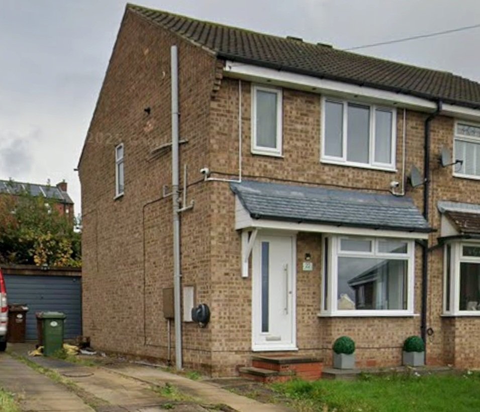

Hi all
I'm wondering wether this would require planning permission.
It's a single storey side extension , 2.5 mtr x 7 mtr.
Will house a downstairs toilet small utility and extend the dining room .

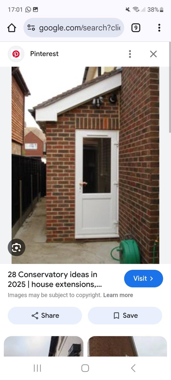

Pic of house attached and what type of extension but no door at the front.
Thanks all
Thanks.
When you say provided it meets , do you mean it would require planning permission?
It's just when I read the side extension part, I'm under what it states size wise etc , I know it entails everything on the portal before this but I'm still unsure wether it's needed ,
What would be the main factors to it requiring planning permission.
It will be Permitted Development provided:
1. It falls within the constraints listed on the Planning Portal
2. Your property hasn't had its PD rights removed.
