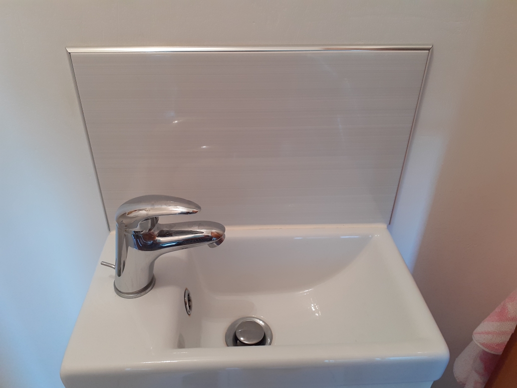

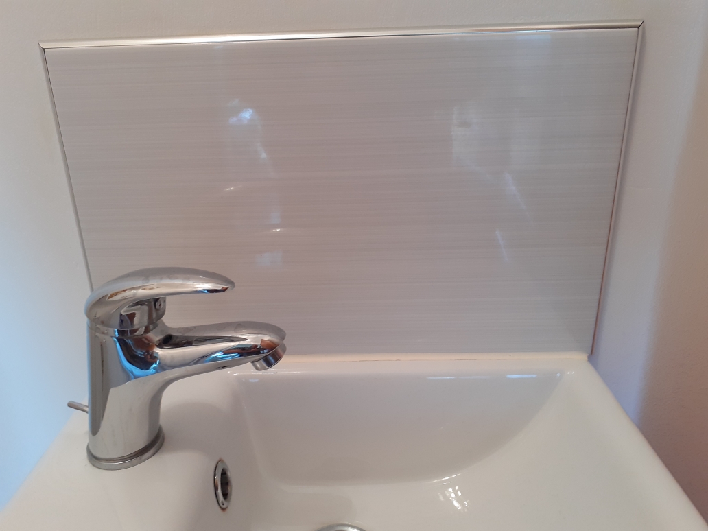

Hi,
Confirm with RandomGrinch, and here is one I made earlier, I also framed the tile with chrome tile trim:
