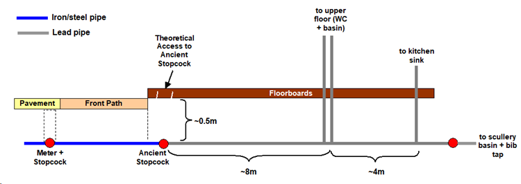

As I recently mentioned in another thread, I find myself with a house that has a (very limited) pre-WWII plumbing installation, which clearly will; have to soon be replaced 'from scratch'. I'm therefore starting to think about some of the concepts of design of that new plumbing system.
My first question is pretty simple, and must be one which fairly often arises. The house is quite narrow and 'long', and below is a diagram of how the supply gets into the house (in fact, it's more-or-less a diagram of the entire current plumbing system!)
Water enters the house under the front door, and there is a stopcock at that entry point. However, it's about 500mm below the floorboards, and obviously will eventually be covered by floorboards and floor coverings ,hence useless as a functional stopcock (although there is one in the pavement, adjacent to a meter) which I am currently using).
The natural routing of the new pipework would be essentially the same as at present, with an (inaccessible) under-floor run of about 12m of pipe to the kitchen sink, which is also roughly the most logical place from which pipes would rise to feed the bathroom(s) immediately above. The first 'accessible' place for a main stopcock would therefore be 'under the kitchen sink'.
Would that arrangement be reasonable/'acceptable' (I suspect it must be pretty common!)? It theoretically leaves that ~12mof unfloor pipe upstream of the 'main stopcock', although I suppose that the chances of any problems with that are very small. I suppose one could bring the pipework up to above floor level near the from door, through a stopcock and then back down to under the floor - but that would hardly be 'neat'. What is usually done in this situation?
Yes, insulate below the floor then stopcock below the sink.
Thanks for your very rapid response.
Does insulation actually achieve anything much, given that all it can do is reduce the rate of heat loss from the pipe? If the house were unoccupied (as it has been for 20+ years!) and if the below-floor temperature fell to sub-zero (probably unlikely, even if unoccupied), then the temp of the contents of the pipe would fall to sub-zero eventually (and hence freeze), even with insulation - merely more slowly than would be the case without insulation.
Yes, if left long enough. I would be treating it as a pipe in an unheated void and still be insulating it. If it is going to left regularly for long periods over winter I would be looking at a way of installing it so it could all (or as much as possible) be drained down.
That's what I would like to be able to do but, short of having some sort of access hatch through floorboards and floor covering, it would presumably only be possible if the entire pipe run were above floor level, which is effectively impossible, since (quite apart from aesthetics) the pipe would then cross doorways and goodness knows what else!

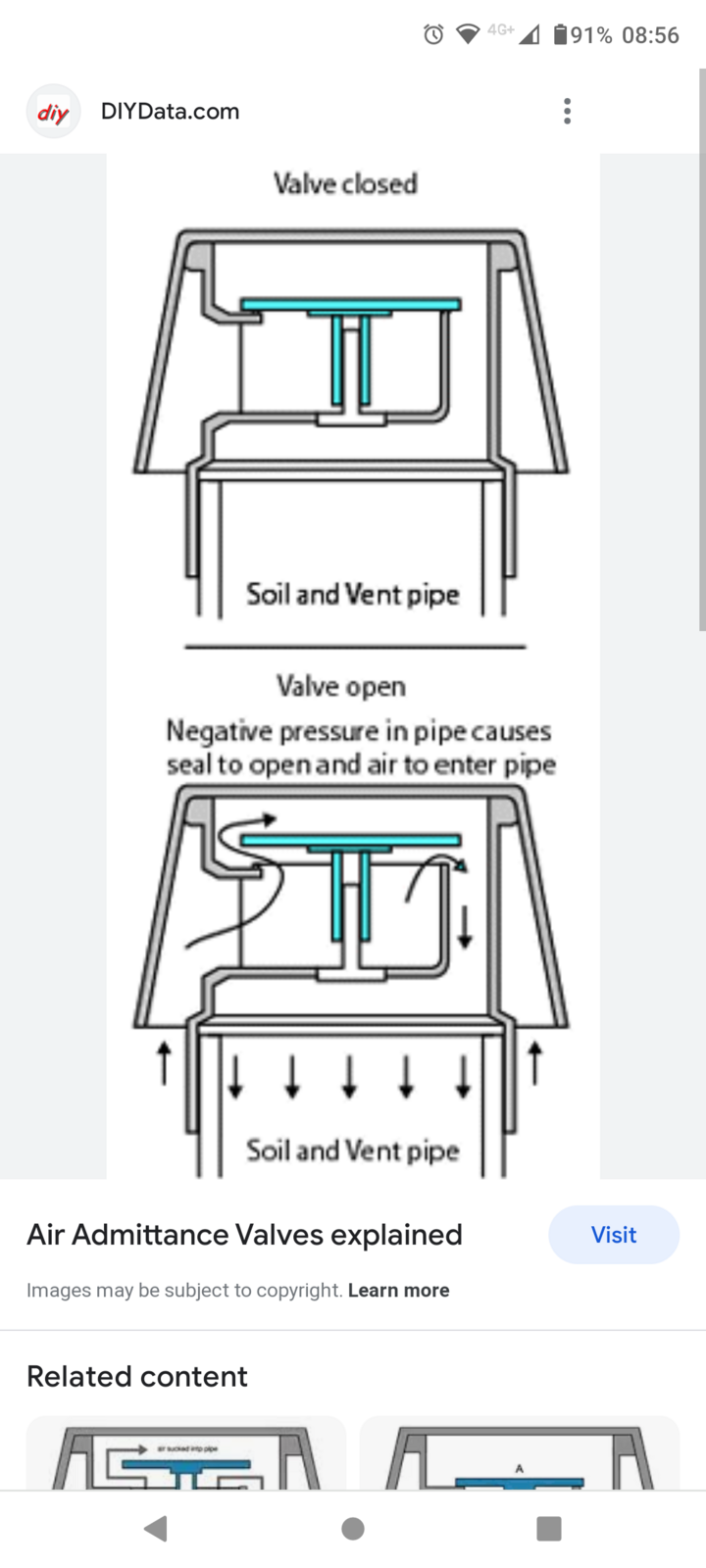

I based my assumption on the fact that a durgo valve ain't letting much air in so as you say, even mine is probably overkill.
Indeed -and I think one thing that perhaps goes overlooked is that, for a given pressure difference/gradient, the size o pipe required to get a certain flow rate of gases is dramatically smaller than that required to get the same flow rate of a liquid such as water.
Whilst accepting that there is always the possibility that I'm wrong, I would therefore have thought that to use 110 mm pipe for, say, just a few feet of 'vent' pipe must be 'dramatically OTT' in relation to what would actually be adequate for the purpose!
