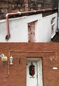

Size of gas pipe for new boiler (Ed.)
I don't know where you get that from. Combis tend to be 28 - 34kW, vs heat-only typically 15kW.
According to my calc if the existing is 15 kW, 15mm pipe up to 8m length is within the allowed 1mb loss, but of course it's up to the OP's installer to advise.
I missed the 8m of 15mm.
