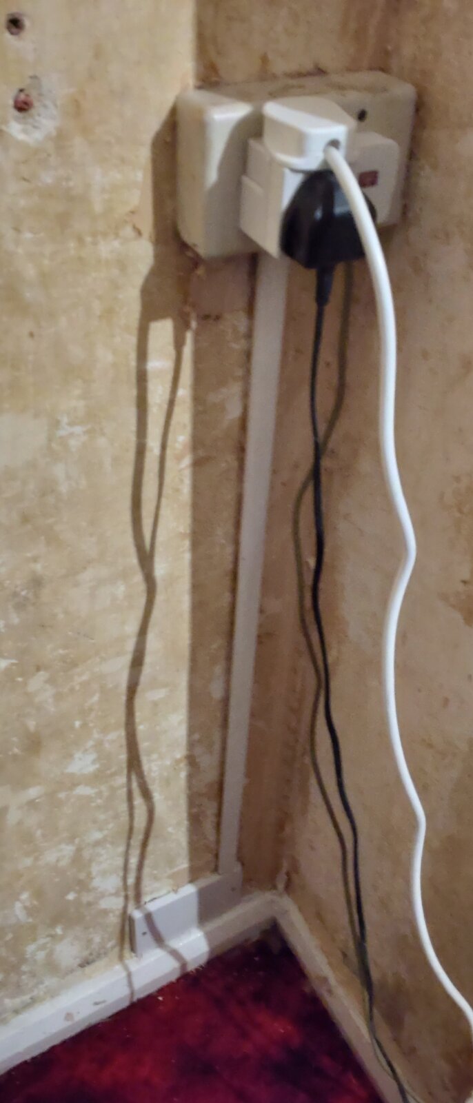

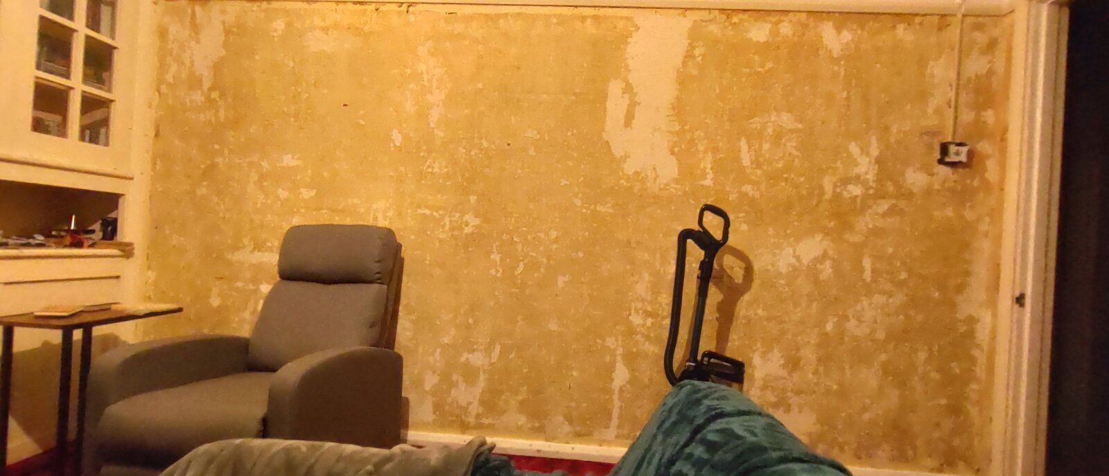

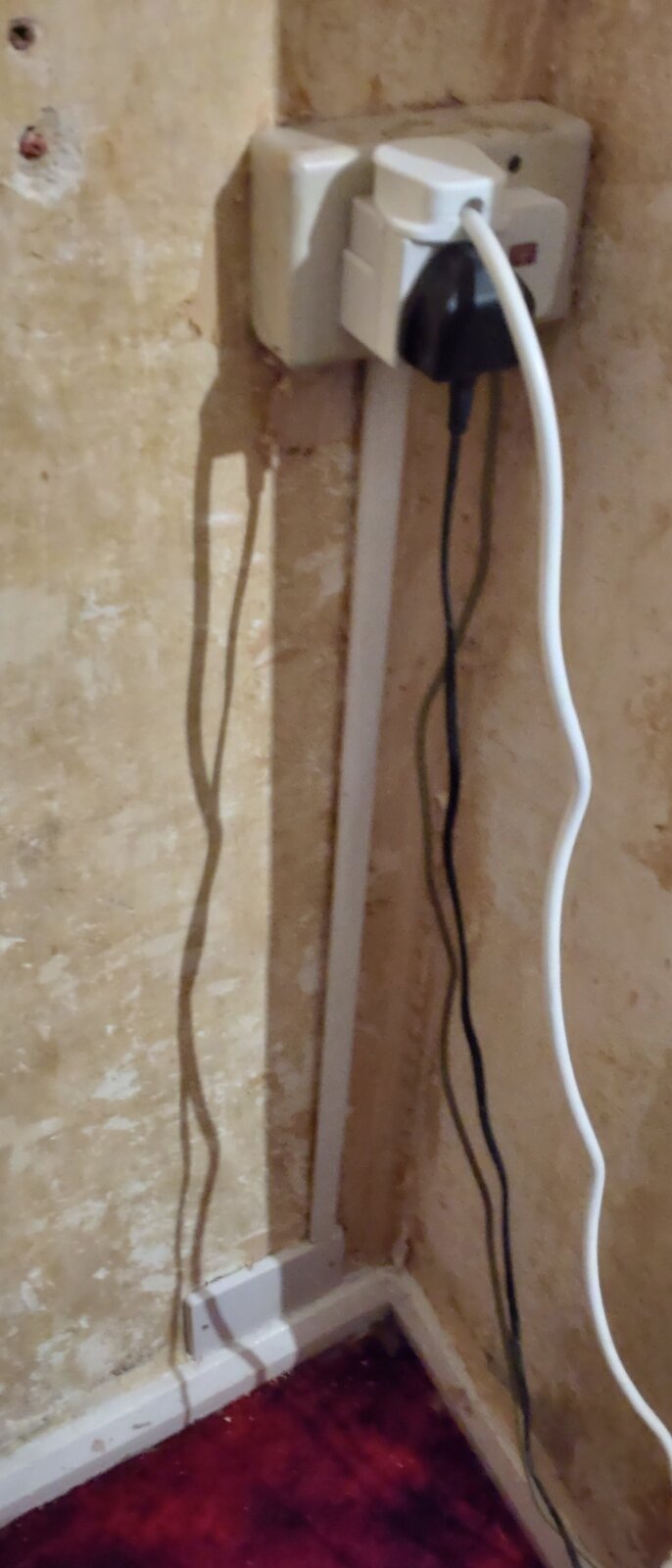

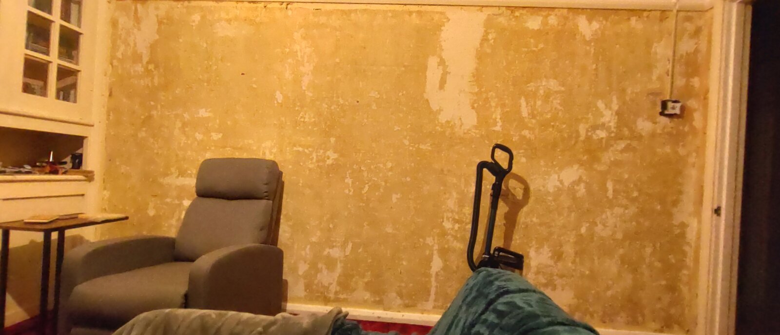

I'm stripping wallpaper of the living room walls but there seems to be glue paste l can't remove.
I want to get the walls skimmed and have been told that l need to put PVA on first before it's skimmed.
Can anyone advise me on how much it would cost to do this work on 4 walls?
Whoever does it will also need to skim behind the plastic tubes that hold the wiring
Photos attached

OP,
2. Run any kind of sander over the surfaces. Take the proud bits off.
3. Two coats of 50:50 Pva.
4. skim.
1. This is actually item number one. Now is the time to sink all elec devices and cabling in metal channels at modern heights in modern safe zones. And add sockets.
Well a good plasterer will do that in a day so £250 - £400 depending on location and skill levels + materials but its a mine field out there with dubious perps passing themselves off as plasterers. 2 or 3 quotes if possible off recommendations from friends and acquaintances. Good luck you because you will need it.
Most plasterers will not want to deal with the electrics.
Assuming that you want this, probably £500-600

I will try to type more slooowly- most plasterers are not electricians. Assuming that the plasterer is not willing to bury the cables and trunking, and the OP has not got someone else to do it, the plasterer will simply plaster around the fittings. I have lost count of the number of houses that I have worked in where plasterers were not willing to loosen face plates and simply plastered around them.
Why would "burying the cables" that we see in the pics "require the skirting to be removed first"?
Perhaps the skirtings would be removed anyway - do you know why?
What is "trim at the top"?
On reflection, the skirting at the bottom would not need to be removed given that the spur(?) seems to come out of a 2 gang back box. Apropos the trim at the top- I cannot see if it is coving or not. It does look like coving that someone has cut a channel into. If so, that channel would need to be made wider so that the upper end of the cable can be buried sufficiently deep enough.
"light switches & sockets " are both electrical devices.
Why did you say: "additionally"?
Granted that was an error on my behalf. However in my defence, you go on to mention adding (additional?) sockets. Without additional fused protection, you are not allowed to run spurs off spurs in the UK.
