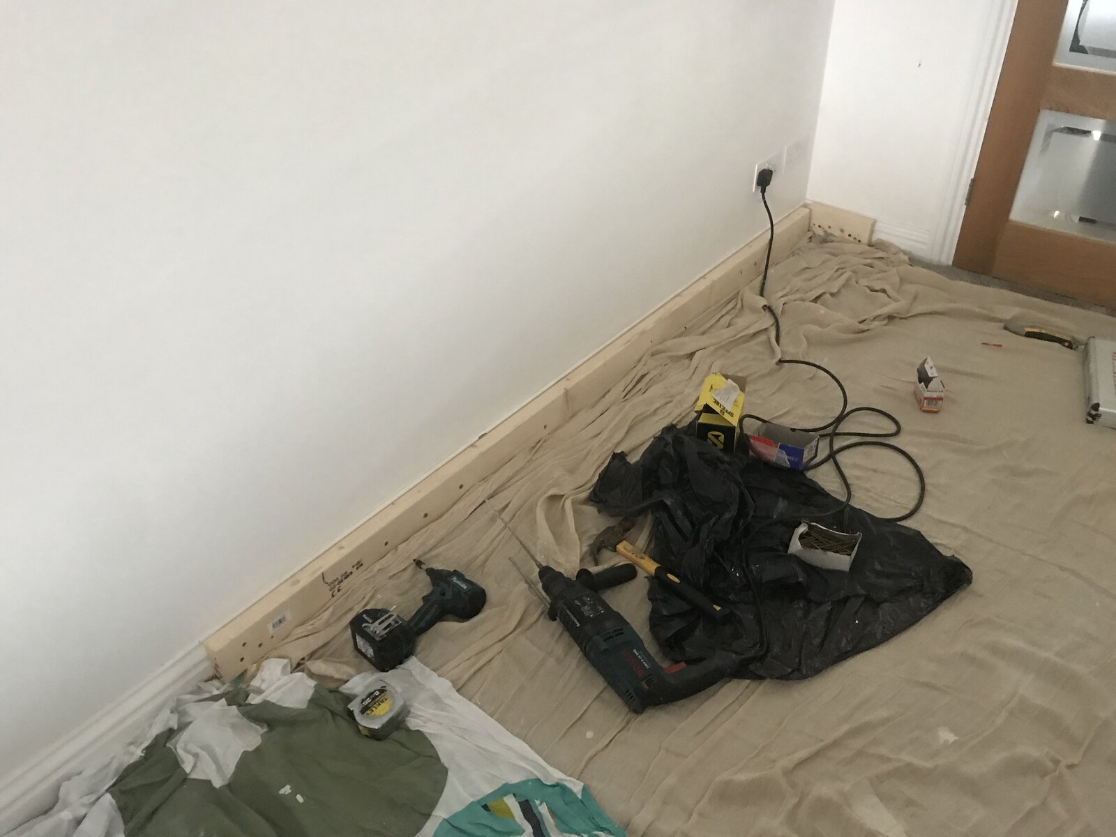

I will screw in a piece of timber to skirting board so it’s the same level as the top of the skirting board. This will provide the base for the back of the book shelf. I can then extend the plinth to support the front too.

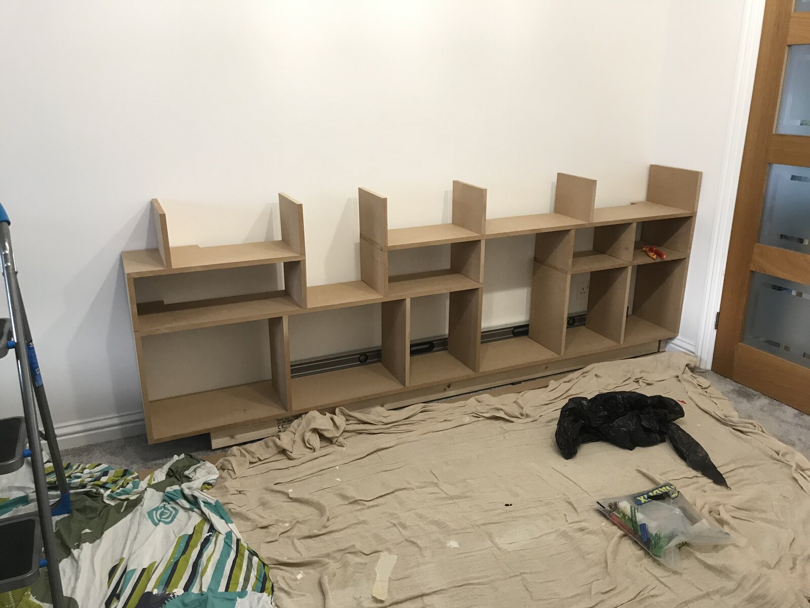

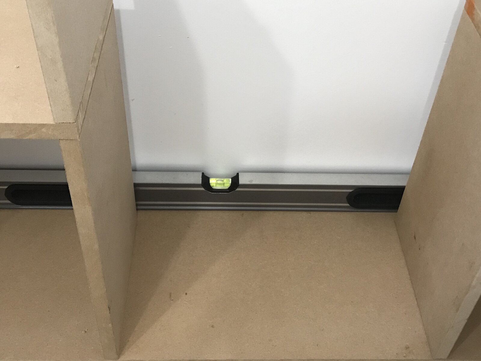

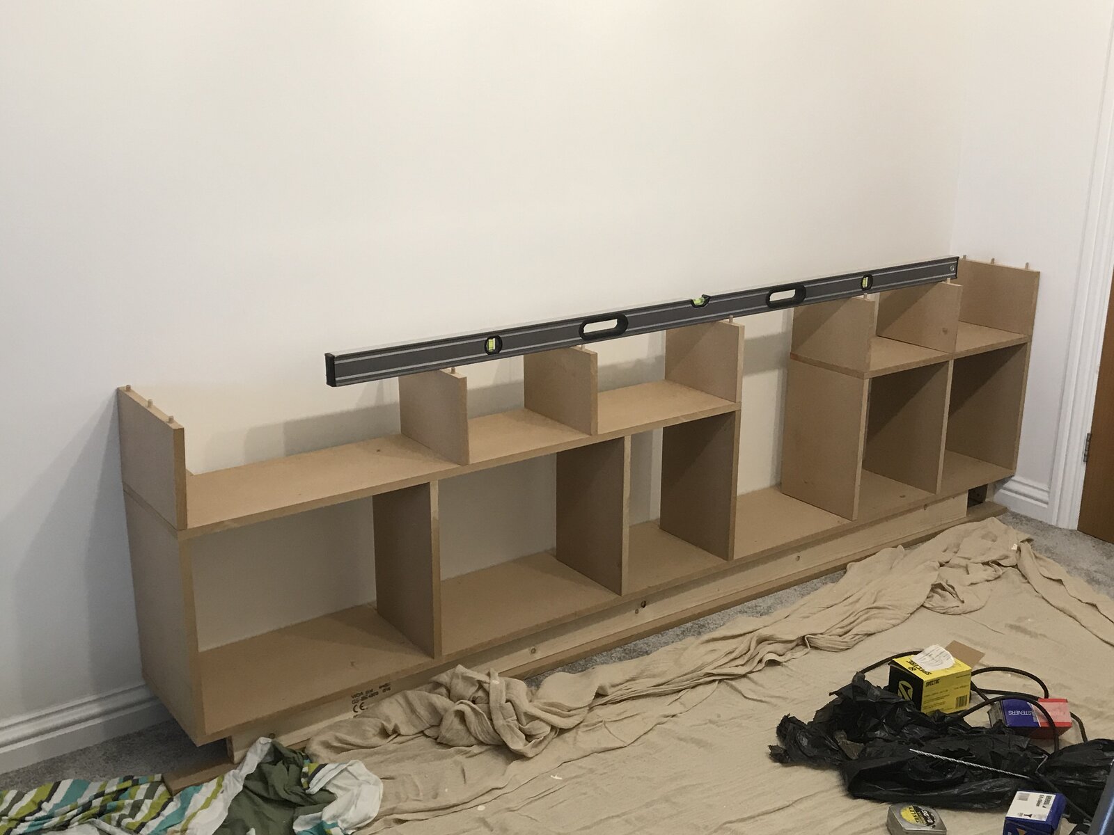

UPDATE: mounted these battens and sitting my bookshelf (work-in progress) on these. I still need to build the front section.

One thing I would have done differently - I would have made the outside ends (gable ends) out of single pieces of MDF running the full height. No joints. This makes for a stronger and more stable shelf unit and will be straight, whereas gable ends made up of multiple pieces joined together will always be weaker. You may also have issues with building the ends dead straight, and when you come to finish (I.e. paint) the completed unit you will find that all those joints will telegraph through the finish if not immediately, then later on.
Not trying to pour cold water on what you are doing (in fact I think it is looking pretty good so far), just pointing out what is the normal convention for building furniture units as well as hopefully explaining the reasoning behind it

I spent a few more hours today and made some further progress:
I understand that the design is staggered, but the reasons I gave for not running the shelves through to the ends and having pieced uprights still stand
