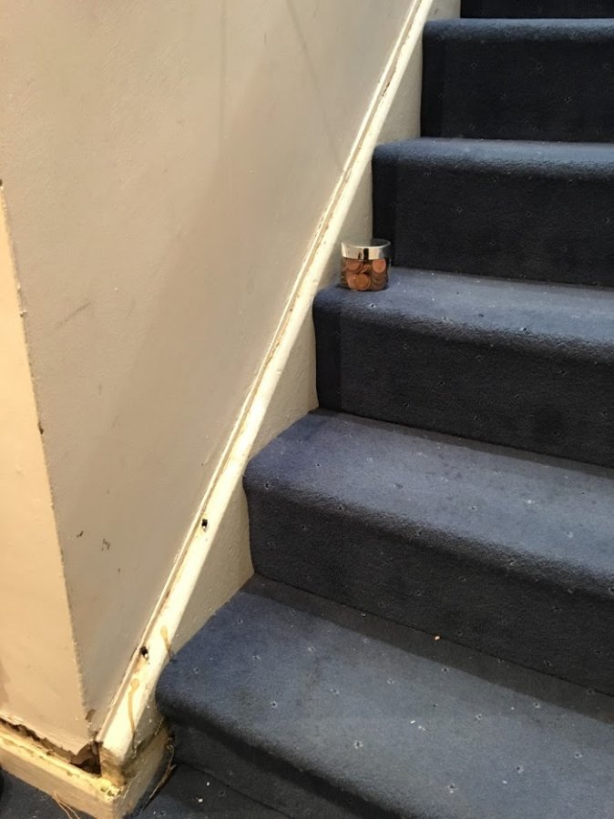

Hi all,
I am in the process of altering the hall stairs and landing, part of which i will be changing all the arch's and skirting but something i have not done for a very long time is stairs, and... when i did i was only laboring for a builder.
Can anyone give me any pointers on this?
I have used 5" MDF Torus everywhere else.
Pics here.
PS. Please ignore the minging decor and crap! new house etc.
not sure off the exact question
but you cannot change direction on 2 planes at once you need a gap between them off a few inches
in other words you cannot change from say 42degrees and level and go round the corner at the same point
Sorry Big-All.
Was in a bit of a rush to get out of the office, Question...
How do i add skirting to the stairs to match the 5" normal skirting, im guessing ill need a deeper skirting for the stairs to look right? then it will be a case of cutting each riser out of the skirting so it fits over each one?
the skirting dosent have to go up the stairs just terminate it onto the string
do exactly what the skirting does now
if its taurus or other shaped just do a return end
a returned end is cut the end at 45% then from the other end cut a bit to fit in the triangle between skirting end and the string
so the shape covers the end and onto the string
I'm confused, are you saying you want the string of your stairs to match your skirting.
Yes Chappers. I am thinking now that adding skirting to the top of the stringer will look very silly.
We just dont like the profile of the Stringer, i guess i could remove the beading that is on it and perhaps add a length of Tours arch to the top of the stinger-fill-sand.
yeah I think on those stairs it might look a bit out of place, it's the sort of thing you would find on grander staircases./
Think you might be setting yourself up for a bit of work there, looks like there is already a chamfered profile to the string
Thanks,
I am not expecting it to be an easy job, it might be a better idea to try and get it back to wood then sand and repaint as it is. just looks a right mess as it is.
ok my suggestion is to take two offcuts formed into a triangle with a flat bit at the bottom for 2 steps then cut at 45% where the 2 bits overlap
i assume you want to add around 2" to the height off the string ??
