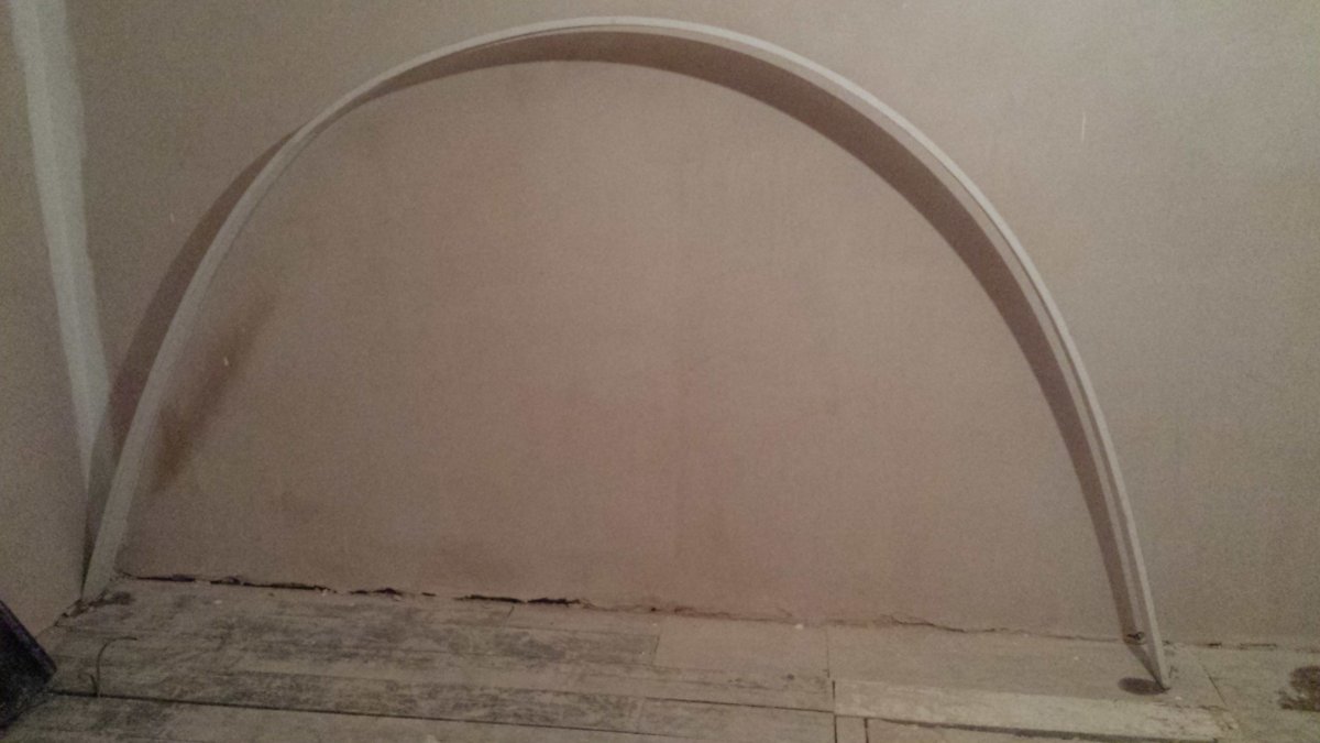

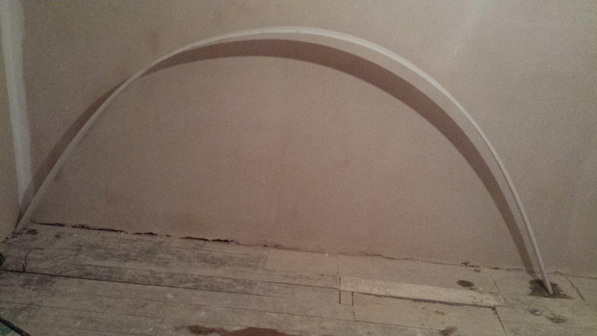

Hello All,

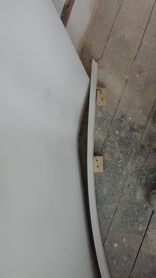

Heres a quick update..... after leaving the brick on the skirting board over night, the result this evening was a slight bend. As soon as i lifted the brick the board pretty much bounced back, not exactly straight again but near enough. I suspect this happened because i hadnt soaked the skirting board and didnt leave the brick for a longer period of time.
Anyways with your advice, tonight I steamed the skirting board with the wallpaper remover and then i put one end of the skirting board against the bottom corner of the wall and the other end i put a couple of screws to create a wedge. I then bent it with medium force to the shape it is now as shown in the picture attached. What do you guys think of how it looks?
Once the skirting board was up i went over with the steamer again on the back of the skirting board. I intend to go over with the steamer a number of times over the next few days so that it moulds into this shape. I fear that if i dont do this the board may spring back straight once i remove the screws.
Question - now that ive managed to create this bend. I think i maybe able to force this bend into the bay window itself and just screw the skirting board to the wall as i go along. I say force because im pretty sure that if i move the skirting board now it wont hold the shape that it is in the picture. Essentially what im trying to ask is can i cut corners and force this skirting board in place or shall i be patient and wait for the skirting board to naturally take this shape and hold its form?
if i do force it in do you think there will be any cons for example ripping out the newly plastered wall due to the pressure of the skirting board trying to stretch straight (hope this makes sense)?
thank again for your inputs.
Will attach a few pics.

To be honest I'm not sure why you're bothering. It looks like you have already managed to bend the skirting beyond the radius of your bay anyway.
Just start fixing at one end bending it in as you go (might need a hand or some temp screws in the floor to hold it). I would fix the whole skirting in over length first then mark off your mitre points, take it off, cut your mitres and then re-fix it. just make sure your screws are long enough to go through into the brick and knock your plugs through the plaster into the brick too.
Steaming with that thing isn't going to do anything anyway.
You can't steam MDF like you can steam timber. What you have there is bent MDF. However, it does look like sufficiently bent MDF.

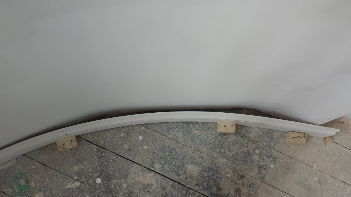

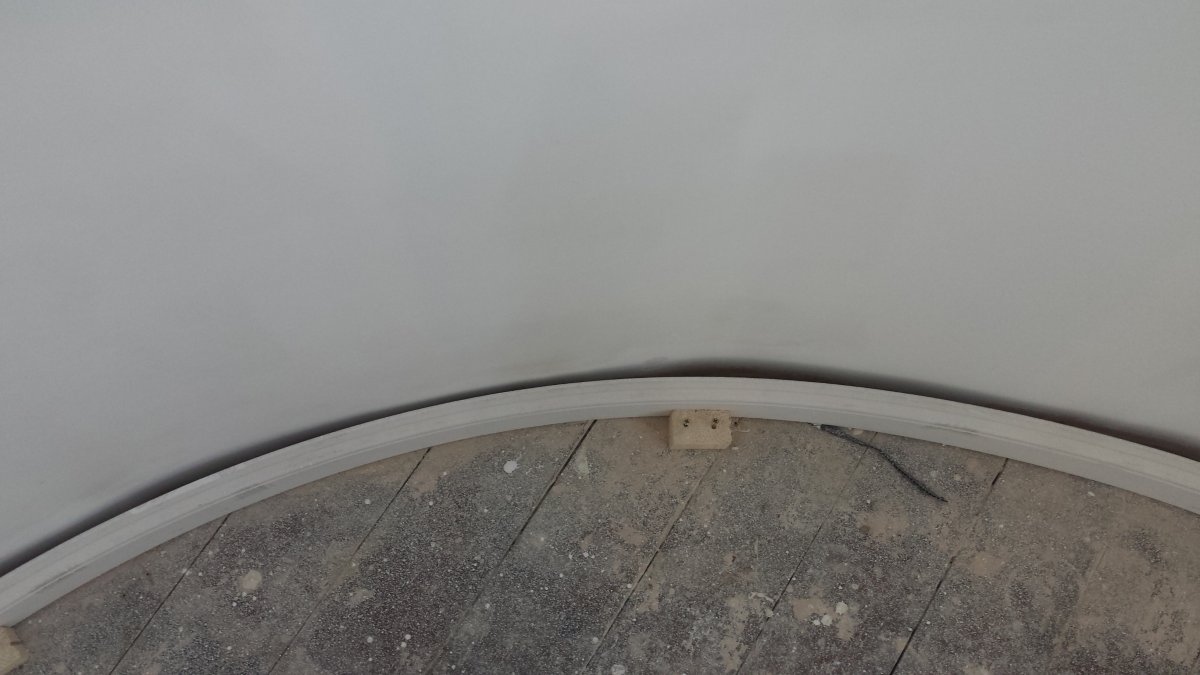

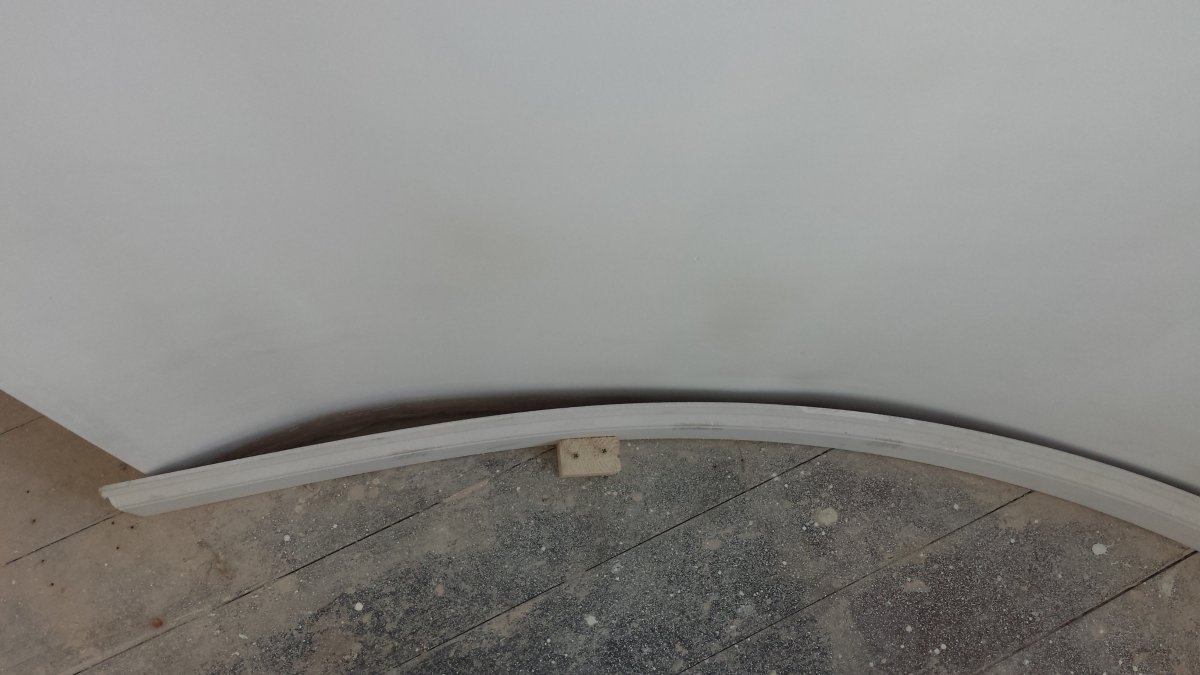

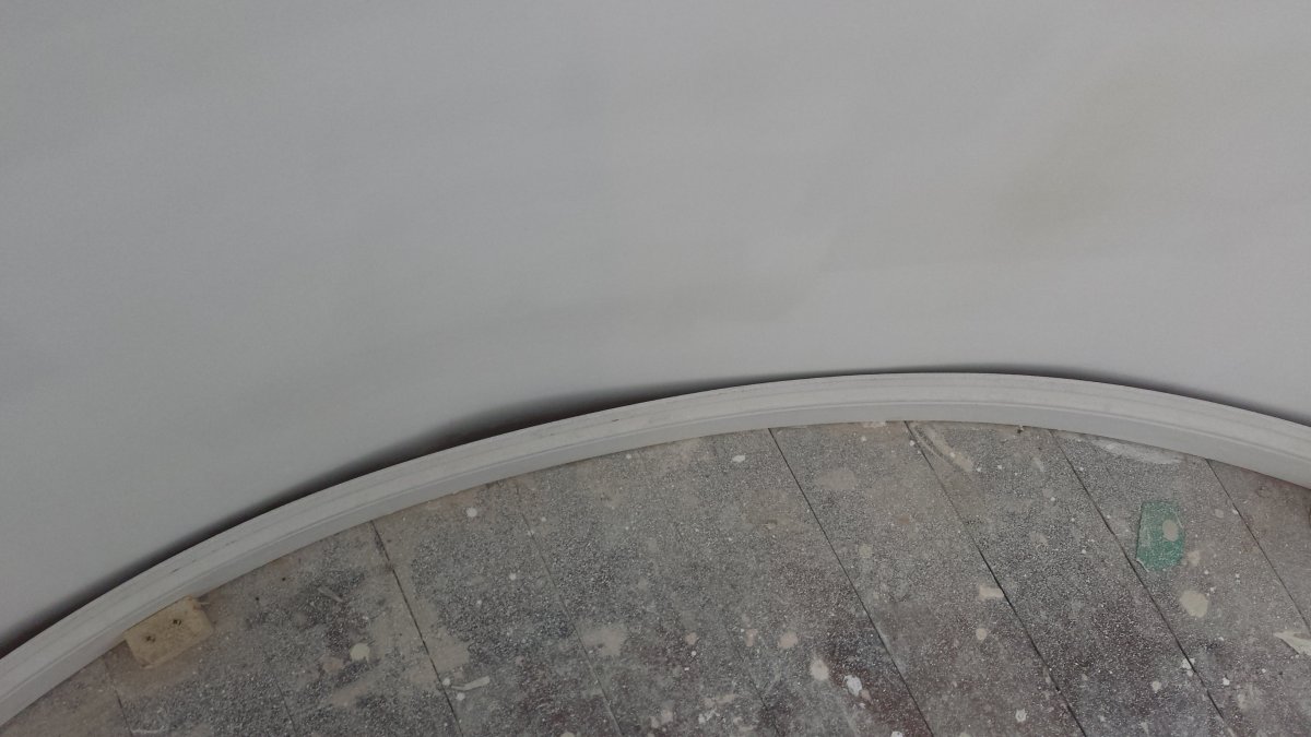

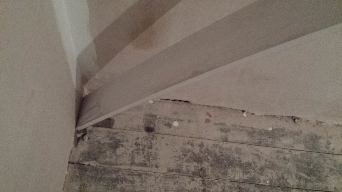

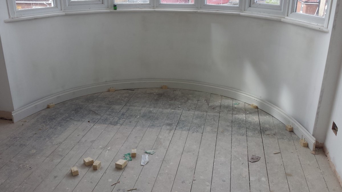

here's a quick update.
The MDF skirting board took its curved shape pretty well. Yeah it did bounce back a bit when i moved it into the bay window but with a bit of force it bent back to the curve shape pretty easily.
HOWEVER .......
As you'll see from the pictures the bay window itself is not perfectly curved resulting in big gaps at certain points at the back. I'm trying to bend the skirting board further with the use of some wood peices but this is proving to be a bit difficult as im trying to bend small sections of the board now.
Any suggestion on where i can go from here?? Im thinking of cutting lines as the front/back at the places where it is sticking out to make it bend in place, but i think it'll be difficult to cut now as the board is bent.
Any help as always appreciated.
