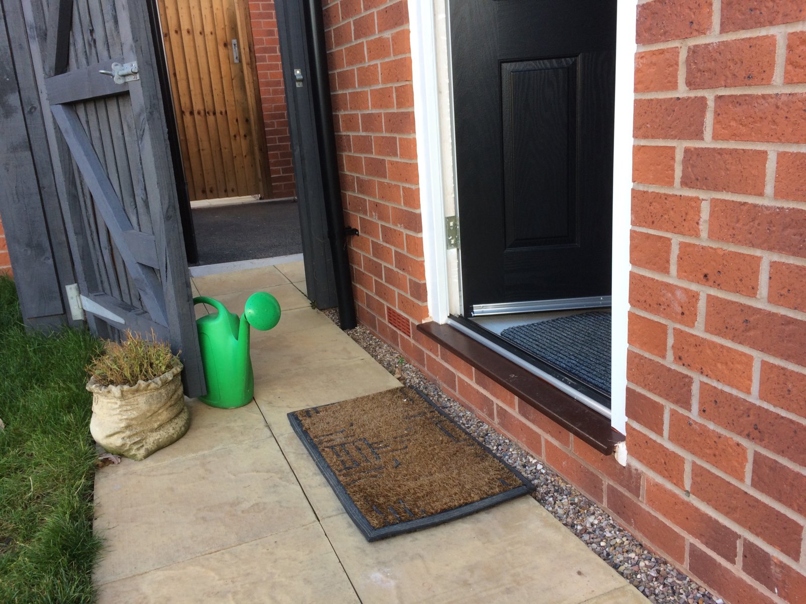

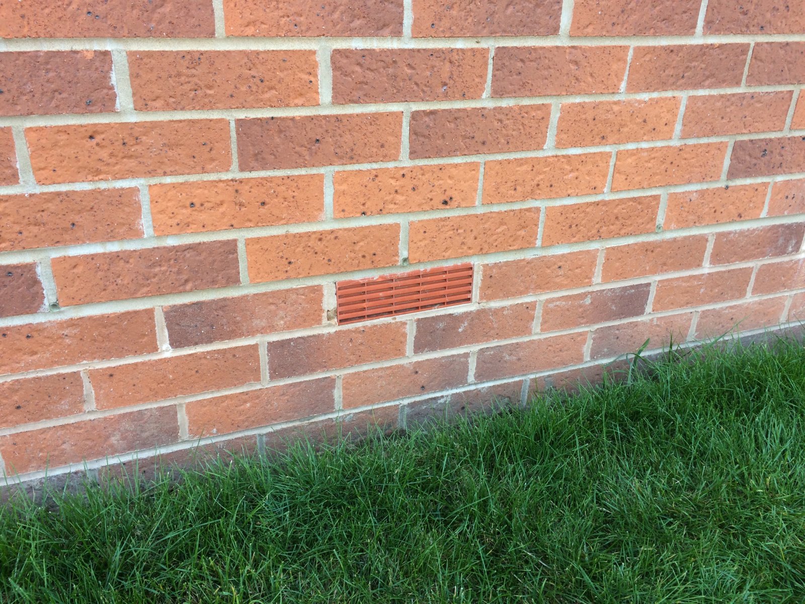

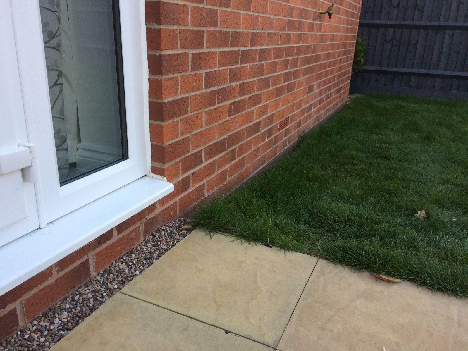

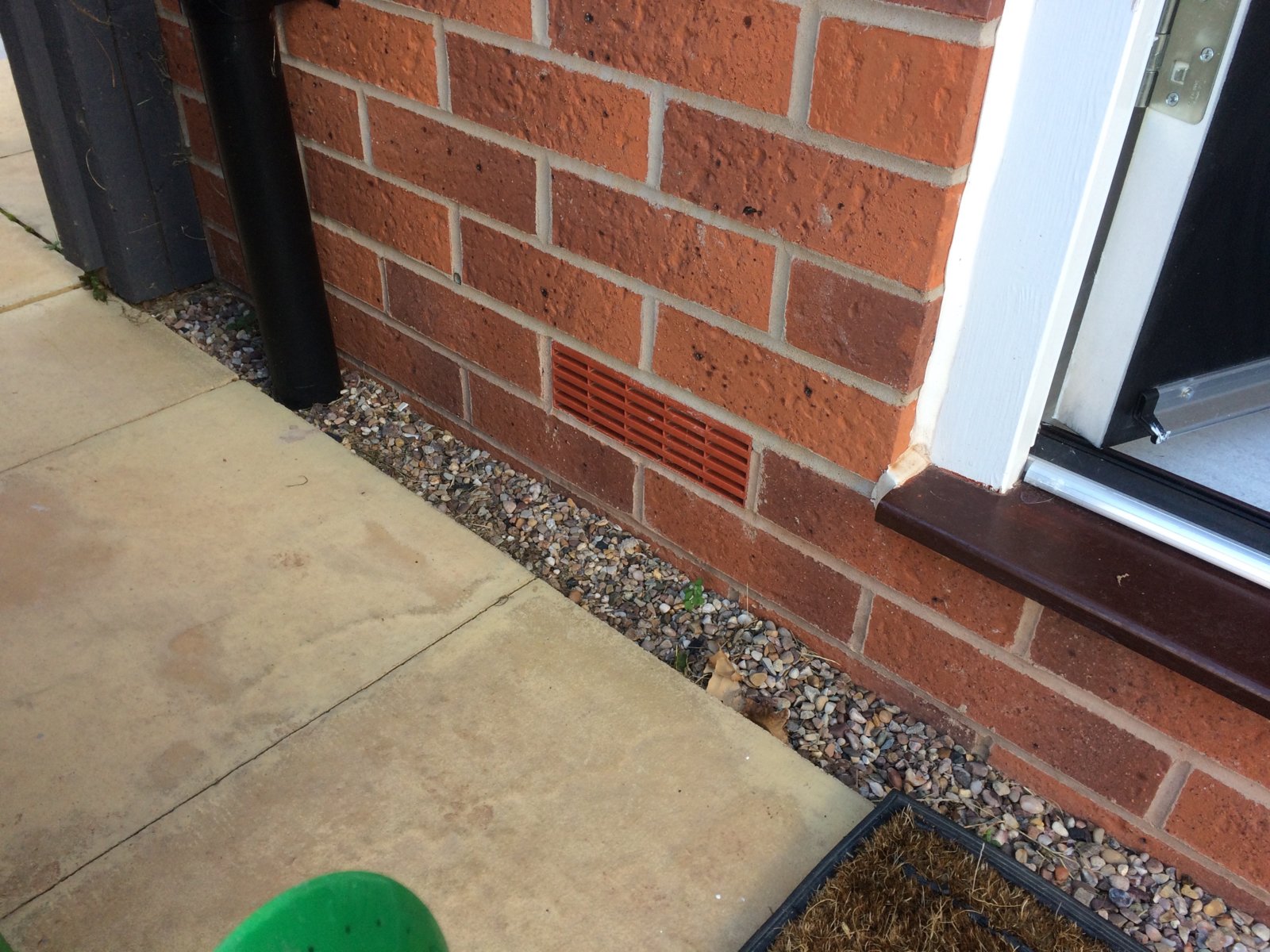

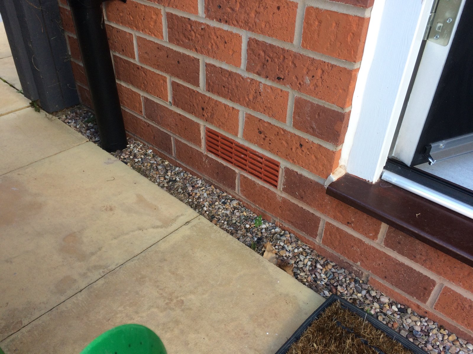

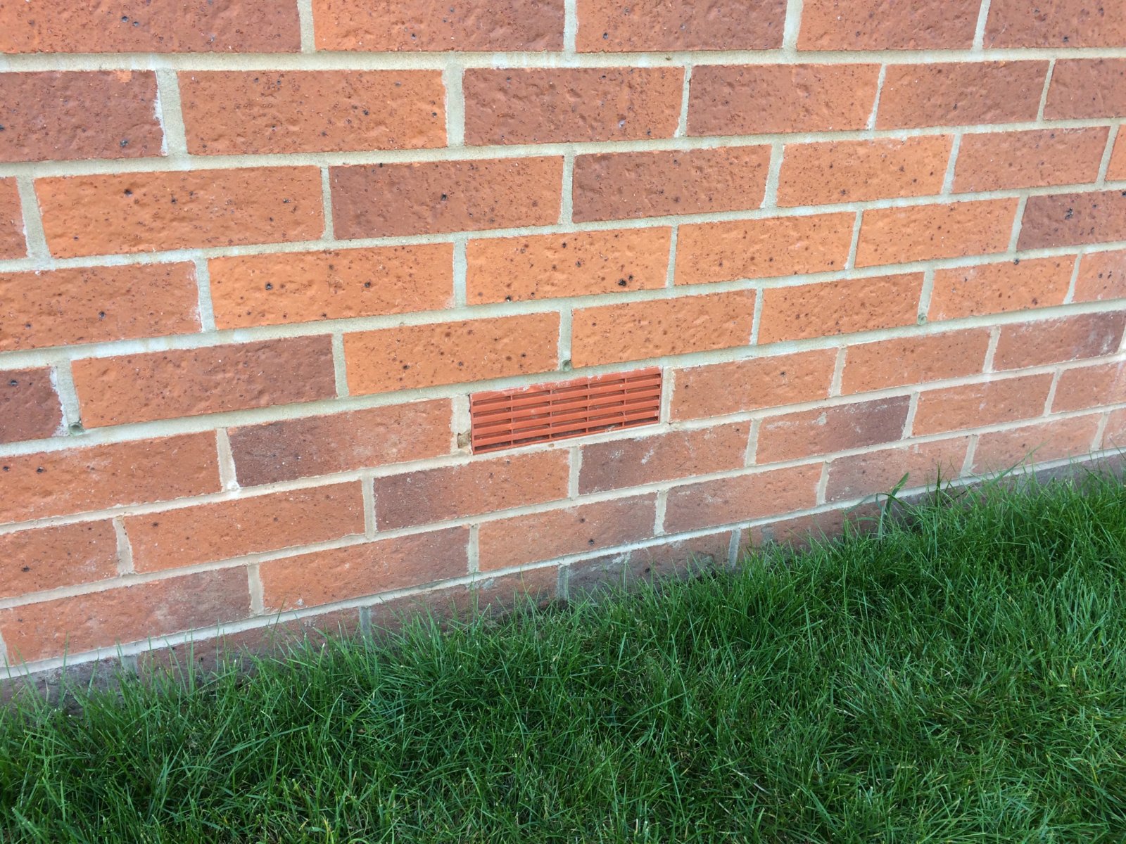

Hi guys,
Wonder if anyone can help. Recently moved into a new build. There are airbricks all around the house, I want to start slabbing the back garden but do not know how far below airbrick I need to go. The builders have left a miss mash of levels. The current cheap slabs are 1 brick below and the grass is 3 bricks below. Can someone advise. I will attach some photos.
Your help is much appreciated.

Lay as per the ones already there,maintaining the gravel strip.
As the lawn level drops away simply follow the level unless you want to have a step down or re- turf?
