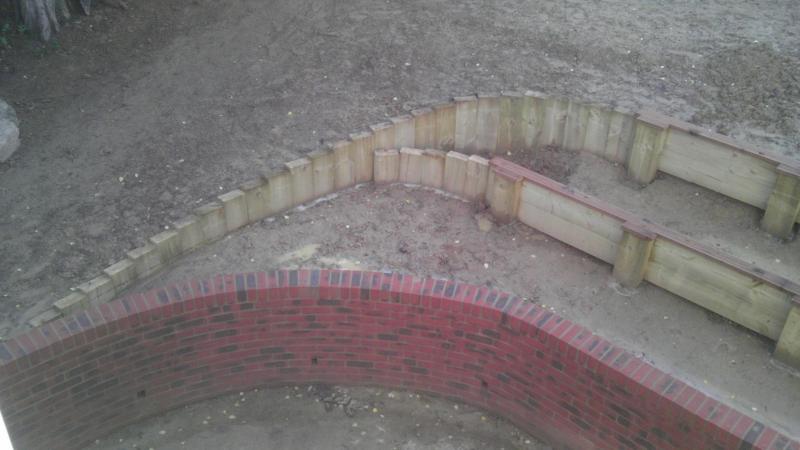

looking to build a 15m sleeper retaining wall about 1m high i will be using 200mm x 100mm 2.4m posts , and joining together 5 to make the 1m up with 1 post every 2.4m sunk in the ground to support them and then bolted together with timberlock screws .
is postcrete strong enough to support the vertical posts ? or does it need actual concrete ?

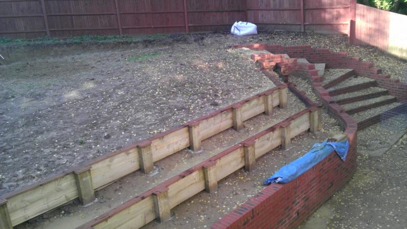

1 post every 2.4m is far too little support.
The other problem is fixing them. If you use 2.4 centres and you stagger the joints you would end up in a situation where a joint falls in no mans land halfway between posts.
Set them at 1.2m intervals assuming your sleepers are 2.4's.
I would use concrete.

this part of the garden is actually stepped, the main bulk of earth is being held back by a 1m concrete block and brick wall 9inch , i am looking to soften the slope up to the grassed area by putting some tiered flower beds in , so the first level would be 60cm and the next 40cm
do you think something like this would be sufficient ?

I staggered mine so they where like large bricks, widest side down and bolted at 600mm Centers. The bottom ones a drilled through in 3 places and used 12mm rebar through the holes 1meter into the ground, I levelled the bottom ones by sitting them on a very dry concrete mix.
At the back i filled the gap with some gravel to allow water to pass through.
Hope this helps
just updating with pics
43 sleepers later , :P

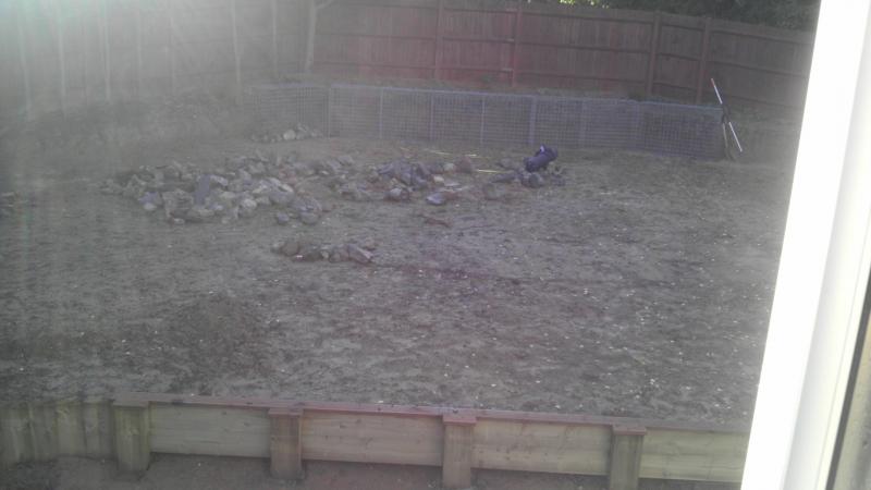

now another 20 sleepers and 8 tonnes of rock to fill some gabions now at the back of the garden :wink:
anyone know a cheap supplier of gabion rock in the surrey area ?

already there too late :P the horizontal ones will not rot dpm sealed behind them
verticals might need to be replaced though eventually , no big deal stagger the replacements in turn and it should be alright.
the main structure is a 9" thick brick and concrete block wall that has just been built
i might use concrete repair spurs hidden at the back of the next sleeper wall
