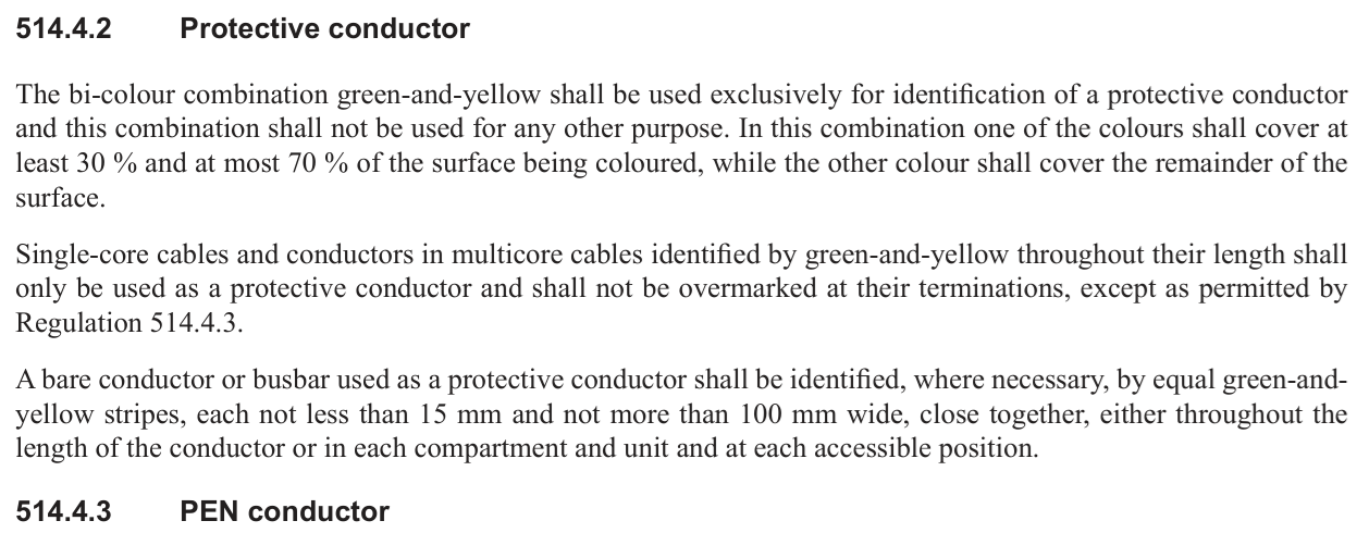

Apologies, can of worms again. What are the latest rules about oversleeving green/yellow?
The last I knew it was stated as permitted in multicore cables but I was out earlier on a C2 EICR in a wall T stat.
514.4.2
Not permitted unless for a PEN conductor, which it won't be in any normal circuit wiring.

I would never use a G/Y cable for anything other than it's intended purpose.
No matter what anyone else says, bodging it with an oversleeve or a bit of tape is just not right.
Do it right first time, if your short of cores then get another cable.

... and you would undoubtedly be right, but not just photocells - also timer fans, PIRs, wall stats and various other things. Quite common, but never very 'nice' and no longer even 'allowed' by BS7671
Would use 4 core these days and not use the earth, strange ay
It is a little ironic, but the 'earth' often will be needed (to comply with BS7671), even if it's supplying something Class II. Were not the case, the ideal would be for cables to come with one of the cores a 'neutral' colour (e.g. white), so that it could be sleeved G/Y when a CPC was needed, but sleeved brown or blue if no CPC were needed but a S/L was!

Well I suppose that strictly according to the big book a device permanently connected to the installation should contain an earth wire as the only listed exception to the rule is a bulb holder. However if the PIR were to be connected using a plug/socket arrangement it would negate the exclusion.
The requirement in BS7671 applies to "points and acessories", the definition of accessory explicitly excludes current using equipment.
So we come down to the definition of "point". IIRC a point is defined as something like "a termination of the fixed-wiring intended for connecting equipment" or some such.
If a device is connected directly to fixed wiring, then the input connections of that device clearly form a "point". If the device comes with a non-replacable cord that is terminated in an outlet box then the outlet box is clearly the "point".
The slightly fuzzier question is if the current using equipment is connected to an outlet box by a field-fitted cord. I would argue that if the cord is short and not fixed to the building (other than by being clamped where it enters the equipment and the outlet boxx) then the "point" is still the outlet box, but others may argue the opposite.
