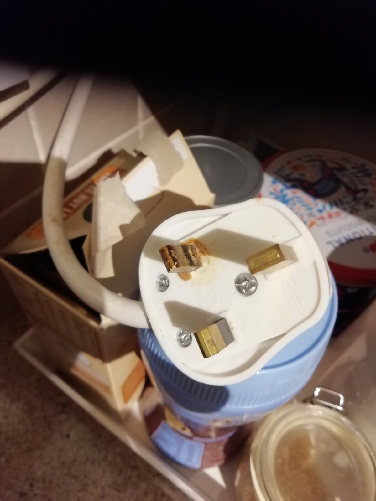

A socket in my kitchen which permanently hosts washine machine / dishwasher extension is slightly burned. It happens to be neutral on plug and neural socket.
Obviously I am going to replace both soon. However curious to know what could have caused this. Originally I thought it was rust and general condensation of a kitchen. But actually it smells a bit burnt.

It may be overheating due to a loose neutral wire in the socket and/or a faulty extension lead.

Thank you. When I open it up tomorrow I'll see if there's a loose connection. I've attached some photos, to show my use if word *slightly* burnt. If I could get away without replacing the front of socket that woukd be great. Don't judge me... The reason for my apparent laziness is that I find 2.5 core cables awkward to manipulate anyway. Now that I am older with a bit of arthritis I enjoy changing a socket even less. And a new one may have locations of L N E in slightly different places thus meaning a bit more bending of cables. The appliances have never 'flickered'. It's easy for me to change the plug pin, but if you thinj the socket is not that bad let me know. Please don't tell me off though for thinking of not changing, as I am not lazy or tight. Thanks.
There is no question about it. Both the socket and the plug must be renewed, and, if it is found that the cables to the socket are showing signs of having overheated, they should be re-terminated, as should the flexible cable to the plug.

Feel free to ignore me as I've just realised from opening the plug that that hole is L not N (I thought I had already reversed image of plug in my mind but clearly not).
So that make me look like an idiot.
I will definitely be replacing plug. As for socket, had a quick peek. Everything still nice and tight (when I fit a socket (in this case about 12 yrs ago) I am a bit OCD with twisting together and tightness for the very reason, I don't want to repeat job). I do understand that's no guarantee against loosening
It doesn't really matter whether it's L or N. The plug and socket still need replacing. And by the way, we don't twist the wires these days, as it make future testing harder.

You mean you are running both on a single extension lead (at the same time)? In which case you are severely overloading the plug, socket and extension lead.
It is inadvisable to use an extension lead on even single high power devices like those. It is also inadvisable to plug two such high power devices into a double socket. Double sockets are generally rated at 20A not 26A as people often assume.

Dirty plug sockets, pins are common enough and stink under high load.
If i had to replace every plug and socket in my house that suffered from this I'd be a poor man lol.
I have replaced burnt sockets and removed high load of them but this was a builders special contract socket and Chinese plugs.
