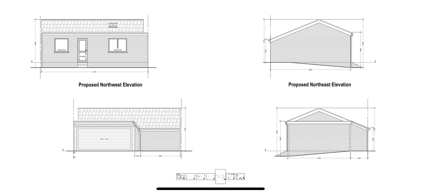

I have a 23 degree pitch roof. One side of the roof is 3m long and the other side is 4.5m long. These join together at an angle. Is there any guttering I can use on the angled part? The straight runs of 3m and 4.5m can of course use normal guttering, but the angled part is also pitched and I can’t find a gutter bend which is both angled and pitched.

Why the acute (crappy) angle and not (the taller roof) brought along so it's square and not sloped? Was your designer pizzed?
This was done to maximise the space inside. It follows the land border line, so making it square would mean squaring it off with the longer end.
Adjustable gutter unions only allow you to adjust the angle. I would need an adjustment for pitch too, as the straight run needs to join onto the 23 degree pitch run.
Those drawings are baffling. They look like an impossible flat/pitched roof Escher drawing.
That's a poxy design where no thought has been given to building it or what it looks like.

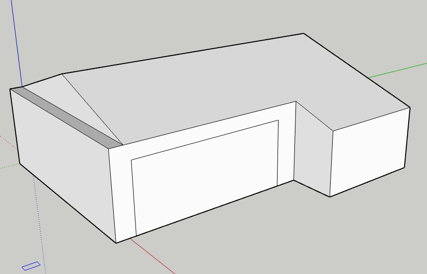

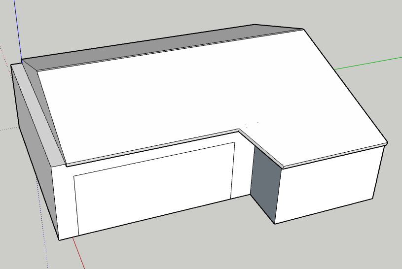

The roof and wall joining the short roof above the garage door and the long roof next to the garage door are connected at an angle. I have drawn a red line showing the rough angle.

The wall also follows this line, it was done to maximise space inside. The wall has already been built, the roof is still being done.
So my second image is correct. Hmm what a pickle, should've thought about the gutter beforehand, precisely because of this.

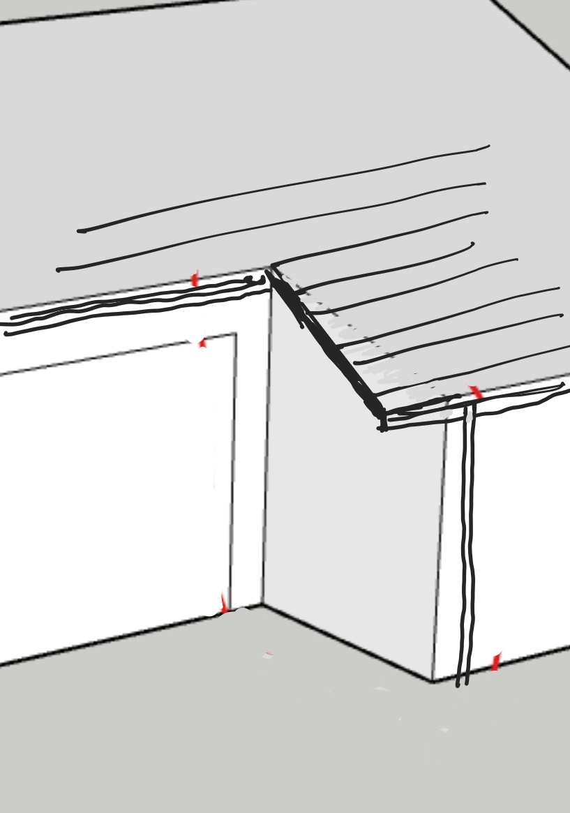

Personally I would run the long gutter down to a downspout at the LHS of or around the corner of the garage door with a stop end on both ends.
Run the shorter gutter to a running outlet and downspout again at or around the corner of the sloping wall.
Then on the sloping part fit a gutter with end cap at the top underneath the long one and a running outlet half way down feeding into the same downspout as the short one to take part of the flow away and prevent overflow at the bottom, and the open end feeding into the top of the shorter front gutter.
