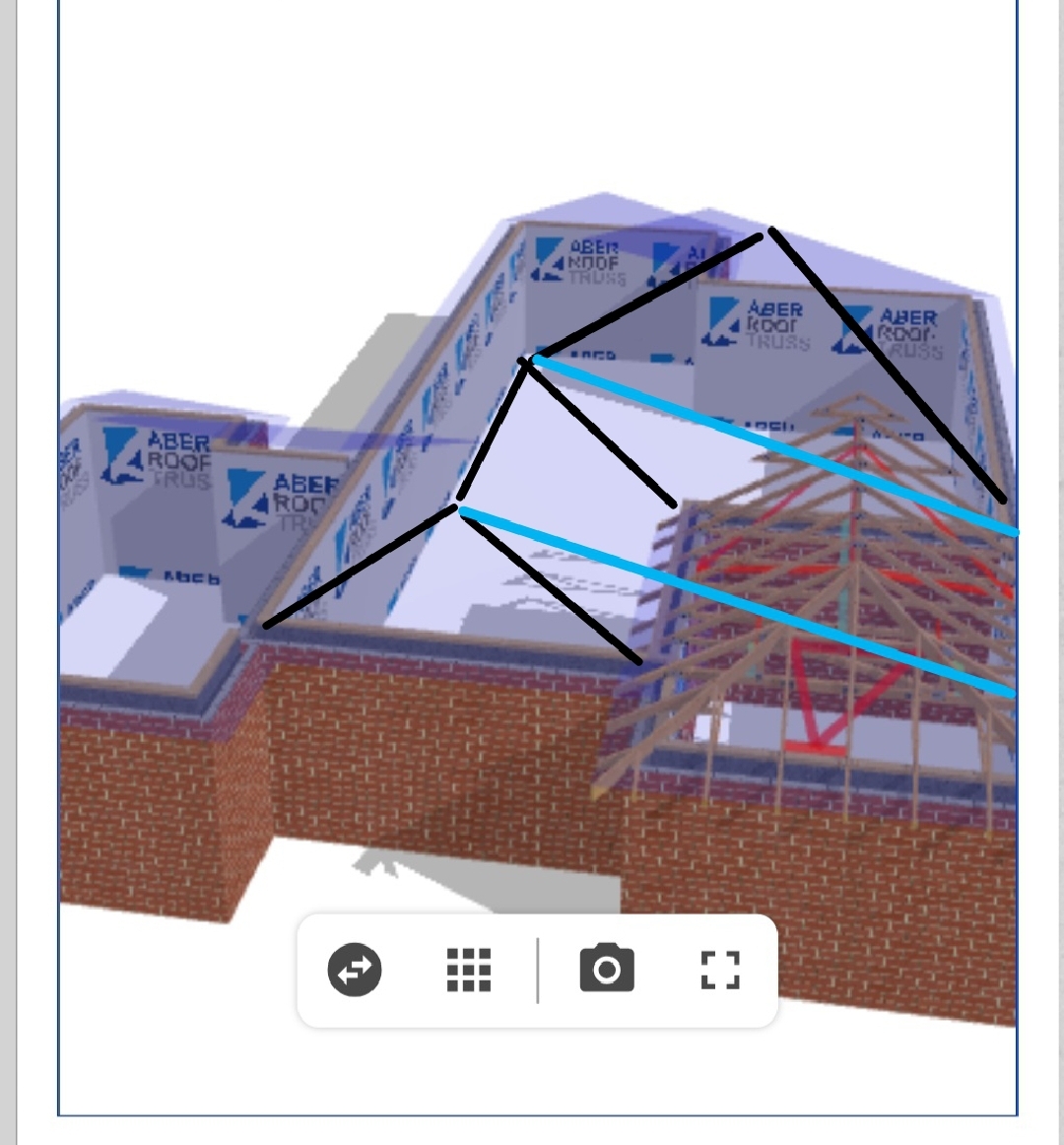

Box Gutters... good or bad idea?
I'd prefer a flat roof to that.
Will you be up on your ladder every six months when you're 93?
These are valleys...
This is absolutely no problem, as a leaf or dead bird landing anywhere on that lot will get flushed away by the rain.
I don't know what the name is for what you're proposing. I'd suggest "potential disaster". Anything falling into it will sit there, indefinitely.
I've seen it done though, but it always looks weird, and is definitely risky.
Thanks for the feedback.
My builder says he has done it before. The valley gutter starts off wider at the back of the roof and then narrows towards a hopper where the gutter is. He steps the gutter structure down for using lead. He said I'd actually be able to walk in the valley gutter as it would be wide enough and any crap would be flushed out by rain owing to the fall. This is a bungalow as well so no really dangerous scaling of heights. I could drag any leaves out with a brush or some such from a step ladder a few times a year.
My house already has four or five valleys on it as it is a hipped roof with different out riggers coming off it. Not had any problems with them, although they are normal roof valleys, some with GRP closed valley style and some with traditional open ones with lead and mortar. This proposed one would of course be different.
The flat roofed extension looks ugly and the trouble with keeping a flat roof (which was done badly two years ago by a bad excuse for a roofer) is that it will cost just as much to recover it by a competent person as it will cost for my builder to just put a hipped roof on it. Truss system will be £650, plus roofing felt, tiles, guttering, labour... probably will come in at no more than £5K.
Since noseall says this isn't a box gutter, I gather we can say it is a type of valley gutter that is more shallow than usual, requiring different design features.

No. Box gutters are distinct.
Not sure I agree but feel free to explain in some more; to me a box gutter is a gutter between two parallel features of a roof such as two roof slopes as here or a roof slope and a parapet wall. A valley gutter is a gutter between two non parallel roof features such as in Ivor's picture where perpendicular slopes meet

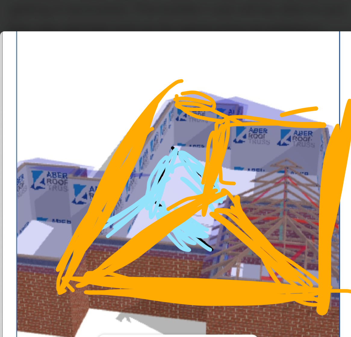

In the OP's original proposal he seeks a box gutter. In the "orange triangle representing pitched roof" above (my picture) there are two valley gutters.
What's your definition?
I can't imagine how that sloped infill could work in reality. It would require a section of roof with a really low gradient, as the back of the box/gutter thing already has a pitched roof beyond its inner end.
I'd just chuck a rubber sheet over the flat roof and call it done, definitely wouldn't cost £5k, you're being given a sales pitch about it costing the same. The stuff seems to last pretty well these days, it's synthetic rubber so doesn't degrade. The same stuff that car window seals have been made from for about 30 years - if you remember the old days, they used to turn crusty and cracked but don't any more.
Any water path that narrows is likely to block, as things get stuck. I guess the theory is that the flow rate will increase, but it also means that things that can fit into the top won't be able to get out of the bottom.

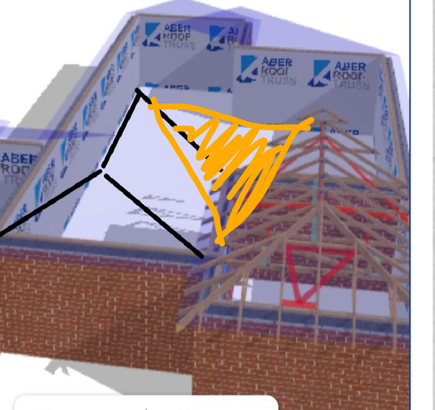

I like this idea a lot. So your block of red Leicester would create two valley troughs - the left hand one replacing an existing one so I'm no worse off there. It removes the "box gutter" problem and all the complexity and potential maintenance issues of that. The only part I'm not sure about is how the top part of your infill ties in with the big hip roof behind it. Would that need to be a valley as well, albeit a fairly flat one? I guess the Box gutter is transferred to that part in effect, albeit could presumably be done much more like a normal valley trough, ensuring enough fall.

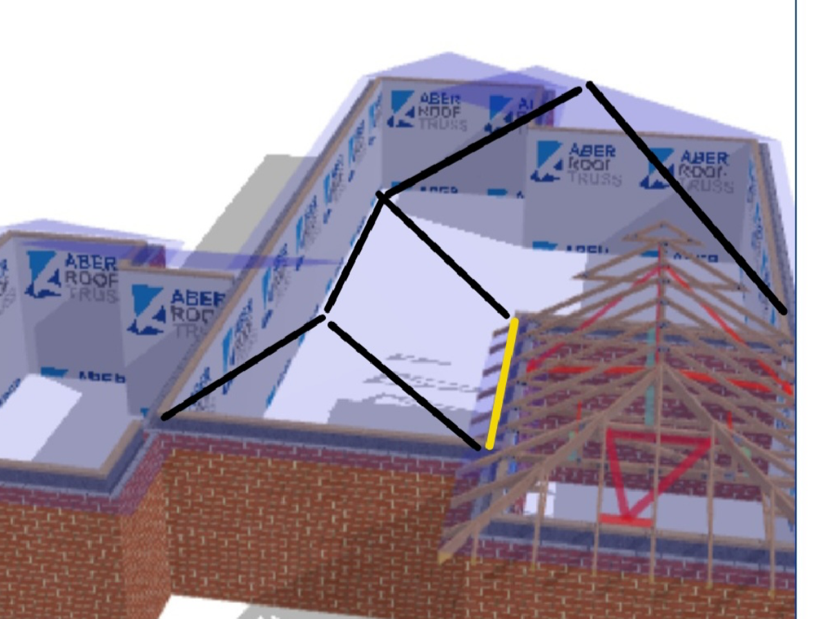

The run would be about 3m overall so not too many steps... why exactly are steps needed? Wouldn't a slope be better, even a shallower one?
If the underneath of the valley or box bottom has a gap under it to the roof insulation then I suppose it would benefit from the general ventilation in the roof space - soffit vents and whatever roof felt vents I put in to encourage air flow.
The black lines of roof from the OP seem approximately square, which would result in the angle of the orange infill having some similar gradient to the black outlined slope..?
I had n mind that it was running up to a gable wall.. is that not what is meant by the higher peak of black lines here? :
(Are you saying that all your black lines are either hips, ridges or valleys? None are verges?)
Maybe just go the whole hog and square the roof off, get rid of all the valleys, create a covered area to house the barbecue etc

Yes that's right. The roofs are all hipped and the one your orange infill went against at its back is a big pyramid.
Yes, that big roof would do it and neighbouring houses were built that way originally... but it would require far more materials, labour and planning permission. Plus there would end up being a box gutter on the left hand part at the back where an extension has just been built, also with a hipped roof. Although that could be solved by having the big roof stop short of the covered area and then having a hip come forward on the right hand extension.
How about some kind of mono pitch across the flat roofed extension, beginning at the ridge of the existing left hand hip? Front area then needs dealing with... I think it could look weird and there would be an awkward gable infill with the left hand hip.
Planning is an obstacle, but I wouldn't necessarily agree on the "far more" jump. So long as agreed parameters such as overall height aren't being exceeded and other houses on the street have similar shapes as proposed it probably wouldn't have any material considerations and could be permitted via an NMA .
Valleys take more time than hips, and more planes take more time overall, so I don't think the difference would be as great as you anticipate. Materials tend to be a lower proportion of the cost of roofing jobs than other aspects and the simpler the roof can be made the faster it goes on and easier it is to maintain/keep trouble free
Lot of factors to consider and I think any builder would tell you that simpler shapes in roofing would be preferable
Honestly, it's so much more faff than just roofing over, but your money/aesthetic/choice!
It can all be done, but where two planes at different angles intersect, you have a valley, and it's more complex and more maintenance than a hip or gable
