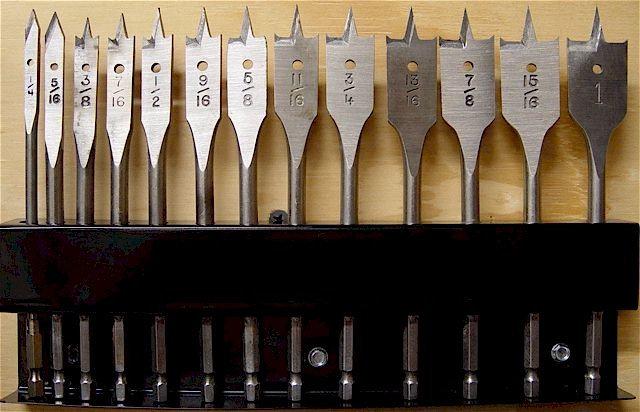

The HSS bits will always last better than a carbon steel auger bit......maybe a 6mm flat bit will do the job? At least they are easy enough to hand sharpen with a file.
John :)

I always used speed bits, which can be fitted with a long leg and they can be sharpened...pinenot :)
I don't think I've ever seen those in 6mm, or possibly (probably) I'm thinking of the wrong thing; are they the tri-flute jobs?
Cheers
Kev
They're 6mm (or quarter inch?) shank aren't they? (ETA Speed bits not tri-flute) Certainly handy for fast holes in softwood, and have the advantage that if you need an odd sized drill for something they can be ground (or filed) to suit, you can also grind the point back, and shape the cutters for use in the pillar drill to give a flat bottomed hole if you need it.
I've got a quarter inch spade bit I made from a length of 3 or 4mm (I can't be bothered to go and look :)) silver steel forged flat on the last 20mm or so, ground to shape, and then hardened and tempered. Works fine but you have to watch that it doesn't "whip"
