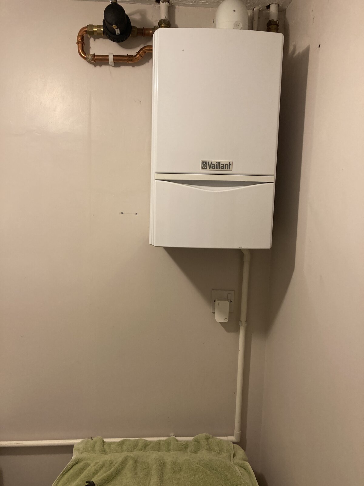

Is the PRV pipework the white plastic pipe that runs from the bottom of our boiler? It runs internally to the washing machine drain (utility room). I can't see any obvious signs but will monitor that more closely if that's the right pipe. I know the plumber installed some kind of additional pressure relief valve in the loft with the new hot water cylinder. I have checked all of that pipework and it is all dry.
The white pipe is the condensate drain ,and water will trickle from / through it when the boiler is burning gas.
The pressure relief valve in the loft is more likely linked to the unvented cylinder.
Show us some pics of pipework below the boiler or tell us the make and model.
How old is the boiler....???
Valiant Ecotec plus 428- around 15 years old I believe.

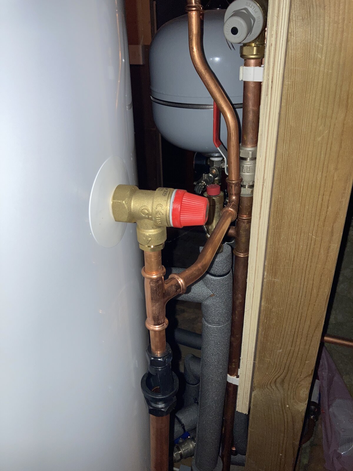

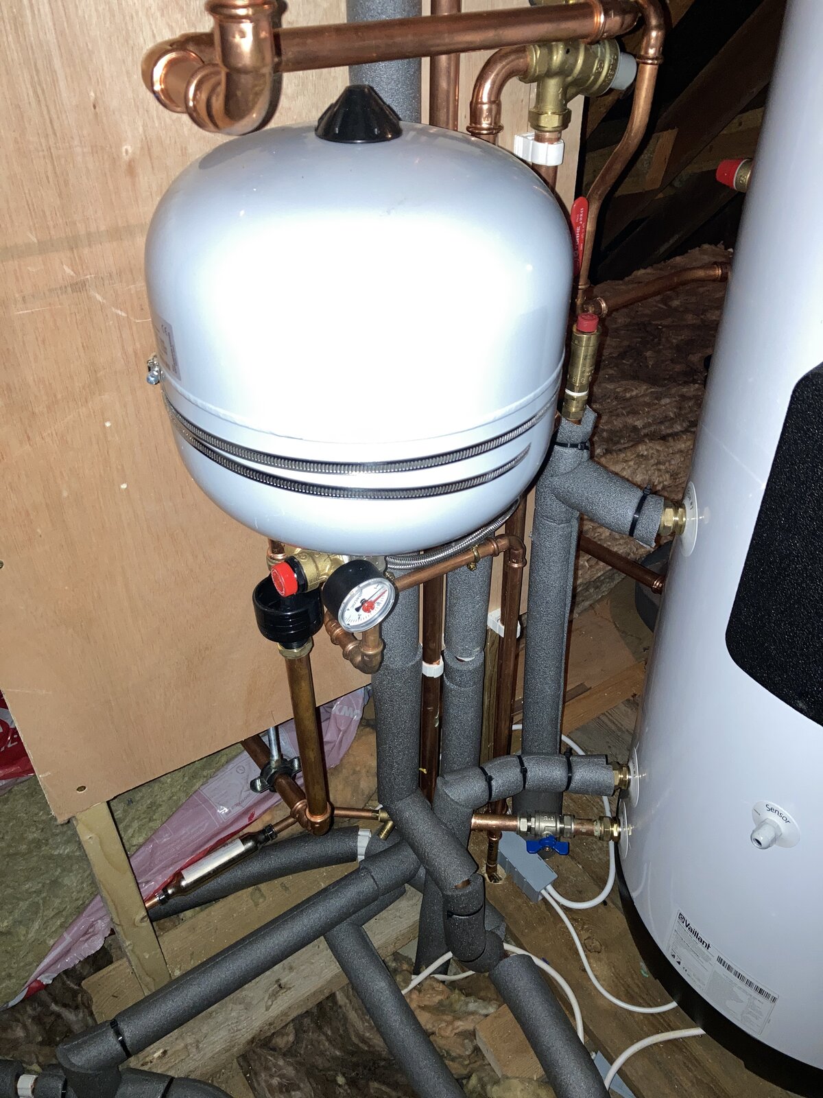

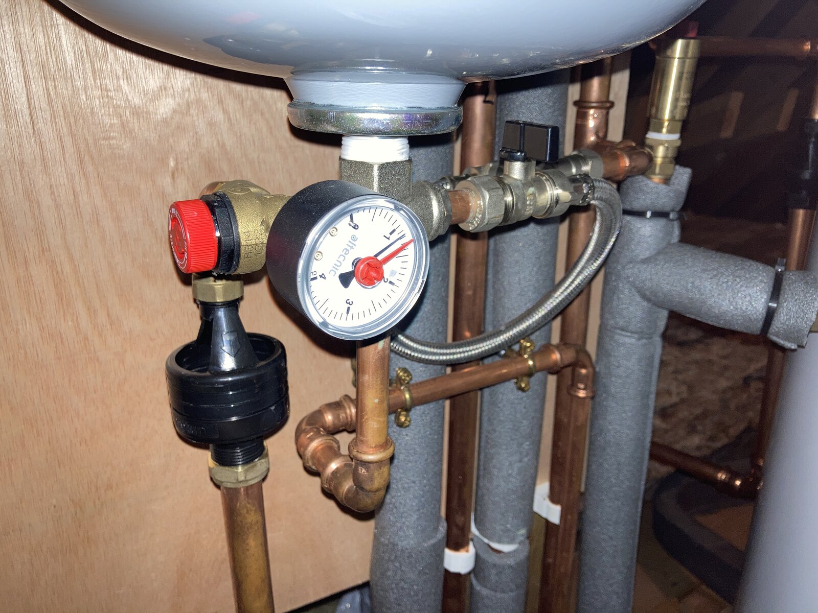

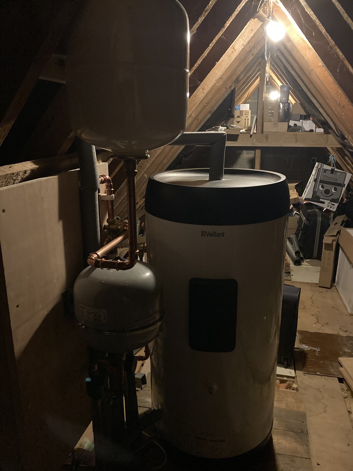

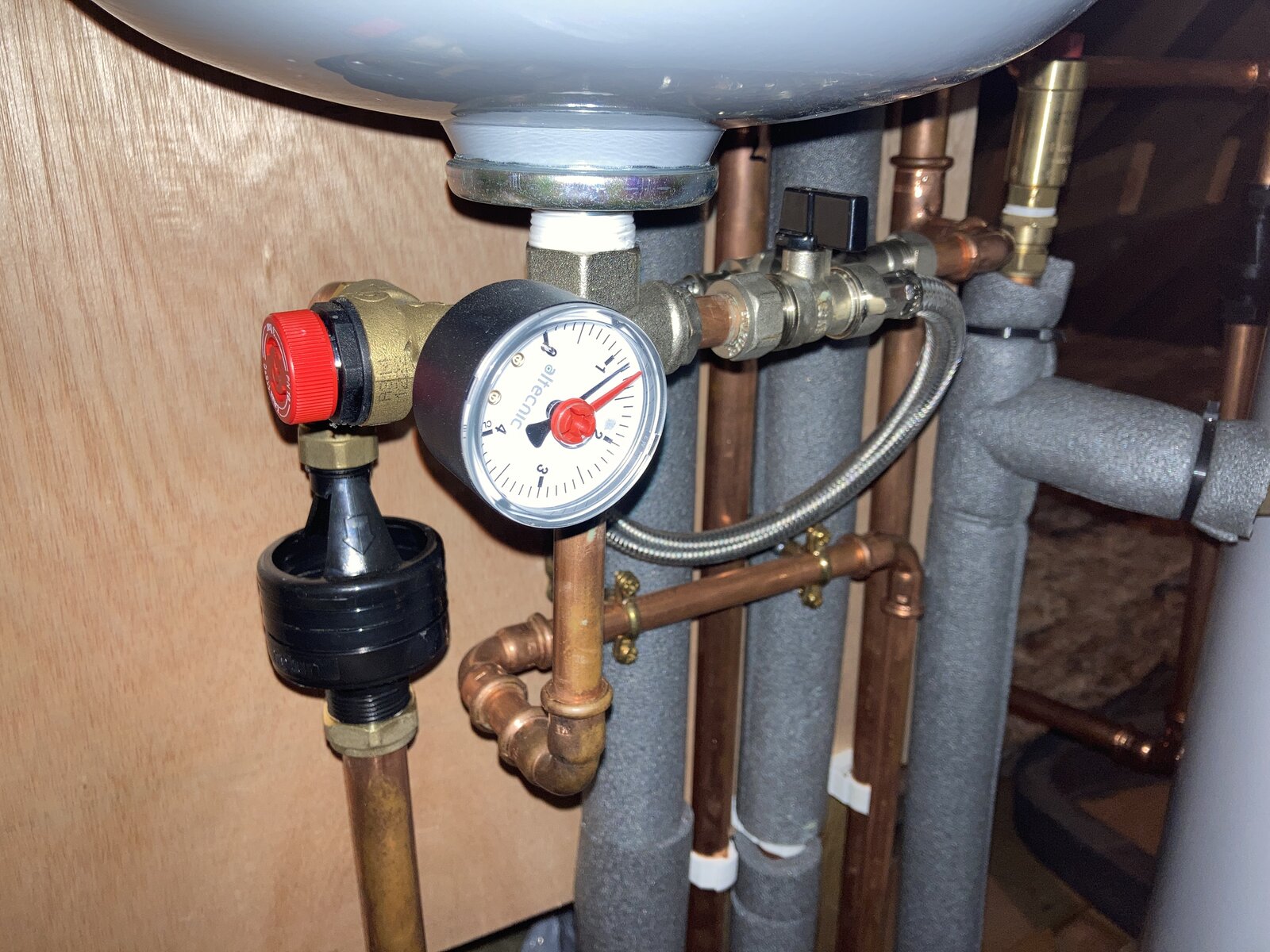

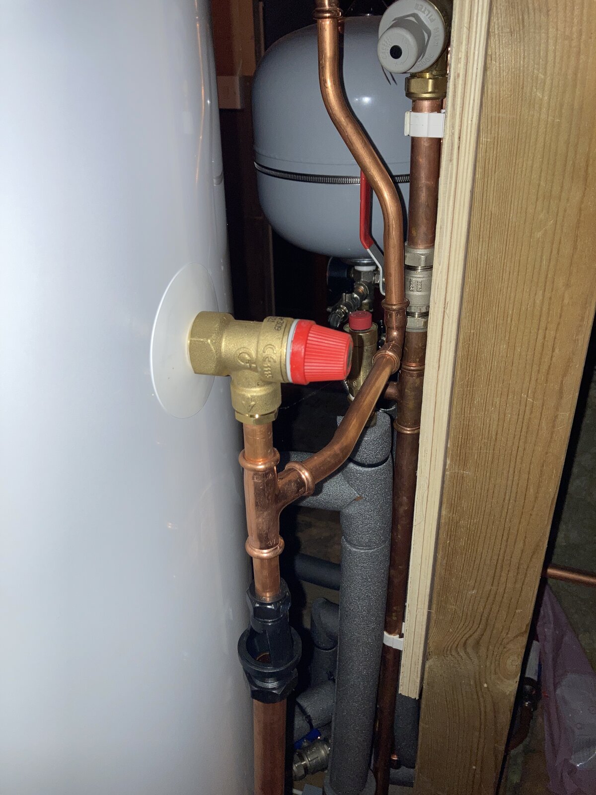

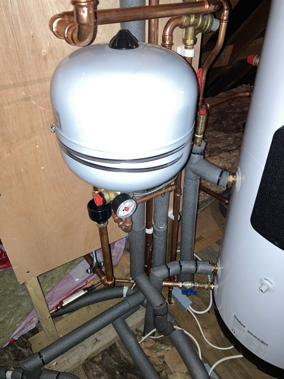

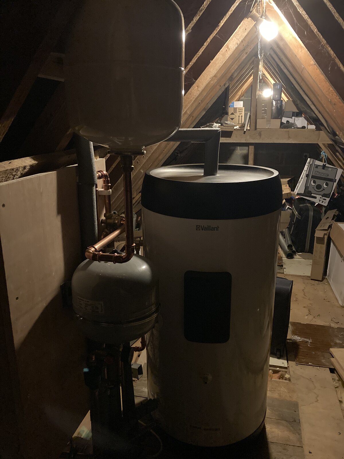

Here's some photos. I've included some of the cylinder and what I assume is the pressure relief valve by the side of the pressure gauge.

You are correct ,the PRV is to the left of the pressure gauge. The copper pipe below the tundish should go out externally ,and be visible outside. If there are no signs of water dripping at the tundish then the PRV can be ruled out.
That leaves a leak on the system ,or a pin hole leak in the heat exchanger of the 15 year old boiler.
Yes the pipe goes out externally. The turndish is bone dry.
I am guessing if there was a leak in the heat exchanger it would be visible underneath? No signs of any leaks there...we do have it serviced annually as well so would hope that they would have found an issue.
Thanks very much for your help. Assisted in understanding my system a bit better and ruling out some possibilities. Guessing it might be into the realms of specialist leak detection, or looking at an additive to the CH system albeit latter feels like a bit of a bodge or destined to fail a bit further down the line even if it does fix it?
If the heat exchanger is pin holed ,water will trickle out the white pipe when the boiler is NOT operating. It will not be leaking under the boiler ,and may not be obviously apparent if the white pipe is sealed into waste pipework.
Adding leak sealing chemicals is not something I would advise ,and specialist leak detection company's are expensive and often not successful.
