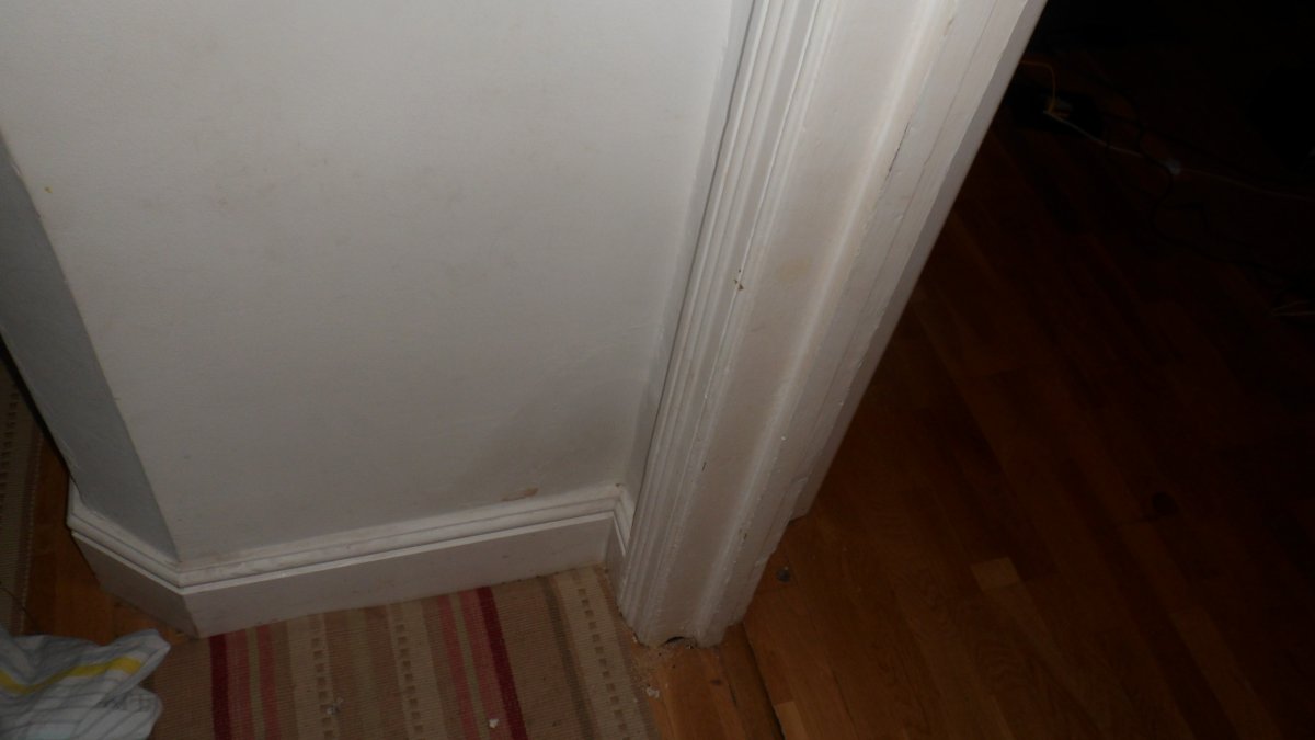

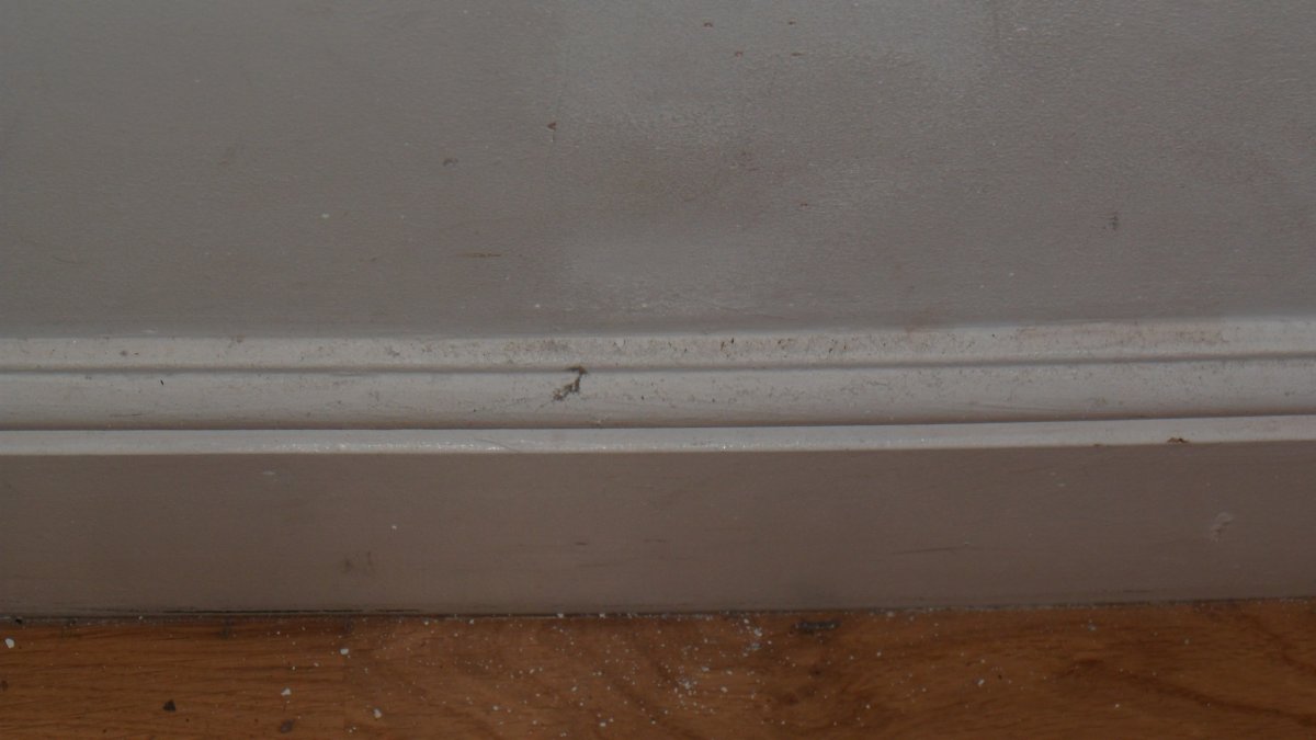

Small damp patch on party wall
27 Feb 2011
89
Berwickshire
I have a small damp patch on the party wall about 50 cm in height form the floor and about 10cm in width. its a Victorian house which i purchase one year ago. i also notice the first panel of laminate flooring nearest to the wall is darker. Any ideas what could be coursing this?

Go under the floor (if its possible) and crawl over to inspect below the joists.
Is there or was there a chimney breast on that wall or on the neighbour's opposite side?
Have you had any other issues with damp or condensation?
When was the laminate laid? The skirting looks relatively new?
FWIW: use mm's not cm's.

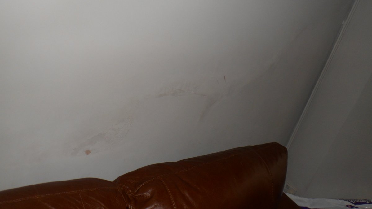

Its the hallway so no chimney, it a solid floor so no joist or crawl space, i have have another damp spot in the hallway and two more in the living room. The floor covering came with the house

Picture of the two damp patches in living room

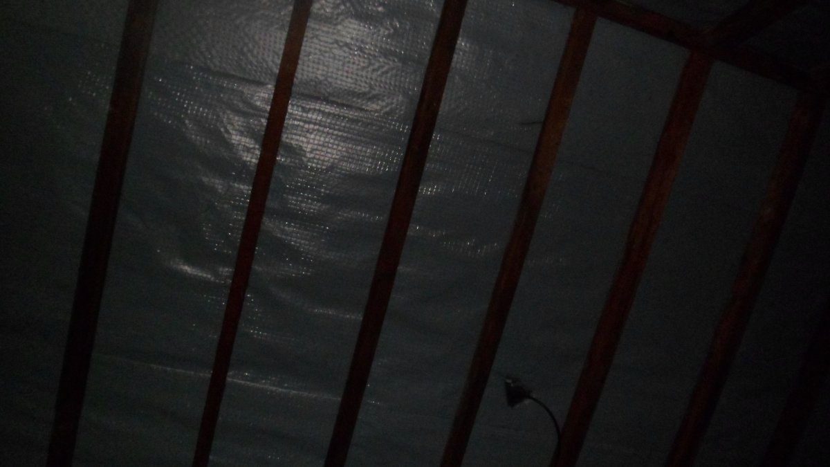

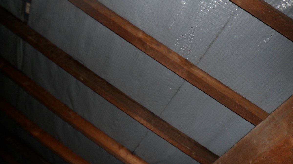

He also stated that the roof is modern with breathable membrane but the builder i had around told me its not.
The membrane the roof has is black and gray back plastic sheet one side black and other side gray with little square is this a breathable membrane?
The couch appears to be close to a chimney breast - can you show a pic of the wall with the couch pulled away, & a pic of the face of the c/breast?
The skirting boards are modern which makes me wonder if previous remedial work has taken place - did the previous owner own the property for long?
Knock on the bay walls (or any suspect walls) and a hollow sound will indicate dry-lining. Dry-lining is often used to cover up damp signs on walls.
A pic of the roof membrane might help to identify it?

Here are a few pictures of the roof membrane.
The surveyor has stated the roof has a proprietary plastic membrane.
is he right?

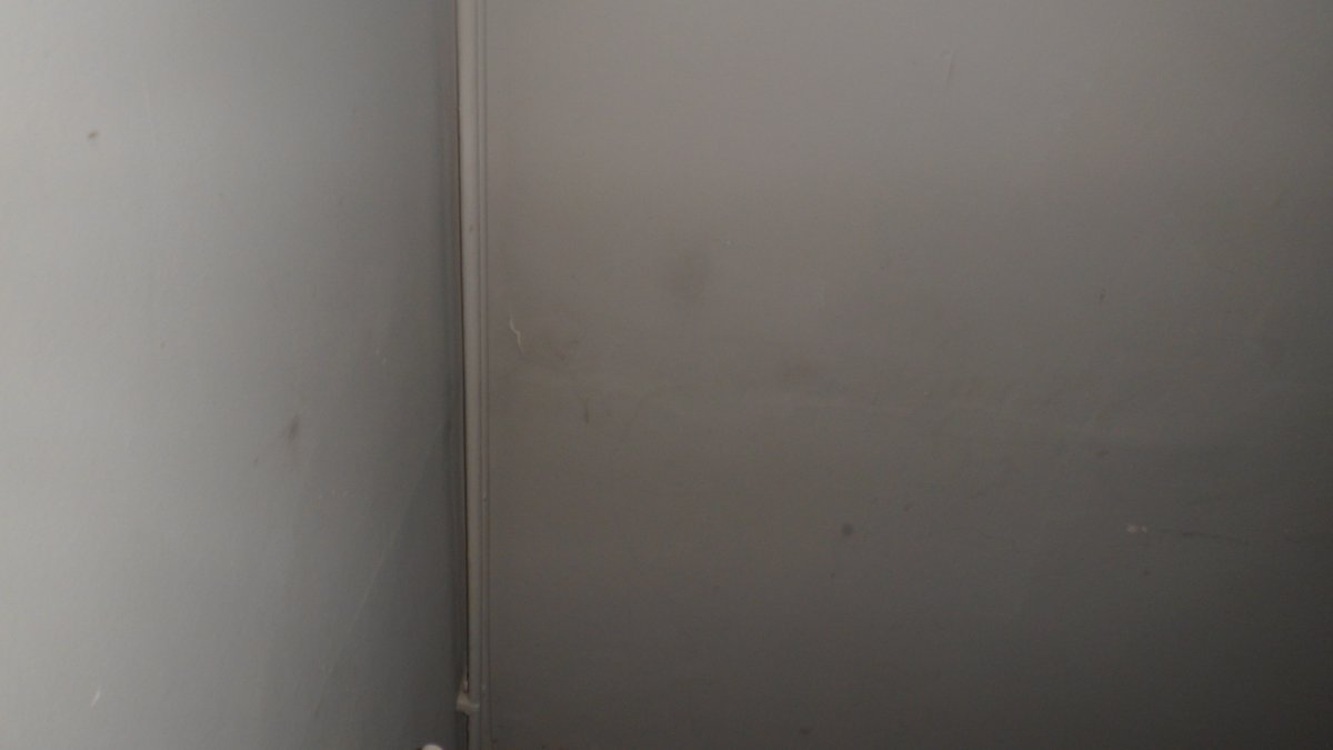

The surveyor did say the house has condensation issues i think he is wrong and believe it has a penetrating and raising damp problem
The surveyor also said the bay window area is dry lined . he wrong there no dry lining. All the doors are on upside down. which wasn't picked up in survey All he said some doors need adjusting
