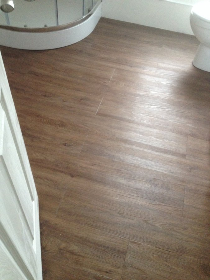

I had some of this fancy Laminte vinyl planks fitted in my bathroom and I'm delighted with how it looks. The only thing bugging me is that there are a few noticeable gaps where the planks meet (glue was use beneath prior to install). Any ideas of how to make these less noticeable? Thanks in advance.

PS it's not actually laminate wood it's just planks that resemble laminate but they are bendable I'm guessing Lino
They are LVT planks - luxury vinyl tiles
Looks like a DIY job or a Floorlayer who doesn't fit many as you never have the headers in line like that.
Gaps will be from -
Wrong adhesive used
Wrong trowel used with adhesive
Planks not acclimatised
Planks laid to warm then have cooled down.
Planks not rolled.

Or just not enough attention to detail. Not really anything you can do now without pulling it up.
Ok thanks. Might just get Lino laid instead. Could the people laying the Lino lay it on top or would it have to be ripped up? I had plywood laid to make the floor even but worries the glue would make it uneven again if I lifted the planks.
From what can be seen in the pic there's nothing essentially wrong with the floor or its covering beyond, as observed above, it being an amateurish job.
Dont rip anything up or start laying sheet vinyl on top of the LVT - it doesn't appear to be necessary.
If you have gaps get a Bradel and pull down each joint which will compress and close the wear layer.
