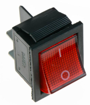

I'd like to make a socket that is switched by a flying lead terminated in a desktop switch, preferably with an indicator.
It only needs to be 3A maximum rating.
I could probably find a suitable trailing socket into which I could terminate both leads, but does anyone know a source for the switch?
I can find plenty without a neon, but none with.
Thanks.
Another option would be to buy a panel mount illuminated switch and mount it in a small box.
Sorry, guys. I should have been clearer.
I want something like this (but preferably with an indicator), that will sit on a desk, connected to a lead that controls a trailing socket outlet fed via a 13A plug.
It's to switch off an appliance which is plugged in underneath a huge desk and it's not easy or convenient to get to the plug.

If 'losing the remotr' were the only issue (against using a remote), then you could stick/fix a dummy 'flying lead' to the remote and tie the other end to a leg of the desk/whatever. However, what I would probably personally do is ..
Something the below. It would involve a bit of work, and you'd have to sort out cable restraint etc, but a very small plastic box would suffice. I'm not sure if you feel the need for DP switch but, if you did, then you would presumably have to use 5-core cable, which might be a bit bulky.
