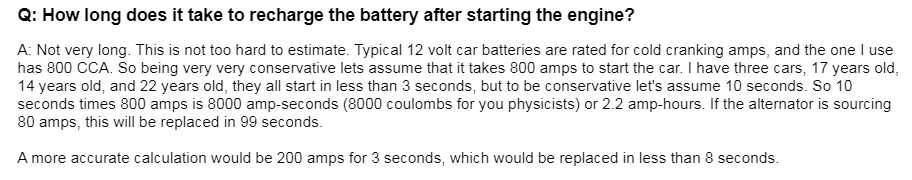

from start it takes approximately 13 miles to put back the charge you used to start the car.
Is that the case?
Surely, a start, 10 mile drive, stop, restart, 10 mile drive home would not result in a lower battery state than before?
Some sites say it only takes a few seconds to replenish the battery after a normal start.
