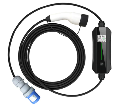

However there is nothing to stop you having a 32 amp socket fitted for general use, for example running a welding set, and plugging the EV charging lead into that, this lead plugs into any 32 amp socket OK not cheap at £280 but this lead 1656519258515.png will plug into any 32 amp outlet, maybe not safely, but can be done, and would be safe in an integral garage.
If you have the proper EV charging point it should protect for loss of PEN even when the car is charged outside, and if you tell the electrician the 32 amp socket is wanted for your electric car, he would need to ensure it had all safety features, and he needs to have gone on courses to teach him the safe way to claim the government assistance.

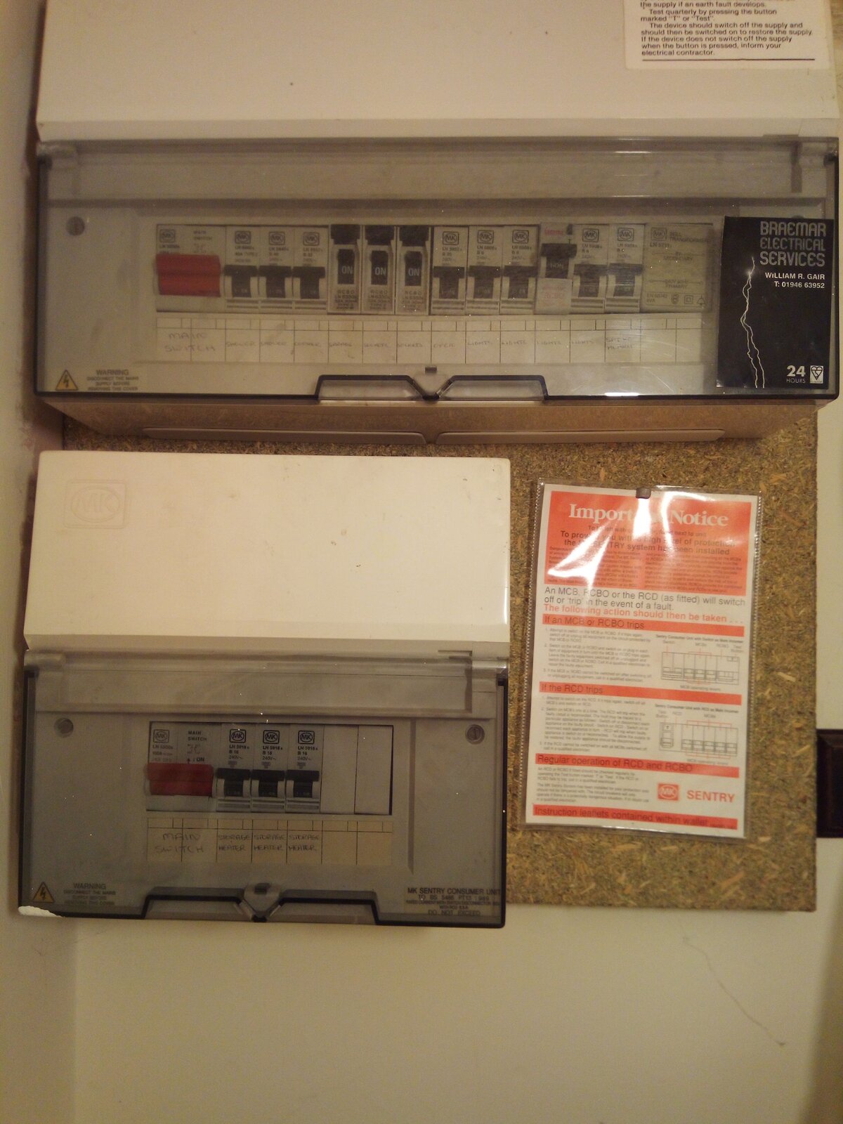

Thanks for that. I think the whole house swaps to the cheap rate at night. The reason I think this, is because the only things in the house that are connected to the "night" meter are the three storage heaters, which are off in the summer, but the night meter reading continues to go up.
Here are the consumer units:
And here is the meter. It's one meter with two dials in it.
Can anyone who understands such things, tell me what I've got, please?

You are correct, all your energy switches to nightrate so that simplifies things. Originally I read your post to say you had 2 individual meters which would have complicated things.
Sorry! By "meters", I meant the two separate rows of digits for the day and night consumption, but I see what you mean, they're in one "box"!
One interesting thing that I can't get my head round, though. The storage heaters will only warm up at night (if we use them). So if the whole house switches to E7 at night, what prevents the storage heaters from drawing power during the day as well? Their consumer unit must be on some feed that only goes live at night?
Never had Economy 7, but am under the impression there is a forth wire which tells the storage heater when to turn on with modern systems, and turning to boost over rides this command to the storage heater.
As to the lead I showed, if being charged in a garage no problem using the lead in a 32 amp socket, the problem is charging outside, be it a hot tub or an electric car inside no problem with TN-C-S but outside there is.
No, it won't fit in the garage. My much-loved old ICE car lives in there! The EV (if it happens at all!) will be a company car, so it can jolly well live outside! I might, however, build it a car port, as that's something I've been thinking of doing for the last 20 years anyway!
