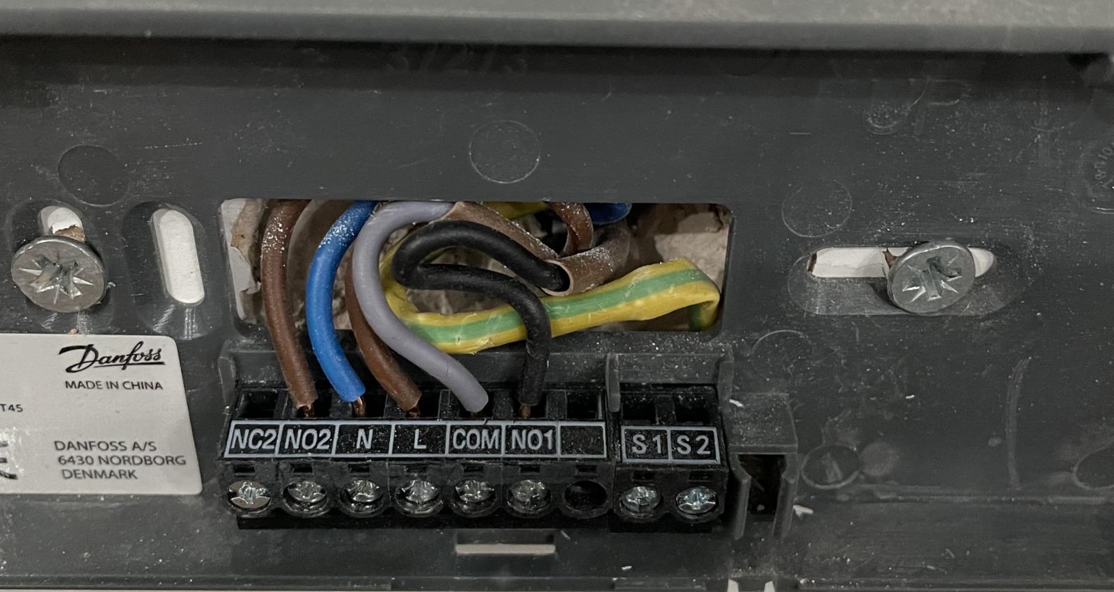

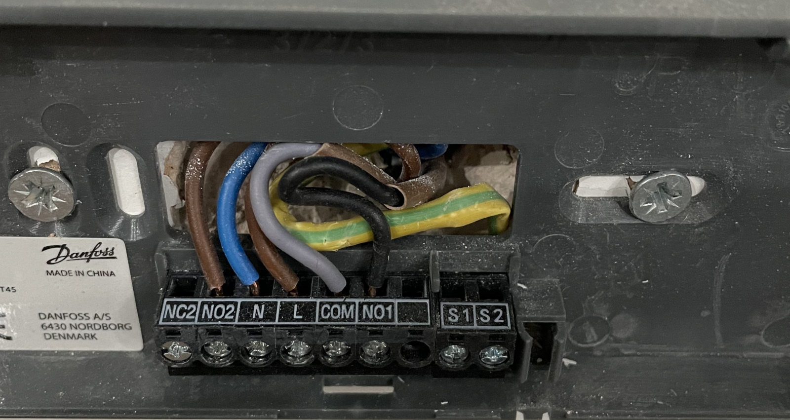

I am looking to replace my Danfoss TPOne-M that controls the central heating and water with something smarter.
I tried this ~4 years ago with the Tado system, but had to send it back as it wasn't compatible with my setup at that time.
So, I am looking to see if there are people smarter than me that can advise on what my options are?
Here is a wiring image that goes to my Ideal H18 boiler.
Is it possible? What options do I have - TIA!

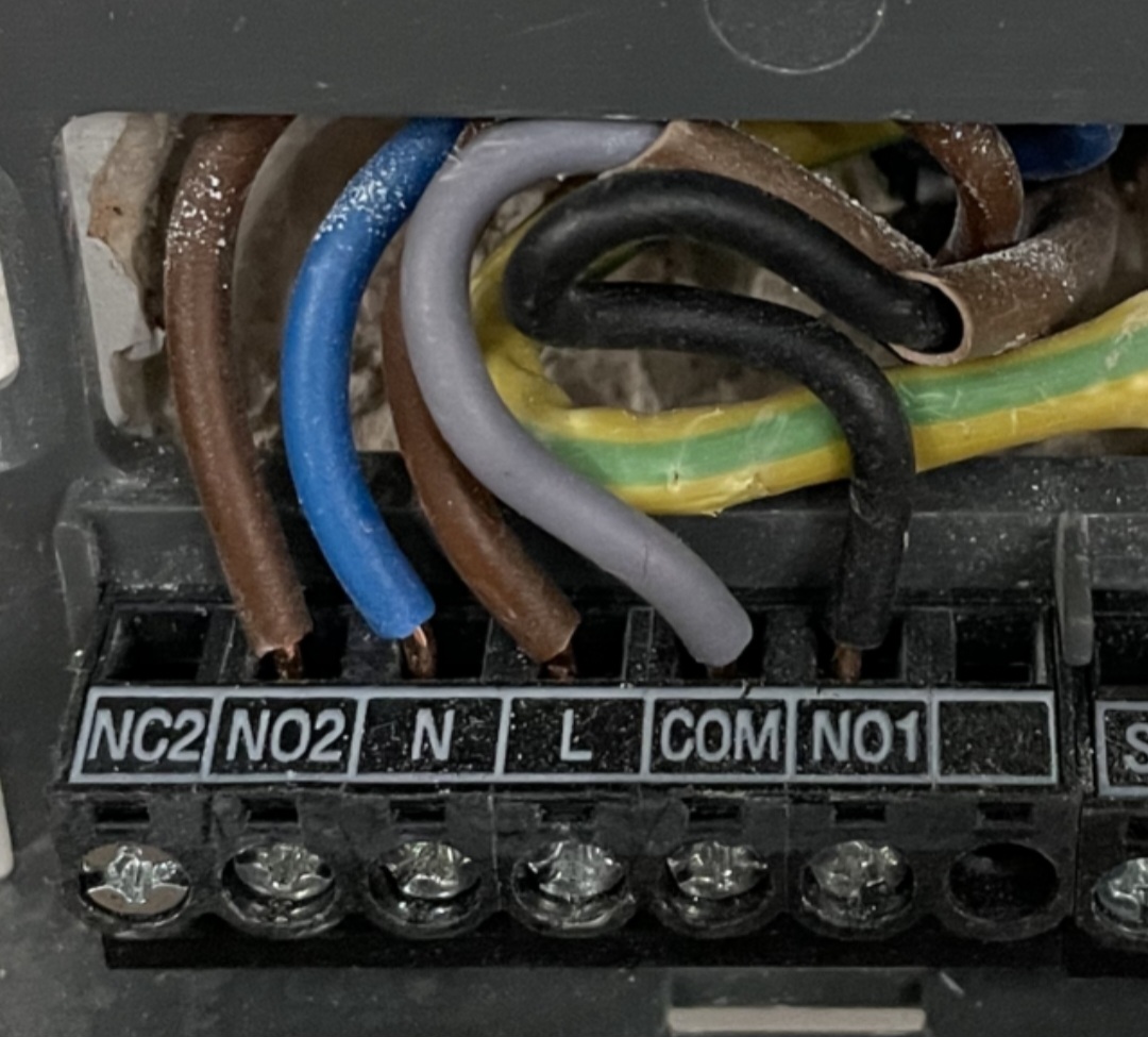

Your TP One-M has been connected up with a grey wire into the COM terminal, that provides a switched live to the black wire on the NO1 terminal.
The common of the NO2 terminal, is internally connected to L.
This is a slightly unusual arrangement, as most dual channel programmers would have both commons supplied directly from the L.
This is the case with the Tado extension box - and the reason why Tado said it was incompatible (they were asking if you could confirm where the grey wire came from).
The next step is down to you, many smart stats are compatible with your system, even without knowing where the grey wire comes from.
I.e. dual zone stats that have volt free (or dry) contacts, such as Nest, or even the Tado V3+.
Alternatively, other stats could be installed with connections made at the wiring centre - you mention another stat, does that mean you have a dual zone and Hot water system?
I'm afraid Netatmo don't seem to provide a stat that controls a hot water channel, but even then, you could have a basic HW timer and have another Netatmo, purely for the other heating zone.
The choice is yours!

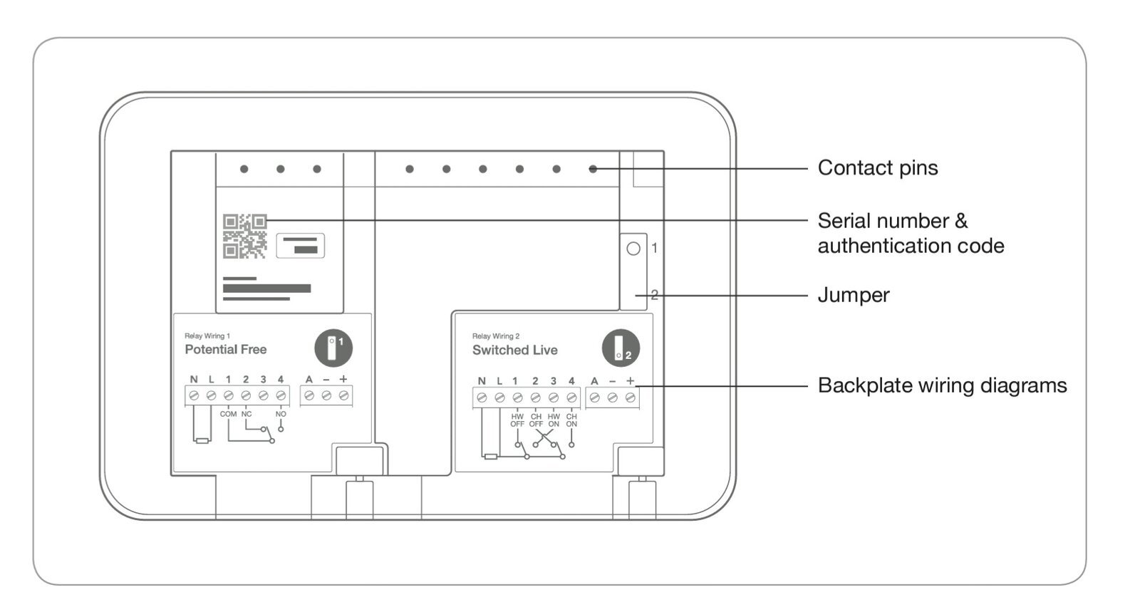

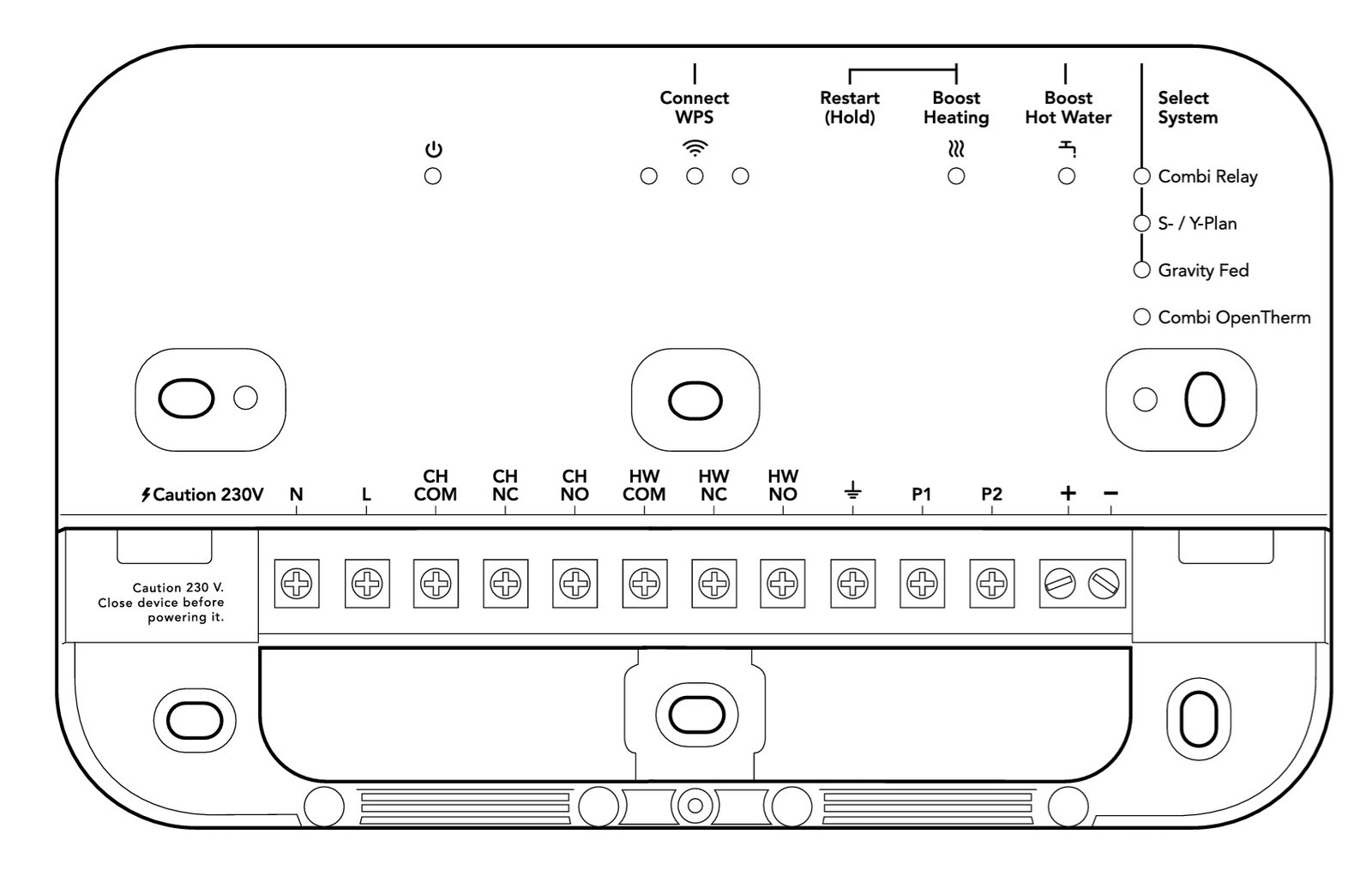

OK, it has taken a while, but I got the Tado X Wireless Starter Kit as their website said my system was compatible.
When I went through the setup and input all the info and answered their questions, they then said I need to contact their support. - why they couldn't ask these questions before I purchased is baffling?? - Anyway... it has been over a week and no reply so I am back asking for help to do this myself

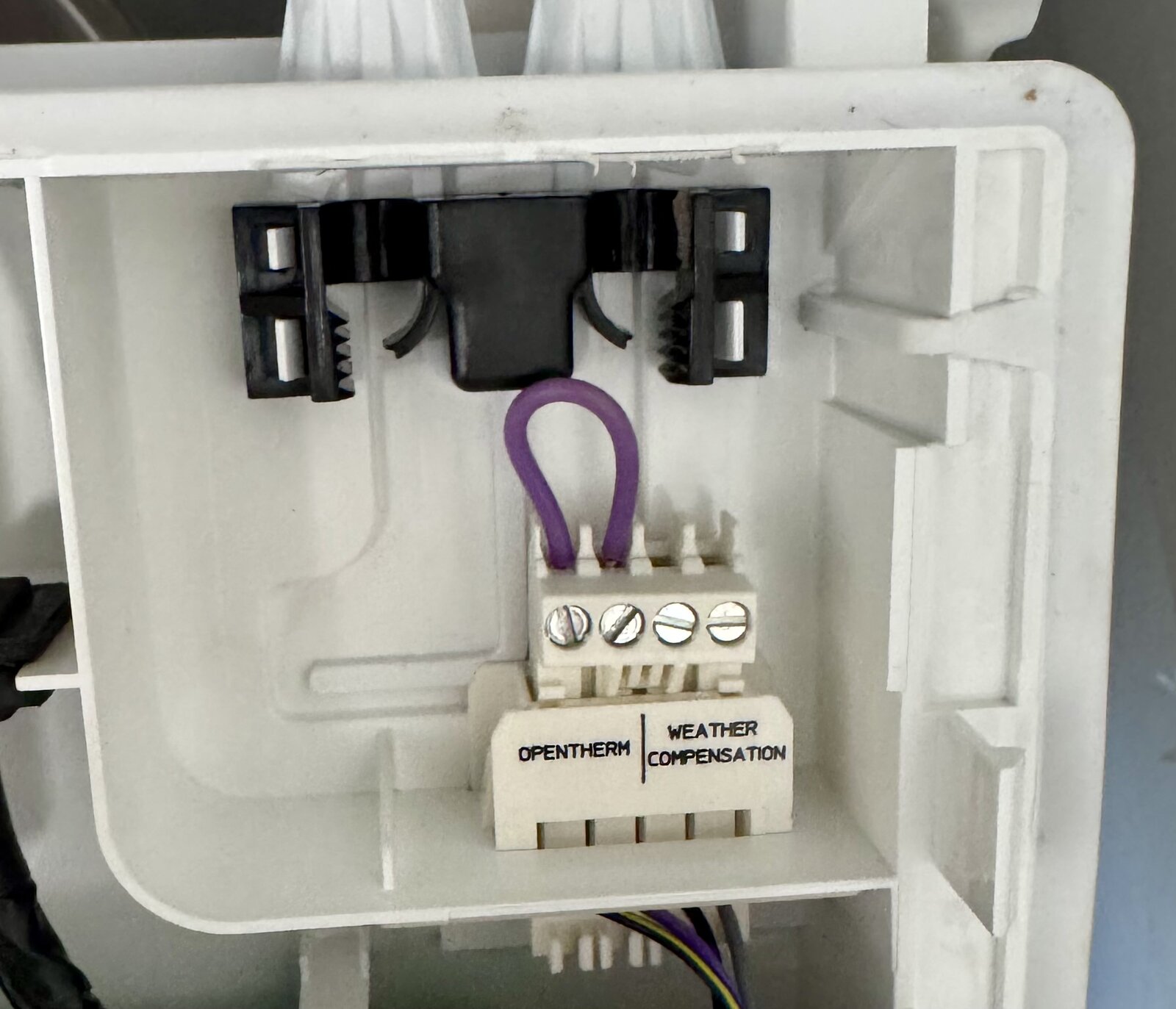

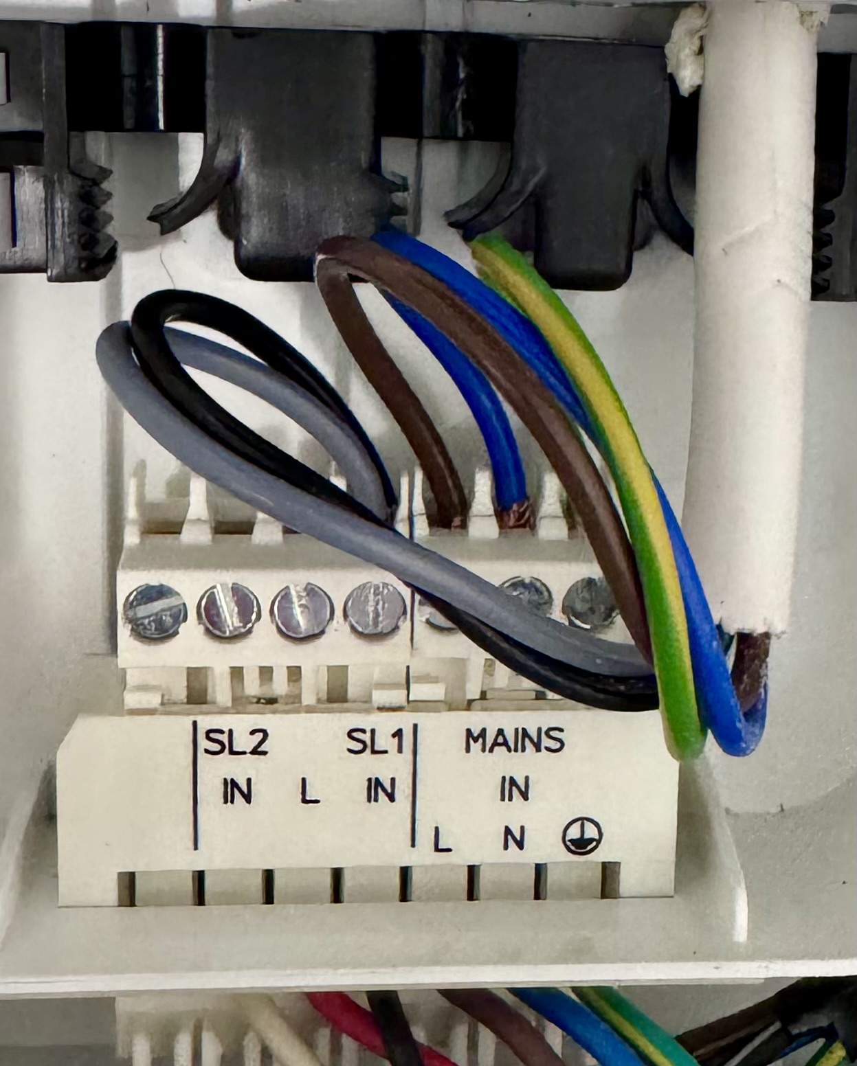

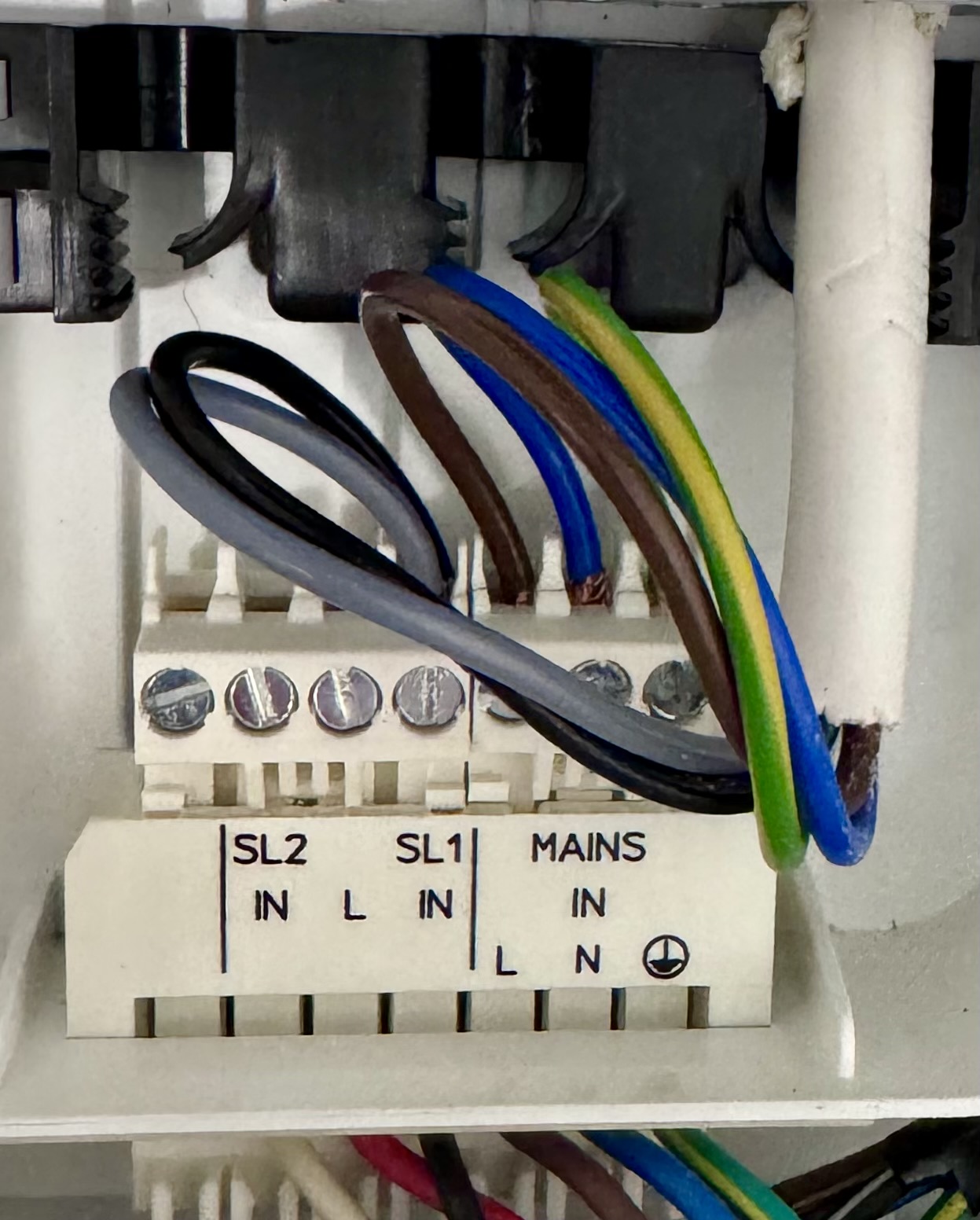

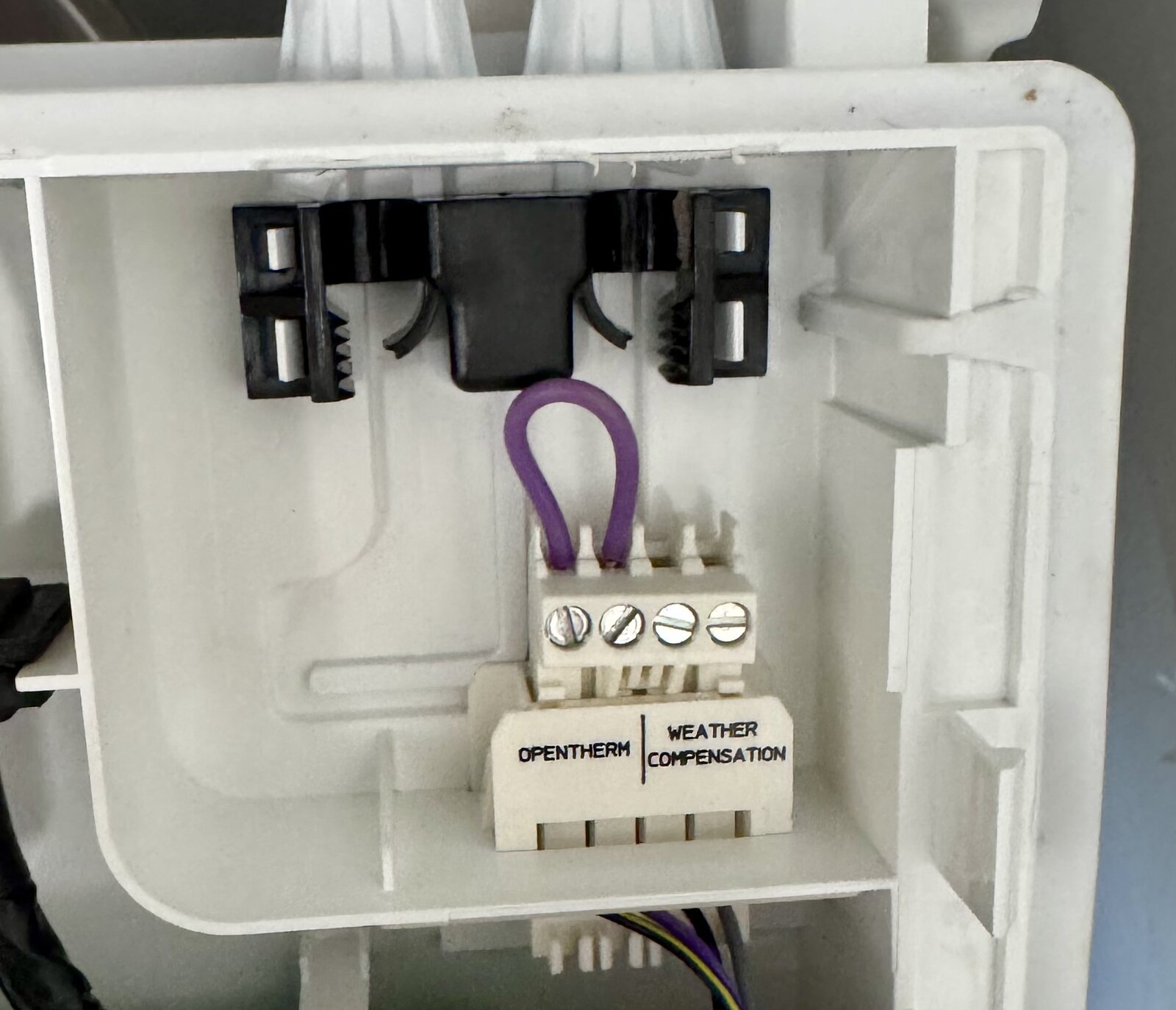

here are the extra images asked for in my setup on the boiler side. (Ideal Logic H15)
Any help would be greatly appreciated!

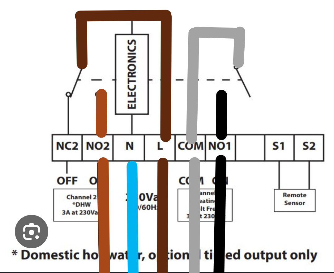

To purely replicate what is in the TPOne-M, we can try...
The Blue wire in N on the TPOne-M would go to N on the Tado X.
Brown wire in L to L.
Brown wire in NO2 to HW NO.
Add a short Brown link wire between L and HW COM on the Tado X.
Grey wire in COM on TPOne-M to CH COM on Tado X.
Black wire in NO1 to CH NO.
And the Green/Yellow sleeved earth wire would go into the Tado X earth terminal.
