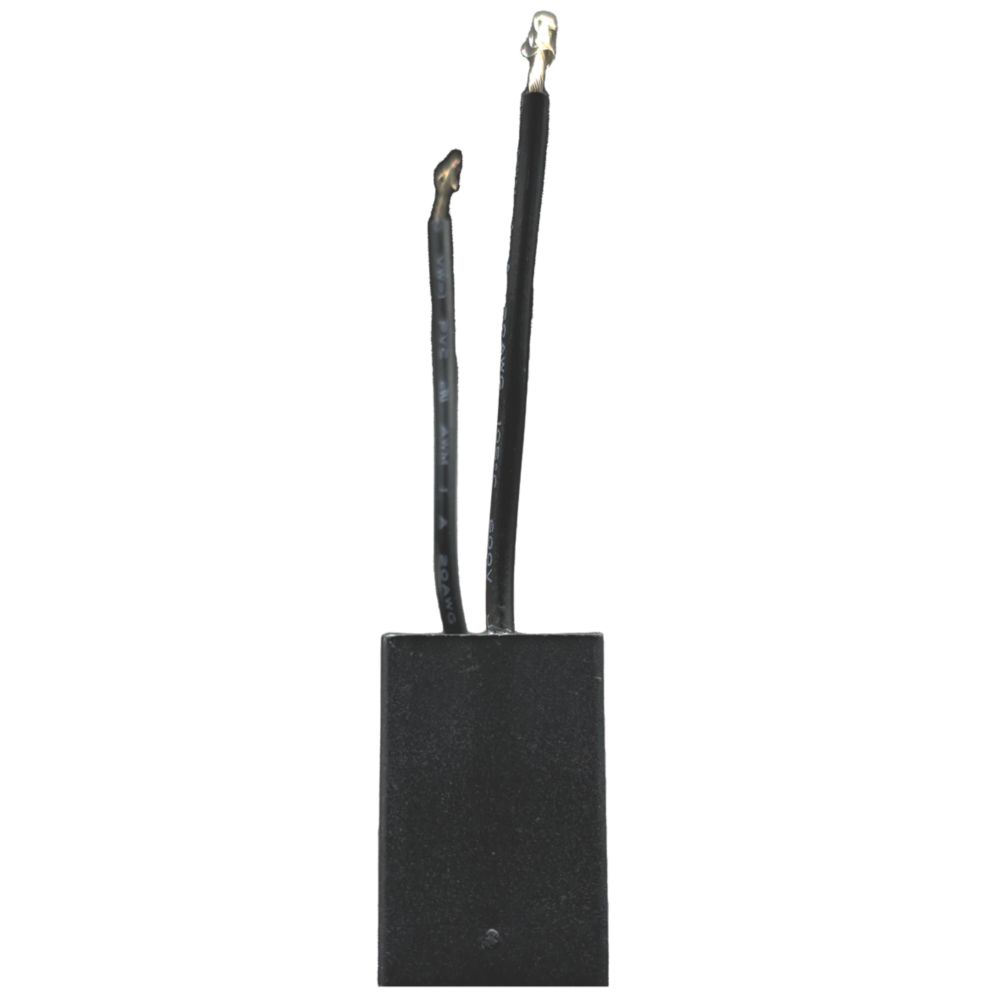

This device may help
ae235
it provides a leakage path for the small leakage current from switch, it fits across the supply to the electronic transformer, clearly needs an enclosure, but should work.
ae235
Looks good. Could I install it above my pattress box in the wall cavity?

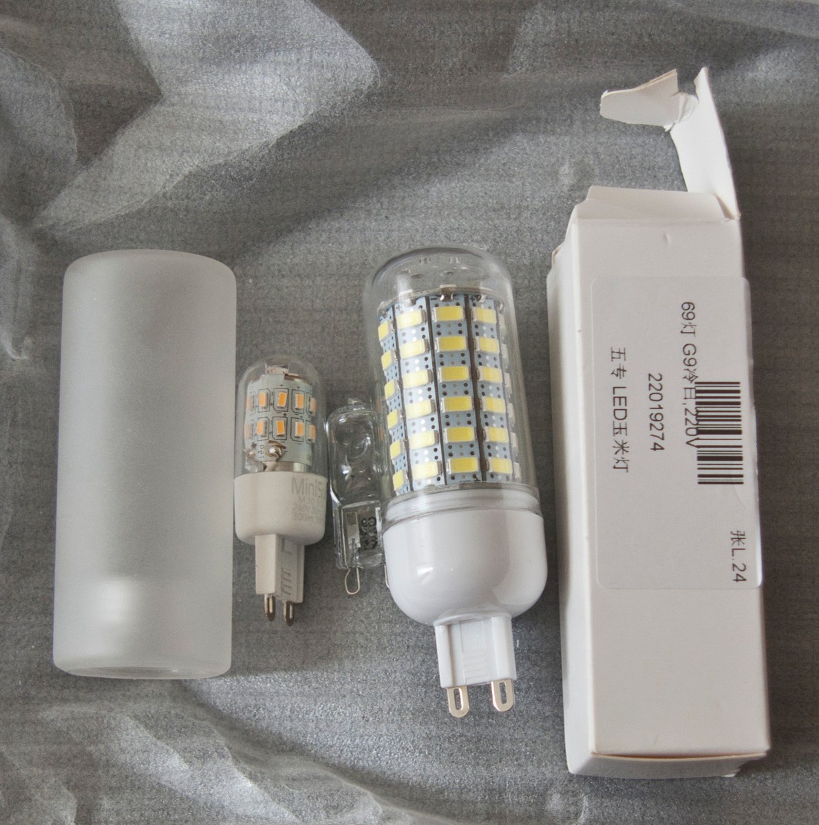

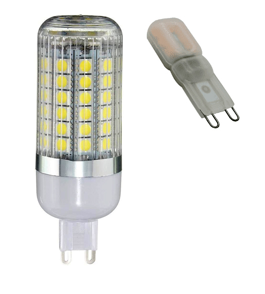

I just about got one to fit in my chandelier in wife's bedroom, it was a tight fit, I use Energenie smart switches and it did stop the flashing when off, however there was also a shimmer when switched on, so swapped bulbs, G9-comp.jpg and likely with the larger physical bulb would not have needed the load capacitor.
Thanks - don’t forget I can’t get to the transformer as under decking so will need to be located at the switch.
Does that device have a series resistor built in ? A fusible resistor in the device provides protection if the capacitor goes short cicuit.
Contact suppressors have a resistor built in and are ideal for this application.
KEMET RC Capacitor 470nF 100Ω Tolerance ±20% RS Components Stock Number 172-6734
Other sources are availane
4μF is far more that would usually be needed and, as bernard has pointed out, it would be desirable for it to have a series resistor (but the device you have linked to is just a capacitor).

However the big difference is there is no standard, nothing says a bulb must sink 0.1 mA or any other figure, the packet had to say if not dim-able before we left EU, but it did not have to say how much it leaks, and with a dimming switch using a neutral the leak resistor can be very small.
So you can get two bulbs G9-comp.jpg which are very different in how they can handle small stray currents, and also how they react with other devices on the circuit, the large bulb has a reasonable large leakage resistor, and also after the rectifier a large smoothing capacitor, so it can deal with both the leakage and any problem forming a tuned circuit so does not flicker either. The small bulb is nearly the size of the smoothing capacitor inside the large bulb, and also has a smaller leakage resistor.
With a simple on/off switch either bulb will work, with an electronic switch it needs the larger bulb, which in this country does not comply with the law, as not got the lumen or wattage marked on the bulb.
But more to the point non of the bulbs have anything to say how much power is leaked.
I must admit I don't totally understand what causes or cures the problem, I know with 5 bulbs, swapping just one of the 5 can stop both flashing when off, that bit I can understand, but also the flicker when on, that bit I don't understand, why fitting one of the large LED bulbs stops the other 4 from flicking I don't know, only that it does, I would assume it has stopped it forming a tuned circuit? But if the flicker is caused by it forming a tuned circuit then likely we are also making a transmitter? So it may affect other items in the home?
I like LED lamps, as I am by nature a lazy man, and with old tungsten every other week I was renewing a bulb some where in the house, and I kept a supply of bulbs IMGP0859-60.jpg that is not really required now, but due to matching bulbs it is still increasing in size, the G9 bulb was a real problem IMGP0870_1.jpg the cover to left was intended to go over the quartz bulb to stop harmful rays, and to retain white hot parts if the bulb explodes, the small LED will fit inside the cover so whole chandelier looks the same with quartz or LED, but the larger bulb changes the whole look of the chandelier. I know this bulb
