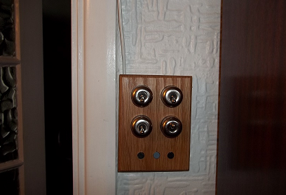

Being aware of the lack of information and the trouble that comes when interfacing "smart" switching with "smart" lighting I decided that "smart" switching and "smart" lighting would be banned from the design for the re-wiring of my cottage.
With one exception all the fixed lighting is switched using relays controlled by 12 volt switching circuits. This allows for the use of small multicore cable for switch drops where cables have to be surface mounted due the way the walls are constructed.
This panel uses 12 core alarm cable
The push buttons at the bottom provide for dimming of the lamps and there is another switch in the other side of the wall.
There is an "intelligent" programable logic controller which provides features such as outside lights coming on when someone enters the yard after dark and timed ON periods when leaving the cottage after dark. Some quirky things like porch light coming ON when the door bell is pressed. Some security related items which I don't talk about.
