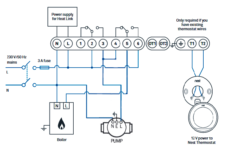

Your description matches my system and I have Nest Gen 3 fitted. So do you have a thermostat on your domestic hot water, or is it simply timed in summer? It would seem likely you have a C-Plan.
This is a plan for when there is no thermostat on the hot water tank, i.e. the most basic system. The main point is the Boiler is feed from the Com terminal on the Nest heat link, with most other systems the Com is internally connected to line in, or to other com so the Nest is unusual in that it allows one to connect it up this way.

Main reason for fitting Nest Gen 3 for me was only two wires between where the boiler is, and where I want control, this is now the T1 and T2 wires, it was not fitted because I wanted the "Smart" features. The Energenie MiHome TRV heads came from the last house, I could I am sure set up GeoFencing with both Nest and MiHome so heating only comes on when I get home, but only set up on Nest at this time, and not as good as expected because of where the thermostat is situated. Being in the hall heat from radiator goes upstairs, so slow reaching the thermostat with two doors between thermostat and radiator, morning the temperature is lifted 0.5°C an hour for three hours so over night at 17°C then 18.5°C, 19.0°C, 19.5°C and finally 20°C the TRV heads in other rooms keep them spot on temperature, without the stepped raise it tends to over shoot then boiler turns off for an hour or so in which time other rooms get too cool. This is what happens if I go out, the GeoFencing means heating turns down, then when it returns to comfort setting it over shoots. I know this is due to thermostat location, but it is common to have thermostat in the hall.

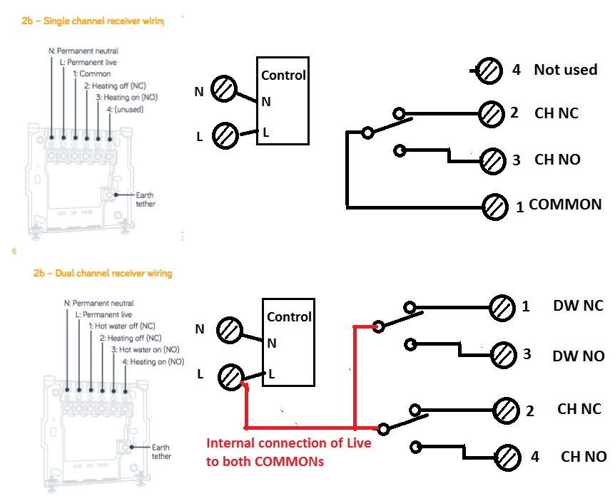

Just buy the Hive dual channel and set it to gravity HW, couldnt be simpler
How? He will have two items to power, the boiler, and the pump, with central heating both need power, with domestic hot water only the boiler is powered.
You have 4 terminals clearly the DHW NO goes to boiler, but how can you power the pump only when CH is called for? You need access to the com terminal which you have not got. Nest will work as you can connect com to boiler, Hive will not as com internally connected to line. To use Hive you will need to add a relay or tank thermostat.
Maybe I am wrong, look forward to seeing a wiring diagram for Hive like the one I have given for Nest.

It is exactly the same as any Gravity HW boiler , just because it is oile makes no difference, HW on to fire the boiler and CH on to power the pump, set Hive to Gravity and when the CH is called for the HW will be called for at the same time, you can not get CH without HW on a Gravity HW system, you dont need a COM on the hive dual channel as the links are internal and already made

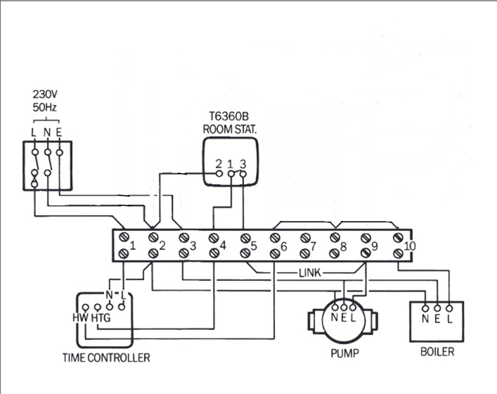

This is the old C-Plan before the tank thermostat was added, it was rather Heath Robinson in those days, the wall thermostat ran the pump and the boiler was kept hot when ever the timer was calling for heat. So the tank thermostat was added.

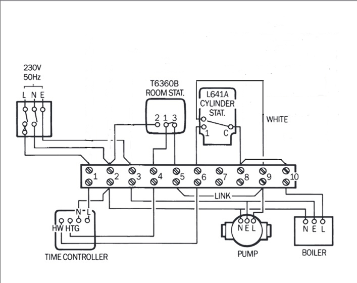

This was a major step forward, by using both the NC and NO contacts of the tank thermostat the boiler only ran when required and could be used in the summer for DHW only, but both diagrams rely on having separate time controller, room thermostat and tank thermostat. But latter would work with both Hive and Nest.
However because Nest gives access to the com terminal in the same way as the tank thermostat does this means it can be wired this
c-plan_basic_nest-jpg.179531
way, so in summer hot water only is possible on a timed control only and in winter the central heating can run clearly even with DHW switched off it will still heat, but central heating can be turned off in summer.
So with @bernardgreen diagram if CH NO goes to pump, and DW NO goes to central heating boiler then it would rely on Hive always turning on DW NO when central heating is required, some programmers in fact did do that, there were switches and mechanical links that could be set inside which turned it from 16 option timer to 10 option timer, however although common in the 1980's not seen a programmer with that option for years.
So the big question is if you set the Hive duel unit to gravity are you 100% sure the DW NO contacts will close every time the CH NO contacts close as with those very old programmers? If not then Nest is the way to go, as I am 100% sure that diagram works as that is how wired on my own system. OK I have a few extras as house and flat under house are independent, but that is still the basic wiring used, and it works.
@ianmcd seems to say the DW NO contacts will close when ever CH NO closes, and he may very well be right, but I can't find any Hive instructions to confirm this is the case, these instructions for Hive don't give a single wiring diagram, Nest pages 20 to 25 does give wiring diagrams, OK it does not show the one I have posted, but does show some examples.
