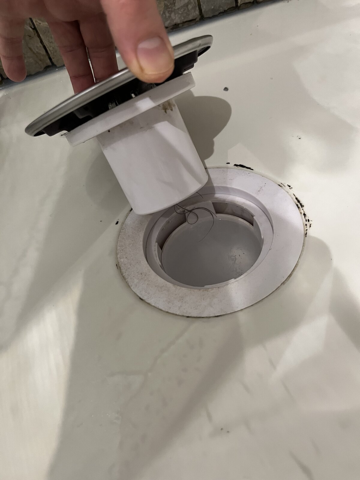

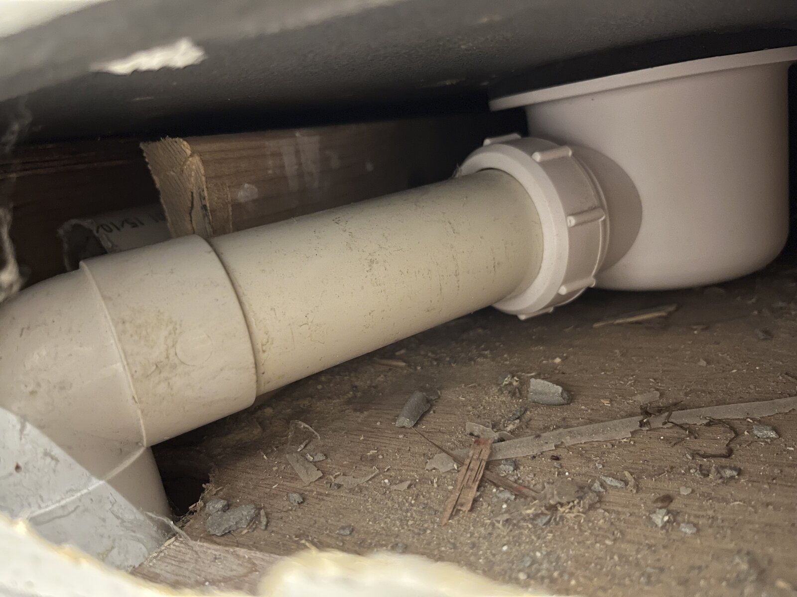

Hi,
New house old problems.
Getting a smell from the shower tray and would like to confirm if this has been installed correctly. Should there be a trap of some kind to stop smells or is the trap built into this waste?

Yes that is a trap and as long as you do not empty the water from the pull out section that is in place in your first image you should not get any smells from sewers. Hairs and soap residue can have an affect, reducing flow and seal so you need to clean the whole thing regularly.
