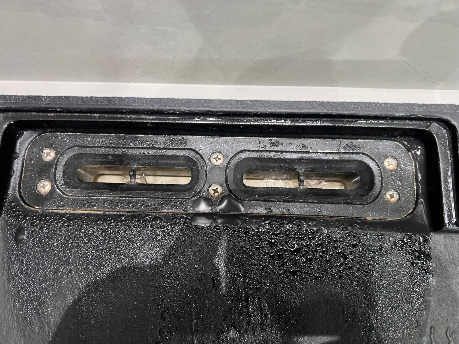

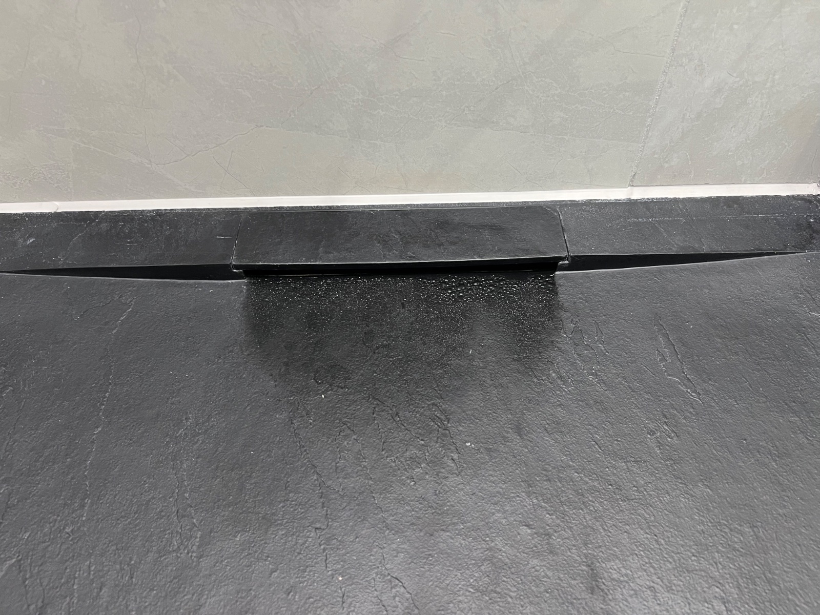

Hi all. So I fitted a new shower a couple of months ago and noticed I'm getting a sewer gas smell every now and then. I have checked and it appears to be coming from the shower trap.
Every couple of days the shower looks like the attached image. When I add water or use the shower the smell goes for a bit so I assume that the water is evaporating from the trap and allowing the smells through.
That waste line does have an AAV fitted further along so assume the water isn't being sucked out.
Can anyone confirm this from the images and if so how can I attempt to stop this?

Is the shower on the same waste run as another fixture that is used regularly? if so, there could be back pressure that is blowing the seal out of the trap. What is the depth of seal in the trap for the linear drain?

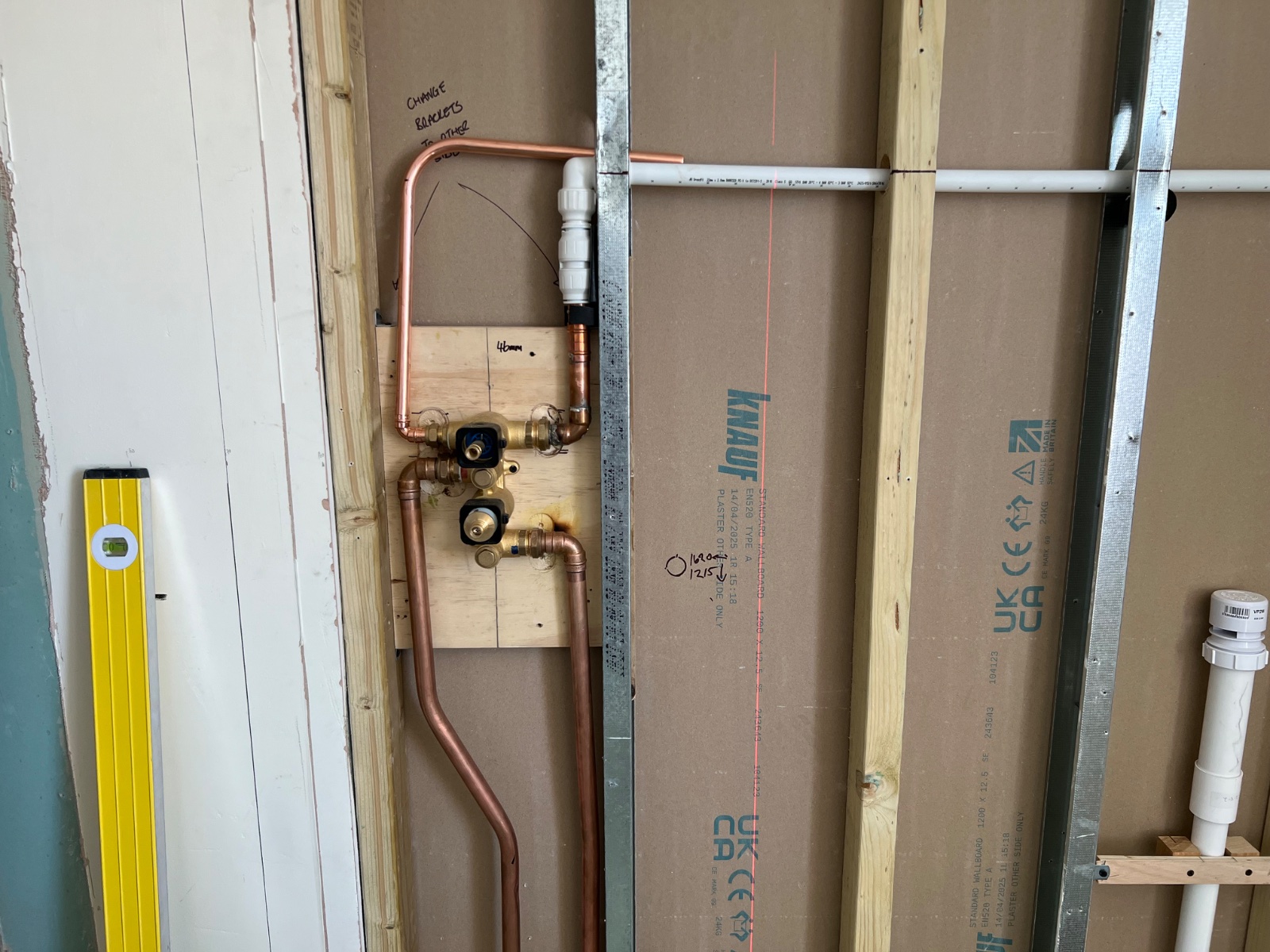

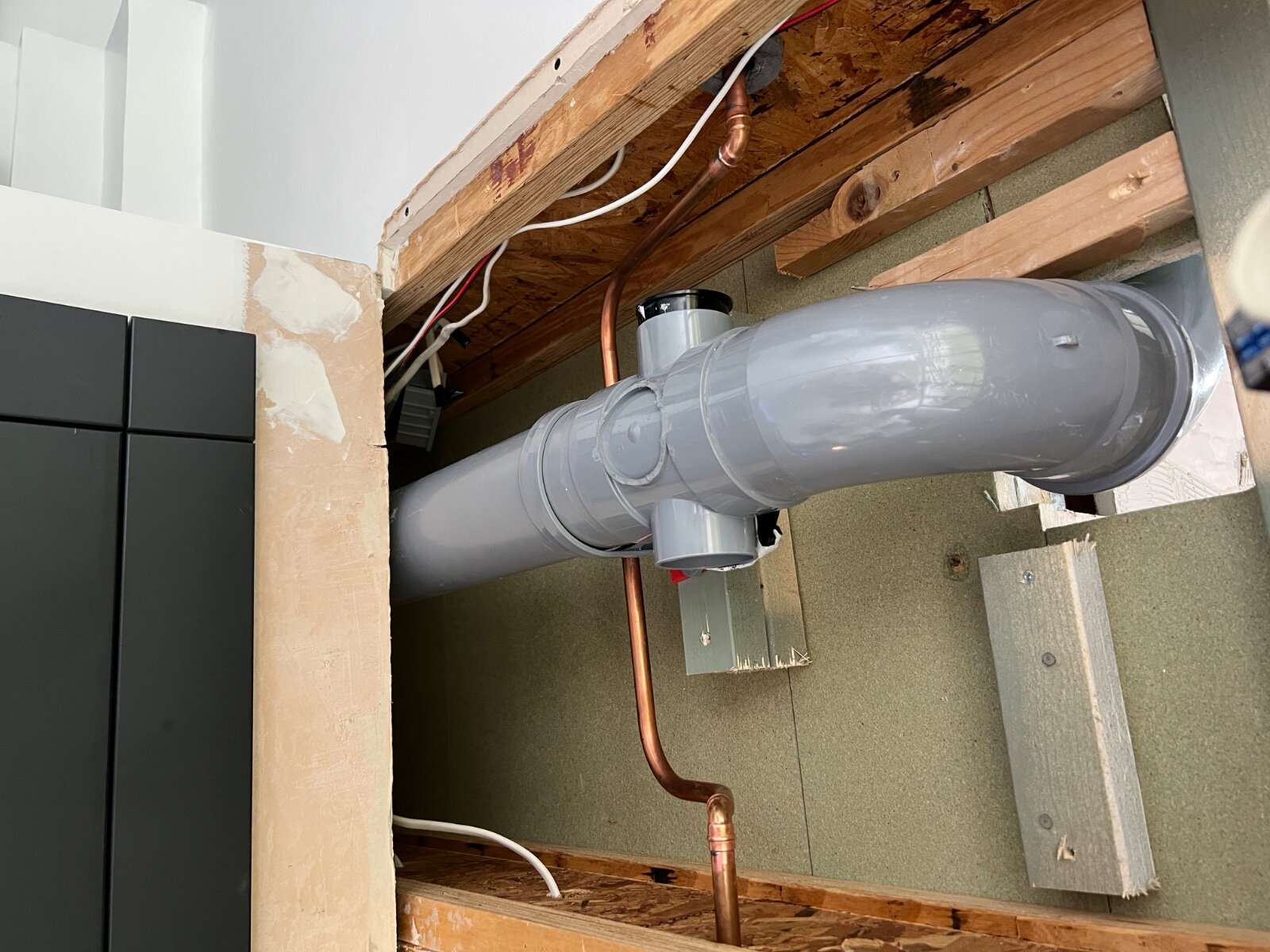

Basically I have a soil stack coming up from the ground downstairs vertically. It then elbows horizontally for about 1 metre before elbowing up through the floorboards and joins to the bathrooms' toilet. Before the elbow up is a solvent weld boss. With two 40mm connections. One line runs to the small sink and bath (rarely used) and the other line runs solely to the shower. There is a tee in this line close to the shower trap which goes up into a plasterboard cavity wall with an AAV fitted just in case which I was assume would stop any siphoning. ‍(in the right of this picture)
Second picture is the boss without the 40mm pipes connected. One went in either side.

Not evaporation in that small space of time. As per @Madrab the toilet flush is blowing and/or pulling it.
Probably a very shallow trap won't help.

heyyy. So I looked at the trap with the top off when flushing the toilet and it did move up and down and definately a few mm lower afterwards.
I then did you bag suggestion so nothing in or out there and it's doing exactly the same.
It's so annoying as the main stack has one and so does the shower line, so I don't understand why it's doing it which two AAVs on it!?!? Is there anything else you can suggest?

In-floor horizontal 4" runs are not ideal but sometimes you've got no choice.
Is the whole stack internal or does it emerge from inside to outside at some point?
With the bag on the aav in the loft... Keep flushing the toilet and see if it eventually pulls the shower trap... Run the basin too.
Then remove the AAV (is it pushfit or solvent weld?) and repeat the process.
If it doesn't pull or drop with the AAV removed then you need to vent the stack!
If the only place you can access it is in the loft, then easiest and least disruptive would be to route it up through roof... Send some photos of it in the roof... It's a vent so doesn't really need to be high up the roof pitch... Can be taken over to the eaves.
Another option, if there's room on the shower waste pipe, would be to access it via the ceiling below and fit an inline hepvo (waterless trap fanny trap).

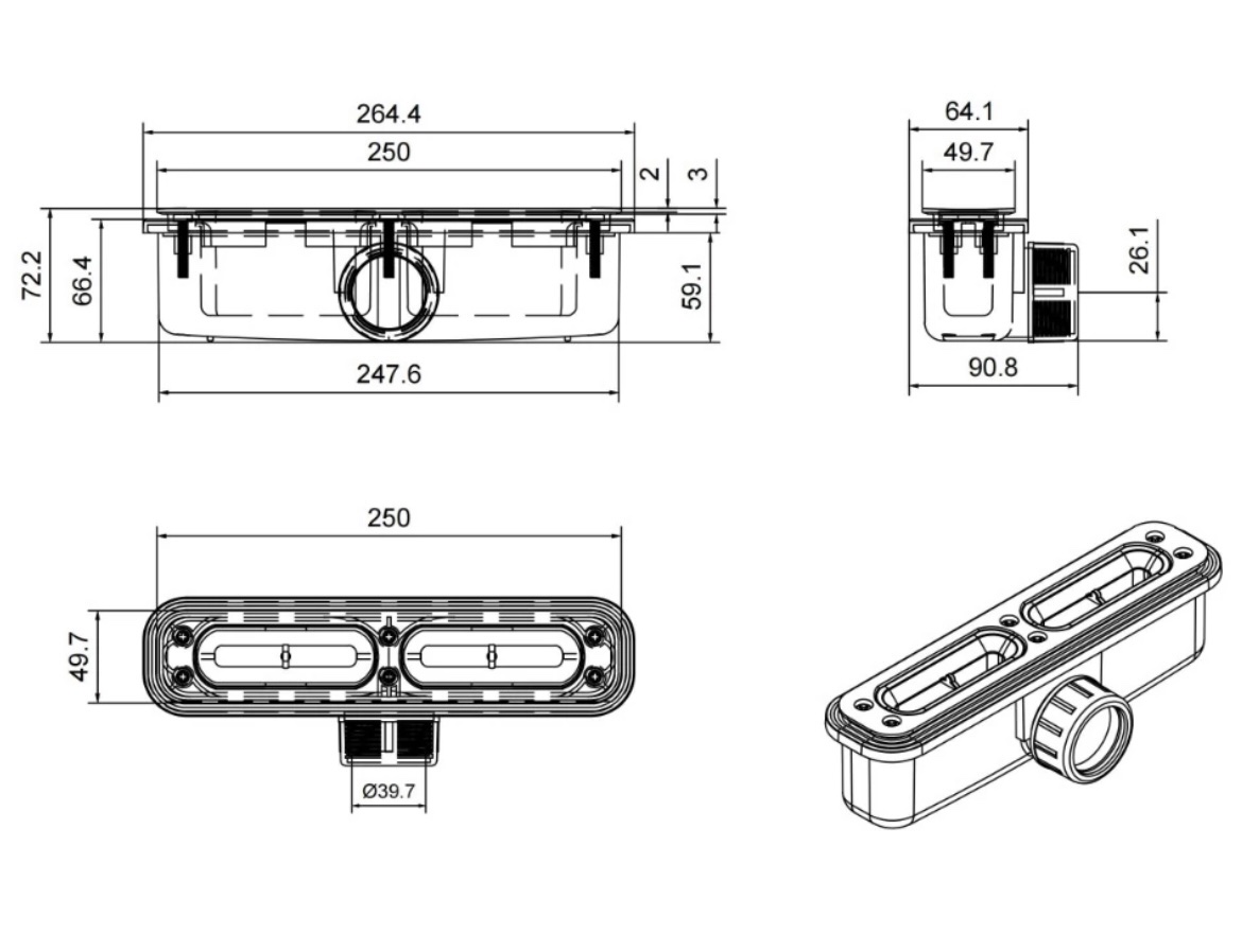

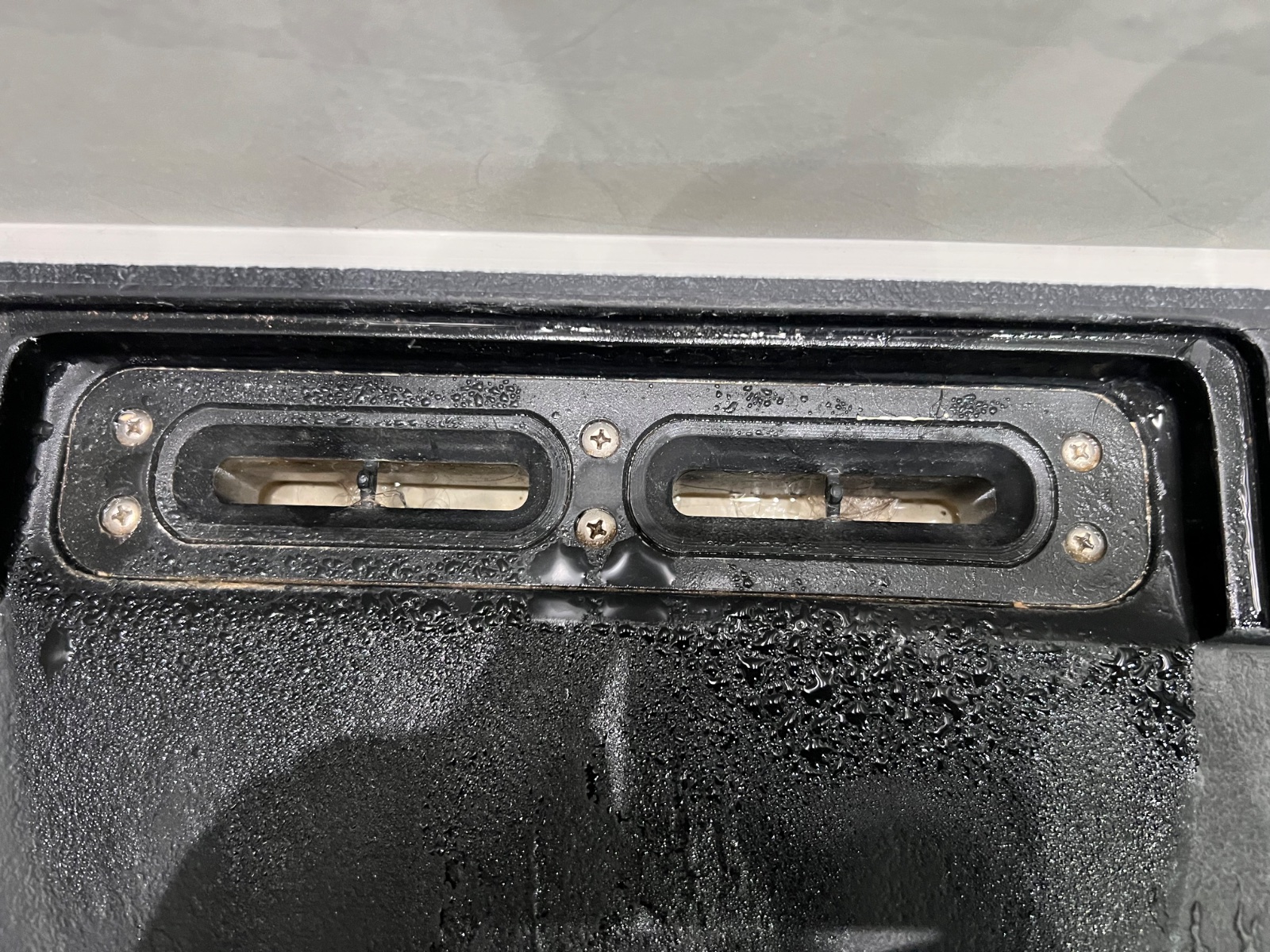

What is the seal size on the shower waste run? Should be in the traps MI's.
Please see images attached of the trap.
