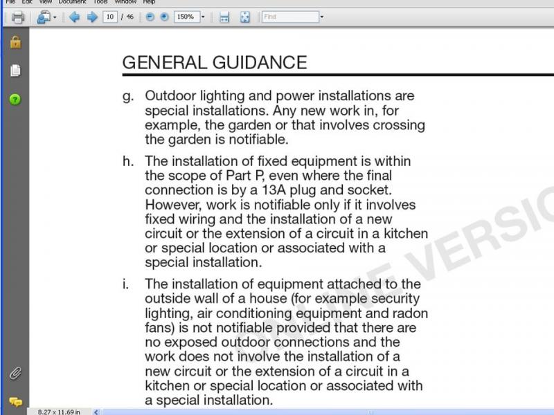

I need to install two linked mains powered smoke detectors. There are no spare ways in the consumer unit so they will have to be fed from a lighting circuit. The question is - is this notifiable work because it is not a new circuit back to the CU but neither is it an additional lighting point. There does not seem to be any mention of smoke alarms on the various lists of notifiable/non-notifiable work that I can find, the regs also seem to ignore them from what I can see.
notifiable IMO
Read section H, to me when it says "INVOLVES FIXED WIRING" that is exactly what the OP is doing, installing fixed wiring.
I know he is only extending an existing circuit, and it is not in a kitchen or special location, but it is still fixed wiring.

I am pretty sure there has been discussions about this before with the use of the term "and" in the sentence you mention. Does this mean its only notifiable when the two elements are combined So fixed wiring which also(and) includes the instalation of a new circuit is notifiable.
If as some argue its saying if you do fixed wiring or an addition of a new circuit both situations need notifying then it appears to me that just about the only thing that wouldnt need notifying is the like for like replacement of fixtures and fitments such as socket outlets, light pendants, ceiling roses etc..
I dont think the intent of the requirments nor in all honesty could the infrastructure support the need to notify just about everything.

But it does not " involve fixed wiring AND the installation of a new circuit", so that condition is false. It's not notifiable on that basis. (Standard rules of logical precedence apply to the comprehension of that sentence - there's implicit braketing around those terms.)
That text in Approved Document P does NOT agree with the wording of the actual law. See Schedule 2B.
But it does look as though it gives stagman perfectly safe grounds for proceeding as if the work isn't notifiable.

The problem, or confusion, lies with Approved Document P, not the regulations. If you read Schedule 2B you'll see that adding smoke detectors is not on the list, and therefore is notifiable.
But as the official guidance (Approved Document P) says it isn't, then nobody is going to come after you if you follow what it says.

Schedule 2B appears to preclude adding lighting points and switches, also socket outlets/fused spurs (unless they know a way of doing it without adding cable, in which case I'd be intrigued to know how), whereas doc P permits it - am I right?

Youre right about the lack of precise wording but as far as the above extract goes it states adding is ok on an existing circuit. So i interpret this, because i want to and otherwise its as you say somewhat ridiculous, i can do this work without notification (except in bathrooms kitchens etc). If however i put in a new circuit that required a new connection to the CU then i would need to notify. It doesnt specifically mention smoke alarms but neither does it specifically mention double or single socket outlets chandeliers or pendants.
