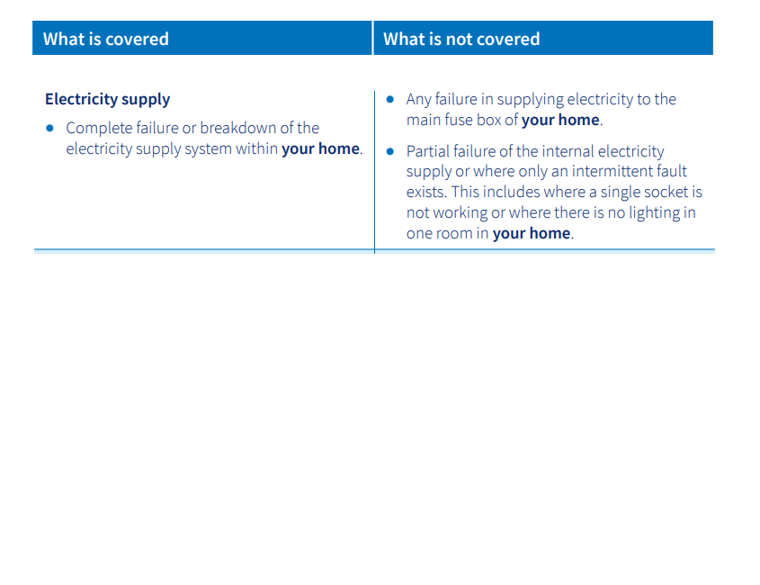

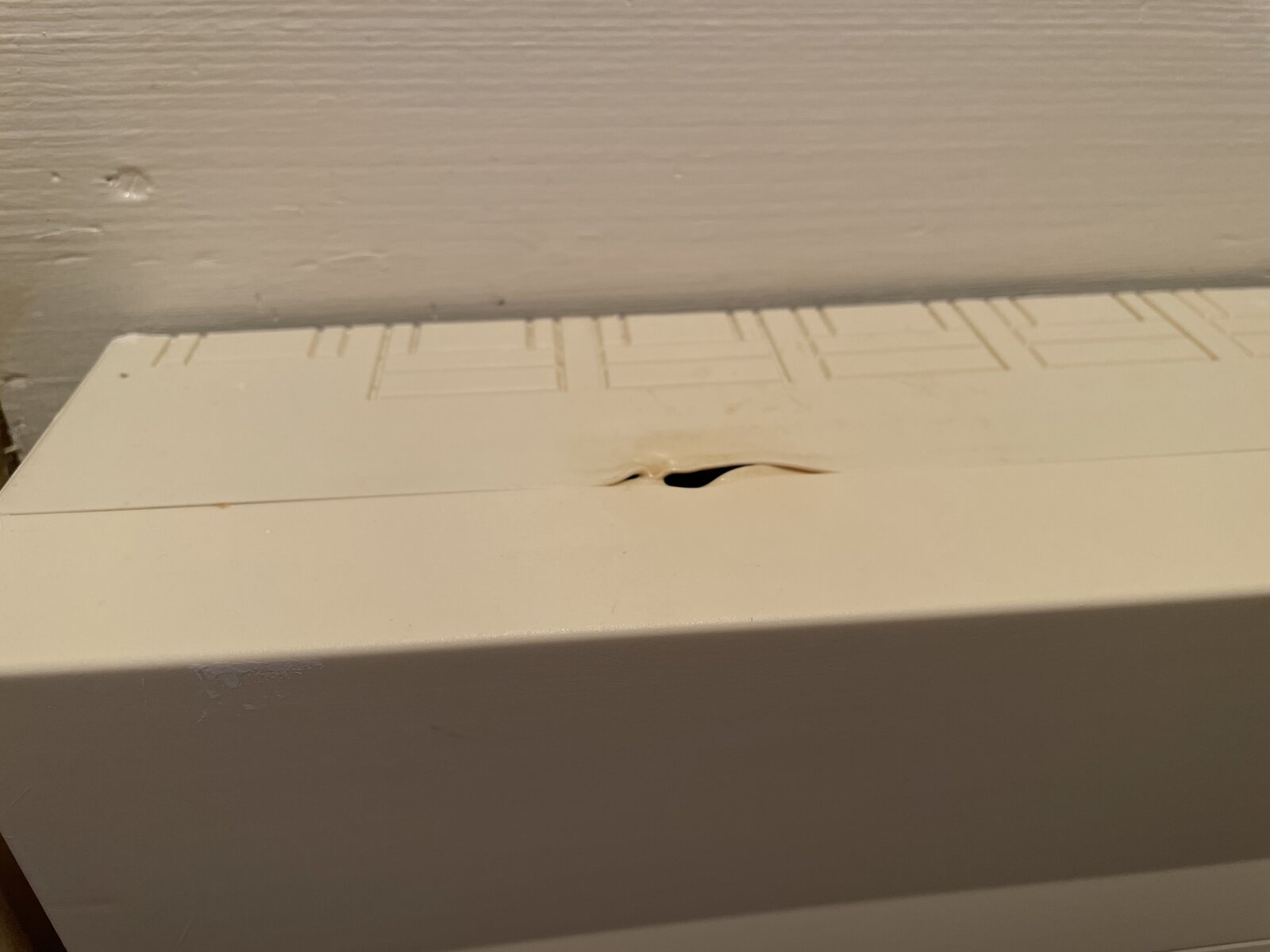

Hi, Last night, there was a funny smell in the house, and when we traced it back to the source, it was coming from the fuse box. It was melting at the top.
We then immediately switched the power off. Having home emergency cover with the Halifax we then made the call for someone to come out.
So that call went like this, its not a home emergency situation because we turned the power off, and at the time there was power and therefore we can't do anything for you.
I've just put in a complaint now. But surely this can't be the case? Basically what they're saying is that I should of left the unit burn and potentially the house and then it would have been a valid claim. wft?
Luckily we were up at the time. The electrics are currently off, so I'm going to get an independent in and defo go down the ombudsman on this one, if it goes that far.

That cover does not appear to be worth the paper it is printed on. "Complete Failure" - WOE is that?
11 Jan 2010
8,420
735
London
Well reading what is and what is not covered it appears they are right. Had you read this before you took out the cover no doubt you would not have bothered. Morally though they ought to cover you but what insurance company has morals? I guess you won't be renewing!

Out of interest, why didn't the RCD's trip as they clearly do not.
Looks from it position probably the neutral bar has got a bit hot and started to melt the case. Probably a bad connection. Rcds won’t trip for such a fault necessarily. What make is your consumer unit?

Its a MK plastic version. Ironically this unit was replaced sometime ago via the insurance.
The main feeds coming into that fuse box at the time got loose, and I remember the Engineer arguing with the insurance company that it had to be replaced and the onus would be on them if they didn't!

Bit worrying though, ultimately if we were not there at the time and noticed. In a worst case would a fire have occurred or would at that point the RCD would have tripped? I'm guessing it wouldn't have mattered if it we're alight anyway.
I think I'm going to install an additional smoke alarm where the fuse box is which is under the stairs. Call me paranoid but for the sake of a few quid would give piece of mind.

I fear that's probably the problem - reminding us that one really needs to make very sure that one understands what sort of insurance one is buying.
As you say, some (maybe many/all?) "Emergency cover" policies are literally what they are called - as you say, providing cover only for someone to 'make safe' in the case of an emergency. If that's the sort of policy the OP has, I suspect that all they would have done had they accepted the claim would have been to send someone out to switch the CU off, just as the OP had already done.
If that's the type of policy the OP has, I fear that there would not be much mileage to be had out of an ombudsman, unless it could be successfully argued that the policy did not make the nature of the cover sufficiently clear.

I think the Ombudsman will side with Halifax, on reading that What is and is not covered. They only cover you for complete loss of supply - the only real way that can happen is a fault with your supplier, which your supplier is responsible for fixing anyway.
Best thing to do is stop paying for the cover, if like most people you are able to turn things off yourself.
