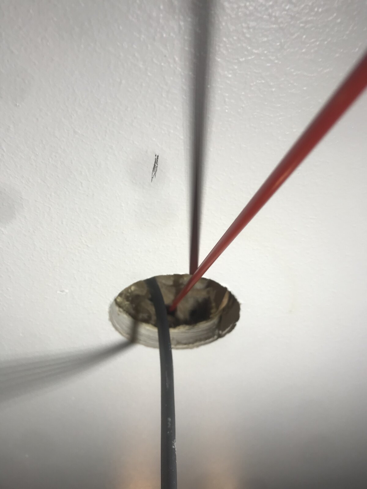

UPDATE: following the advice provided above, I was able to drill out the holes without any incident.
Except…
One of my holes is hitting 2mm of the joist. I had done some inspection beforehand and thought I was clear but obviously not!
I moved the other holes in this line over by 1.5cm and it’s barely noticeable. I need to resolve this though. Could I leave here and somehow shave some wood of the joist? Alternatively, how will I drill a new hole 1.5cm away?

.... Could I leave here and somehow shave some wood of the joist? Alternatively, how will I drill a new hole 1.5cm away?
You could never do that with the (rotating) hole saw - you'd have to use either a padsaw/jigsaw/whatever (maybe even a hacksaw blade, ideally in a 'handle that effectively turned it into a padsaw) or a sharp knife (e.g. 'Stanley') - but you'd probably then have to do some 'making good' at the other side, unless the downlight has a very substantial bezel.

Is shaving some wood off the joist an option?
If a new hole is necessary, can I fill the current hole with the plasterboard cutout I removed (and easifill) and then try a new hole?
In a literal sense it clearly is an option and, to be honest, is very probably what I would do - but I would expect some people to moan if I suggested it here :)
Sure, I almost mentioned that approach, which I would think could work- provided that you got the cutout 'well stuck back in' (otherwise it would probably fall out when you tried to make the new hole. If I were doing that, I think I might well wiggle in a piece of wood above the plasterboard, spanning the hole, and screw the 'cutout'to it (pulling the wood tight against the top of the plasterboard), to make sure it stayed in place when I made the new hole.

Narrow chisel and hammer? Can’t see how I can use any power tool in this situation.
Since my new hole is only 1.5cm away from the current hole, I don’t have much space for a wood above the ceiling to screw the cutout to. It will innevitably come in the way of the new cut out. Is that what you are suggesting?
The joist is sized to support the weight of the roof and cope with the stresses of the roof construction. You shouldn’t be making them smaller.
But even if you shave some off, will you comply with the maker’s spacing requirements.
More care in measuring needed.
End of criticism. Re guarding your wrist and hole saws. As mentioned above, run the drill in reverse, it takes longer, but it’s smoother.
Also, set the Chuck to one of the medium screwdriver settings, not the drill setting. Then if the saw catches, the drill will just buzz, and not wrench your wrist.
