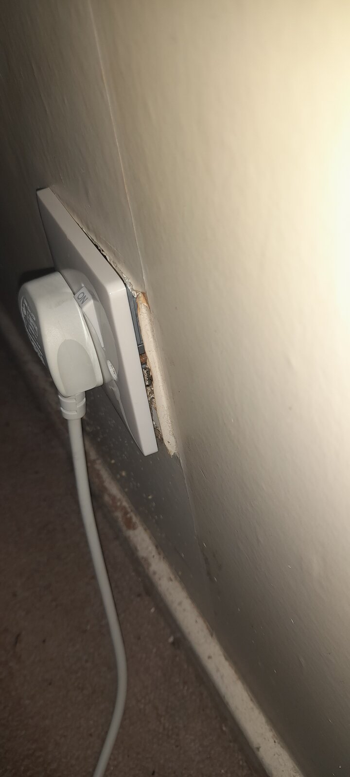

Socket gap too wide to caulk around?
21 Feb 2021
379

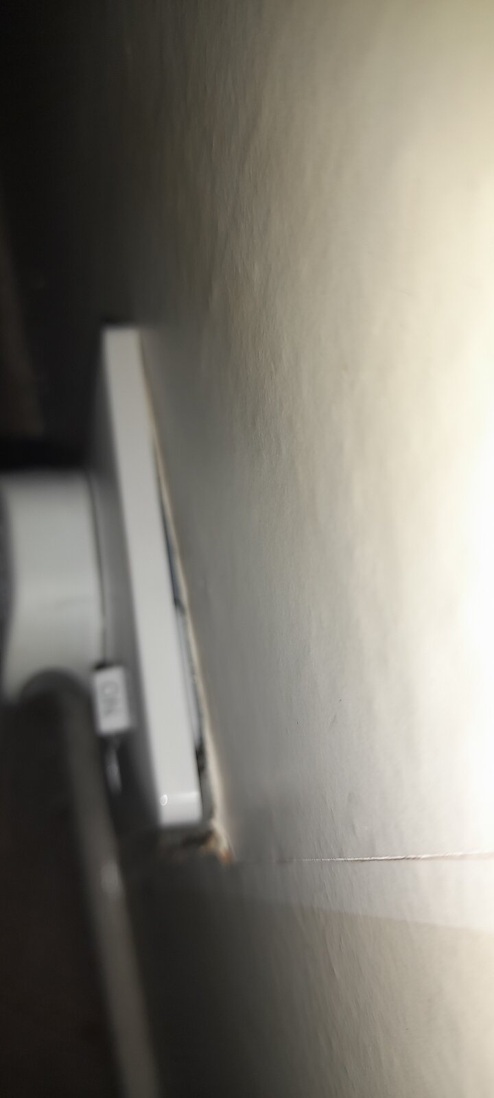

What's the best filler to use to caulk around gaps in a socket?
Is the gap in this socket (photos) too wide to caulk around? 20220225_104048[1].jpg . 20220225_104016[1].jpg
caulk is not the solution.
the socket is not correctly fitted in the wall
I can't see why not. maybe the backbox has come loose
what happens when you press the plate towards the wall?
maybe the screw is stripped
maybe the electrician was incompetent and the cutout is too small.
find out why and correct it.
what is the wall made of?

show us some pictures including the fixing screws, from the front and the side.

The wall? I don't know, it isn't brick as such i think.
I wouldn't call out his competence as the other sockets he replaced were fine.
it might, for example, be plasterboard on a wooden or metal frame, or stuck to the wall with blobs of plaster. Or it might be lightweight concrete blocks. The age of the house might give some clues. None of us know. To fix it, you will have to find out.
if this socket is hanging off the wall, it's either the electricians fault for not fixing it correctly, or yours, if you violently pulled it out of the wall. Which is it?
Mid 70s Barratt
I'd have thought plastered onto blocks.
Show us the screws.
You can cut off the power and loosen the socket by undoing the two small fixing screws from the front. That will show you if the backbox is loose or incorrectly fitted, or if one of the fixing screws is stripped (very common). You do not need to undo the terminal screws for this.

The right thing to do is isolate the power, remove the socket, make good the backbox (whatever that entails), make good the wall and decorate, then replace the socket onto a nice flat surface.

Agreed. When faced with sockets like that, I loosen the front plate and back fill so that there is no need for caulk. Caulking sockets is a bodge.
