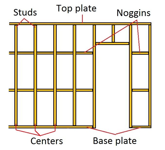

PS Noggin is a piece of wood. Usually added to support something.

Sorry what's a noggin?
Although the vertical positions usually do not line up, as staggering them means they can easily be nailed/screwed from the studs each side of them.
