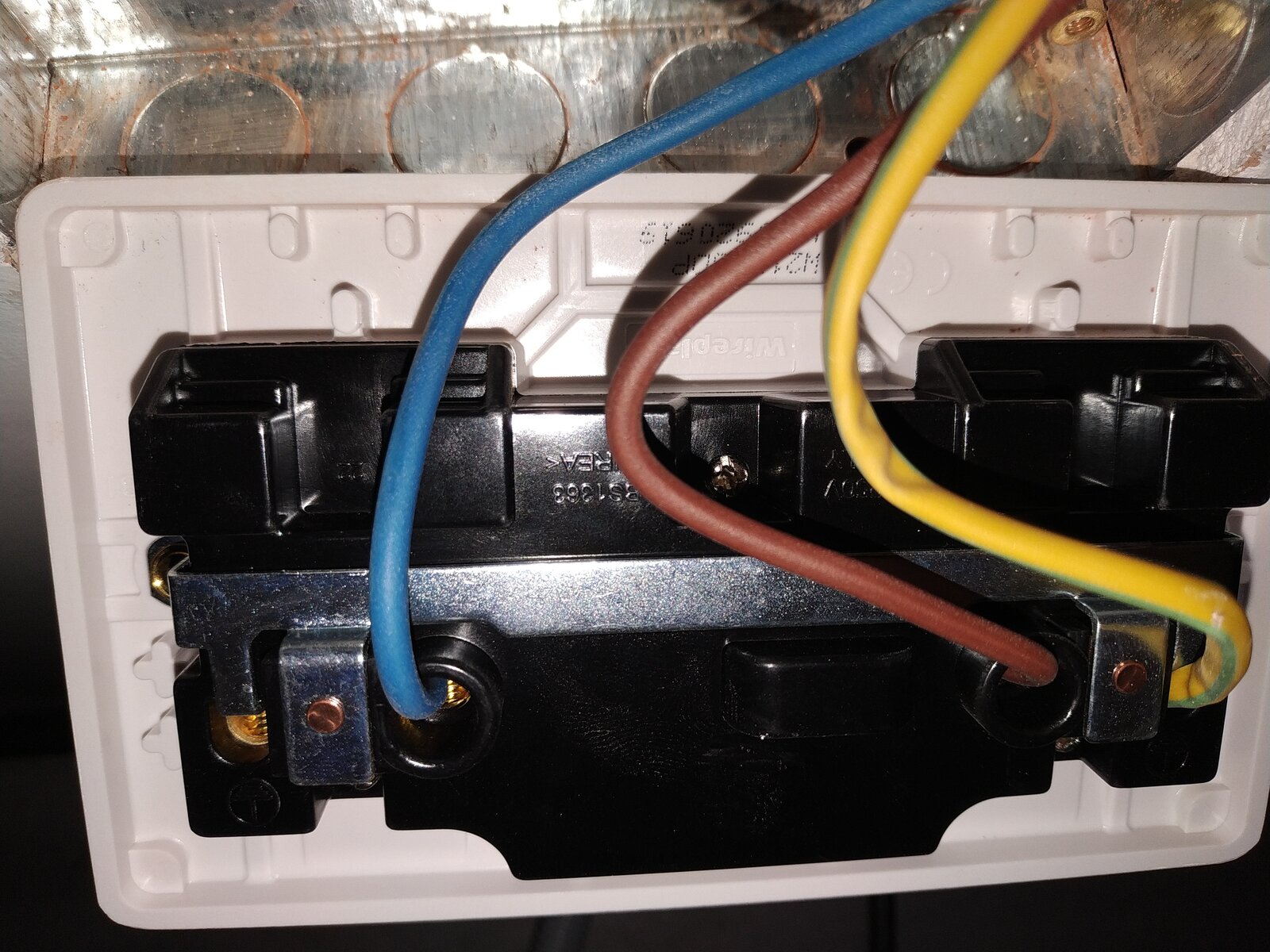

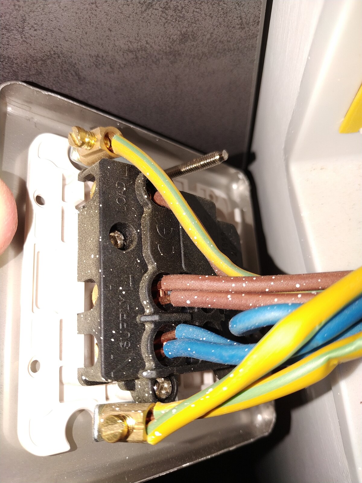

Hi,
I have a double socket connected to a13 amp switch fuse. We have a tumble dryer and washing machine running off the double socket - sometimes at the same time. I have since found out this isn't necessarily a good idea!
Anyway, since getting a new washing machine the consumer unit has been tripping. Once that's reset, switching on/off the spur switch is required to restore power. This morning the double socket no longer works. I have examined the socket and spur, neither looks burnt out. Am I best trying to replace the socket or spur (perhaps better quality socket) or could there be something wrong with the wiring? The earth wire in the spur is pinched but didn't think that would matter. Also appears to be linked to the upstairs sockets for some reason!
thanks

I would guess the fuse has ruptured, but unless the switched FCU also is an active RCD can't see why it would need switching off and on again, so that points to loose wire.
As to washer and tumble drier on same double socket, it depends on what type of tumble drier. My vented one I would set to 1 kW setting, as 60 minutes on 2 kW and 90 minutes on 1 kW so much cheaper to use 1 kW setting, and as such although a little over the 13 amp with washer on as well, likely you would get away most of the time without the fuse blowing, now with my heat pump tumble drier it uses 600 watt, so even less likely to have a problem.
However to use a 2 kW drier and around a 2.4 kW washing machine (while it is heating up water) is asking a bit much for a 13 amp fuse.

I tried replacing the fuse in the FCU this morning but the fuse door won't open. I will try replacing the FCU and report back

A 13A spur should handle a washing machine and tumble dryer, because they only reach peak loads at various times in the cycle. It may be earth related (hence the CU tripping), but worth replacing the spur and socket to check if the problem comes back. A plug in socket tester can be useful for some but not all faults.
The FCU was working again this morning - odd. It definitely wasn't the other day.
Anyway I changed the FCU and the socket since I had a spare. All working fine.
I couldnt remove the fuse out of the old FCU. Hacking away with a screwdriver the plastic looks to have melted, so presumably it has ruptured.

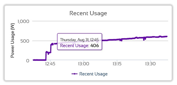

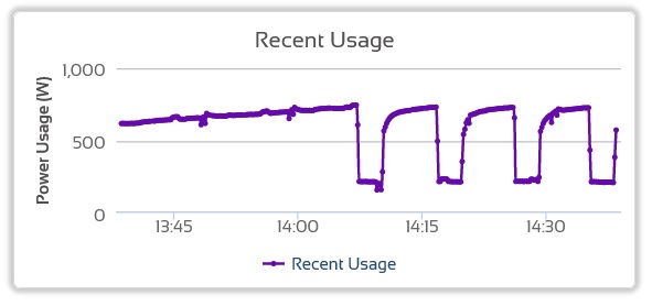

I have been measuring the use, it starts like this Thursday 31 Aug big load Mixed 1.jpgbut as it gets warm enough the heat pump clearly switches on off so this Thursday 31 Aug big load Mixed 2.jpgstarts, I find it had to say how much power it uses, as every time used the pattern seems to change, and since a heat pump, there is only one power setting it is either running or not running, where with the old vented type, we had the option of high or low, and since low both better for clothes and uses less energy, it was always left on low, it was a very basic model, so just a simple timer, if clothes still damp would switch on a second time, but for less time, in the main clothes were dry after 90 minutes run time, so around 1.5 kWh per load.
