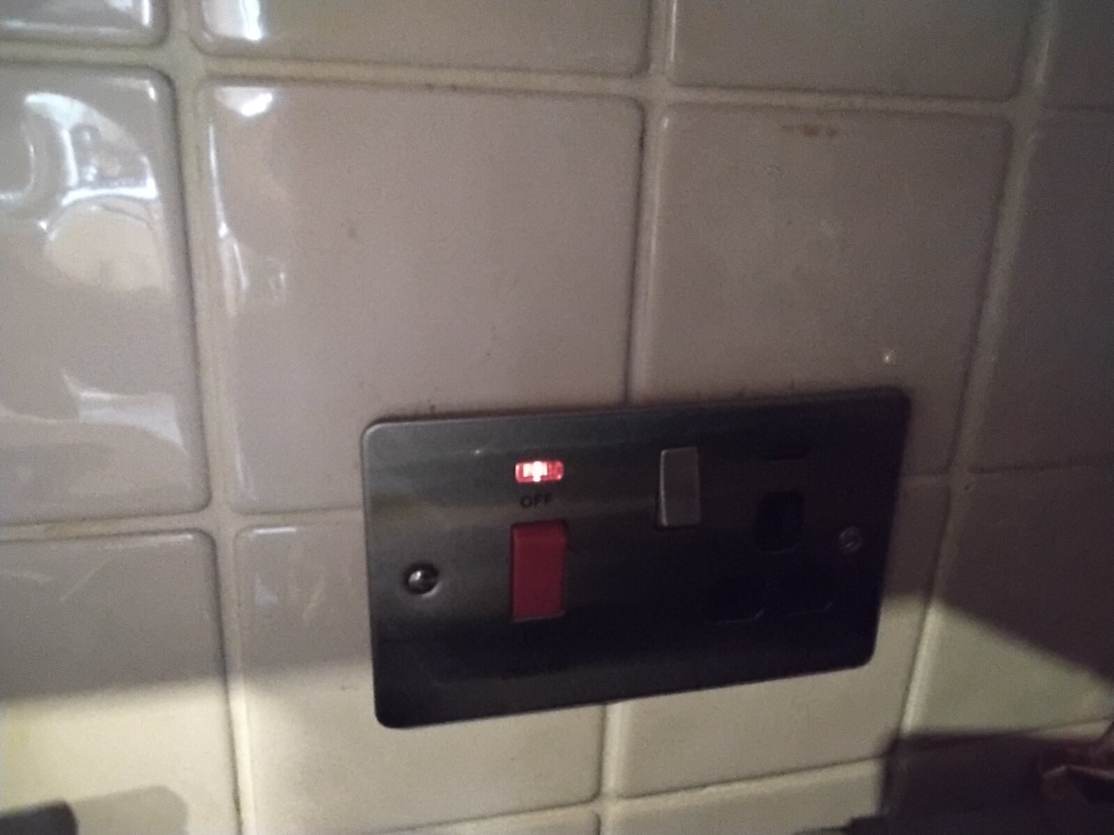

Hi all
Socket red light has started to flash past few days it is connected to oven which works
Normally as it should do does the socket need urgent replacement ? Does it have
Anything to do with oven workings? Thanking in advance for help/ advise

Is it actually flashing or flickering? Sounds like it's just the neon, nothing to do with the oven, other than to help state if the switch is on.

No it will be fine. It's a neon indicator, after a few years of use, they can become worn, and flicker.

Hi Stuckinarut my bad it is "flickering" thanks for your input
