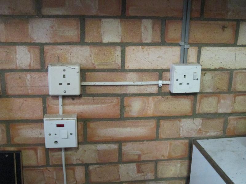

Picture of the socket in the garage would help.
Is it a normal socket or is it an unswitched socket next to an isolator ( FCU or similar ) and the kitchen sockets have been wired from the switched side of that isolator ?
here are a few pics, if it is any help:
the socket arrangement in the garage:
the FCU, when switched off, it only isolates the supply to an under cabinet heater fitted in the kitchen and nothing else (heater is on the opposite side of the wall).

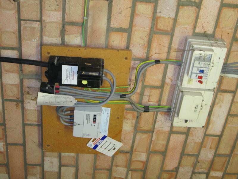

the fuseboards and meter, if it is any help:

Do we assume when you say socket, you mean the right hand one with two grey cables coming down into it?
I think that's a very reasonable assumption! - the OP told us separately and specifically about the offending socket (with a switch), the unswitched socket and the SFCU.
Kind Regards, John
Has anyone noticed the un-switched socket has mounting screws top and bottom, not either side as is usual.
Also, the fcu has a cord outlet yet it is wired in through the patress box.
Whole thing seems to raise suspicions to me.
Has anyone noticed the un-switched socket has mounting screws top and bottom, not either side as is usual. Also, the fcu has a cord outlet yet it is wired in through the patress box. Whole thing seems to raise suspicions to me.
All true, but none of that even remotely starts to explain what the OP is describing!
Kind Regards, John
Me too...
First suspicion is that were looking at multiple spurs from spurs here. IF the 2 grey cables are in fact part of a ring final that is. We can assume that if 2 the 2 double sockets in the kitchen are affected then they must also be wires as spurs, if they were part of a ring then multiple faults would be required o give these symptoms.
Second suspicion is that we're looking at the work of a genius bodger here, which makes almost anything possible...
