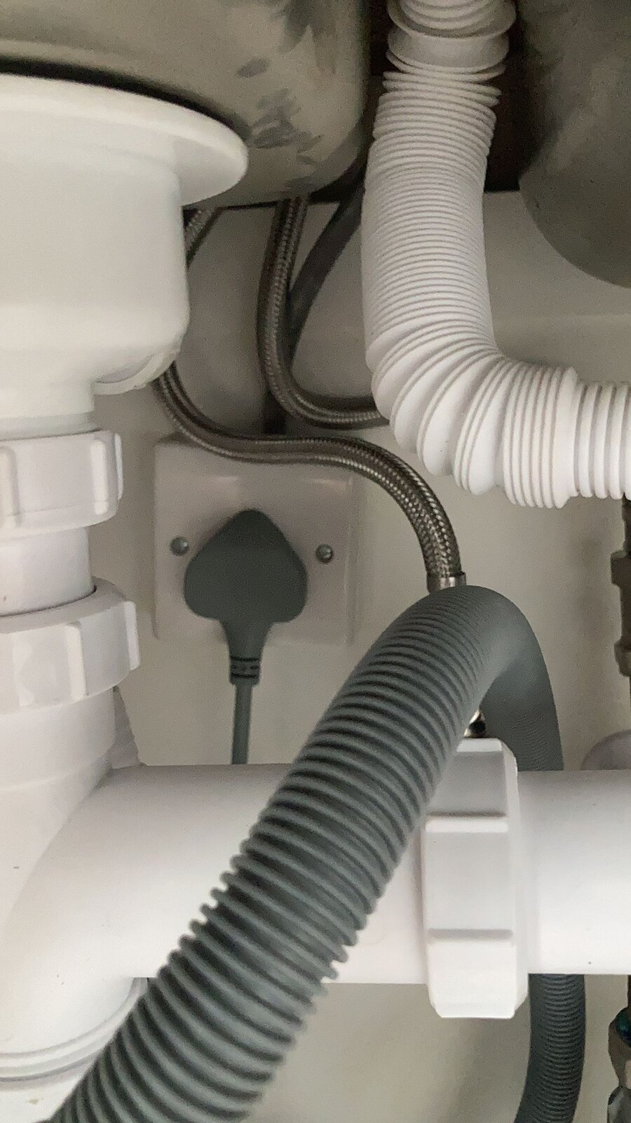

My daughter just texted to say that she has just noticed a plug and socket under the sink , for the dishwasher.
This is a brand new house. I told her it may seem a little strange but is probably within the regs.
Can you confirm it is still allowable, please?
I was on a job where fuse box was under sink. Makes no sense.
It's permitted but IMO undesirable.
I'd consider swapping it for a weatherproof "outdoor" one with the cable entering from underneath and a lid that will shut with a plug in it.

Also at work on a customers site an emergency stop button for a rooftop chiller mounted above the contactor which was mounted above the isolator with conduit couplings. Conduit from bottom of isolator through wall to bottom of horizontal trunking which turned a corner and dropped several floors then into horizontal trunking and then with big brass bushes ~4" and couplings into top of control panel, where the water ran down the wires to the internal slotted trunking and dispersed into the top a row of MCBs, the insides of one had rotted and failed (for a completely different circuit).
Seeing the water damage I insulation tested and found a problem on the chiller wiring and hence the contactor, it was easy to trace the water marks in the salty atmosphere.
My instruction for repair: replace the faulty MCB and contactor, when I returned with parts I found a hood around the E stop fashioned from an ice cream container.
A lot of hysteria in the world about electrics under kitchen sinks.
Yet it's ceiling lights and pull switches that get soaked when there's a leak...
