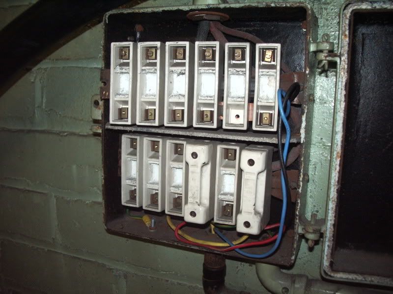

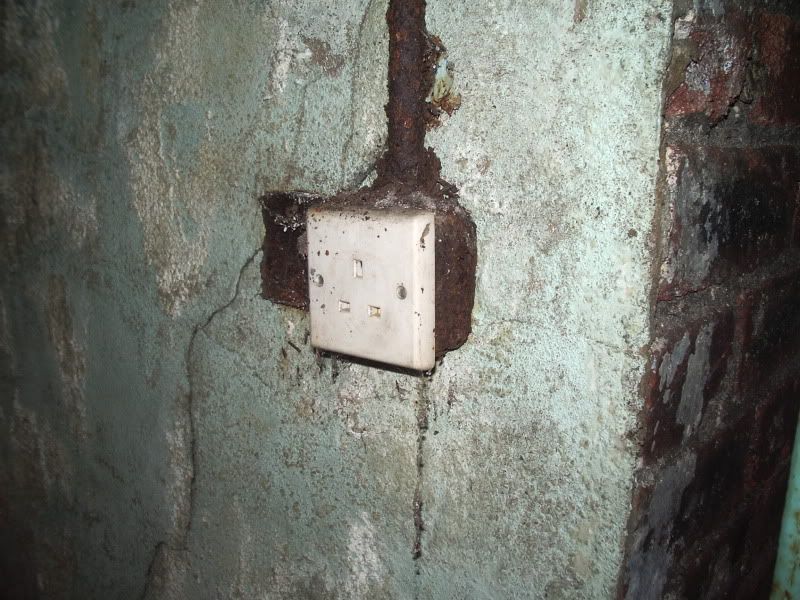

I'm still on that periodic at the moment, and I came across a socket today which had a Zs reading of 24.2Ω
The Zdb reading was 0.03Ω and the socket is only about 6 meters away from the DB. The conduit is the CPC.
Any ideas?
:shock:
the running coupler may have worked loose, give it a tweak and lock it off again and see if that makes a difference..
I've seen a higher resistance on conduit that looked no where near as bad as that... granted though I picked it up with the low ohms meter rather then the loop tester, so that might have some bearing on the actual reading given that the earth path was unsound... :lol:
Did you pull those fuses Rob?
Anything with asbestos content goes down as a limitation in my book as far as pulling the fuse is concerned
No! Put it as a lim, and it's all been noted on page 2 of the PIR (well page 8 actually :lol: )
It would seem the top rail in that DB was for the neutral fuses, and someone has bodged the circuit neutrals onto the nuetral busbar behind the ceramic holders!
Didn't probe too far as the DB is fed from an oil CB which also feeds another couple of DBs in the mill.

24 Ohms????
Surely you'll get a better return path through the manky brickwork!!
That volt stick isn't effecting your connection to neutral by any chance Rob :lol: :lol:

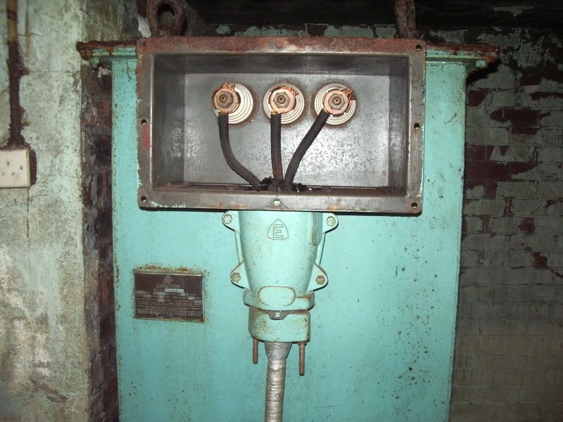

Christ where are you mate? Looks like a certain garage not far from you!!!!
Can I spy an oil filled transformer/capacitor in the background of the first pic with a missing cover?
You jumped ship from Yorkshire Ohraf?
