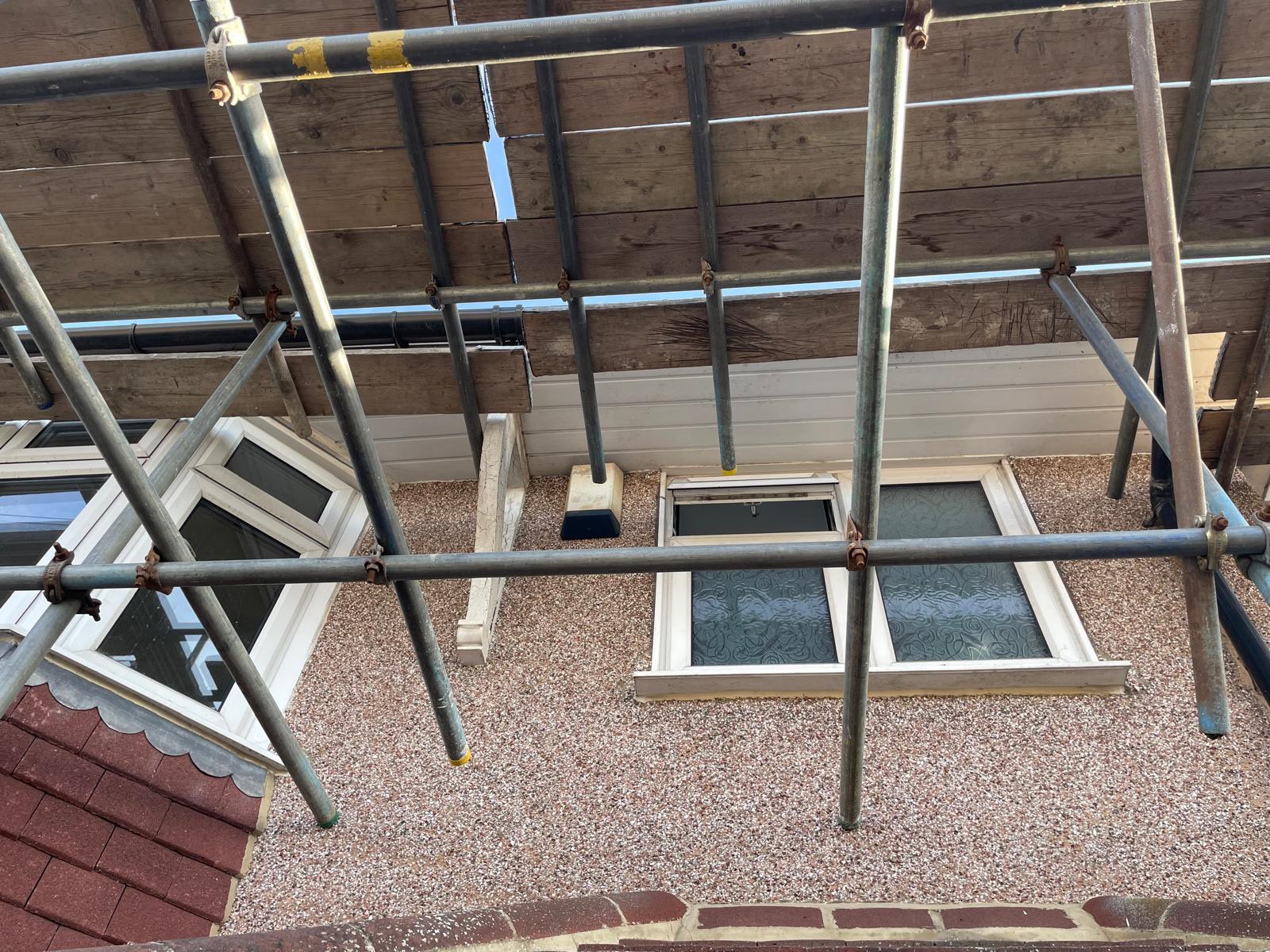

Having just had my roof tiles replaced including the installation of breathable underlay, I would like to install more soffit vents as I only currently have them at the rear of my property. I am going to use a number of the small round vents that can easily be installed.
At the front of my house the soffit is quite deep and I am trying to ascertain whether the position of the round vent should be equidistance from the house wall and fascia or should they be closer to the house or further away? I am probably overthinking it but looking for advice.
I have attached a photo of the depth of depth of the soffit.

Get the roofers to fit OFV's...

OP, my circular soffits are in the middle of the soffit board. No issues (I just don't have enough for proper ventilation in my house). Just make sure you keep your insulation away with a rafter tray.
