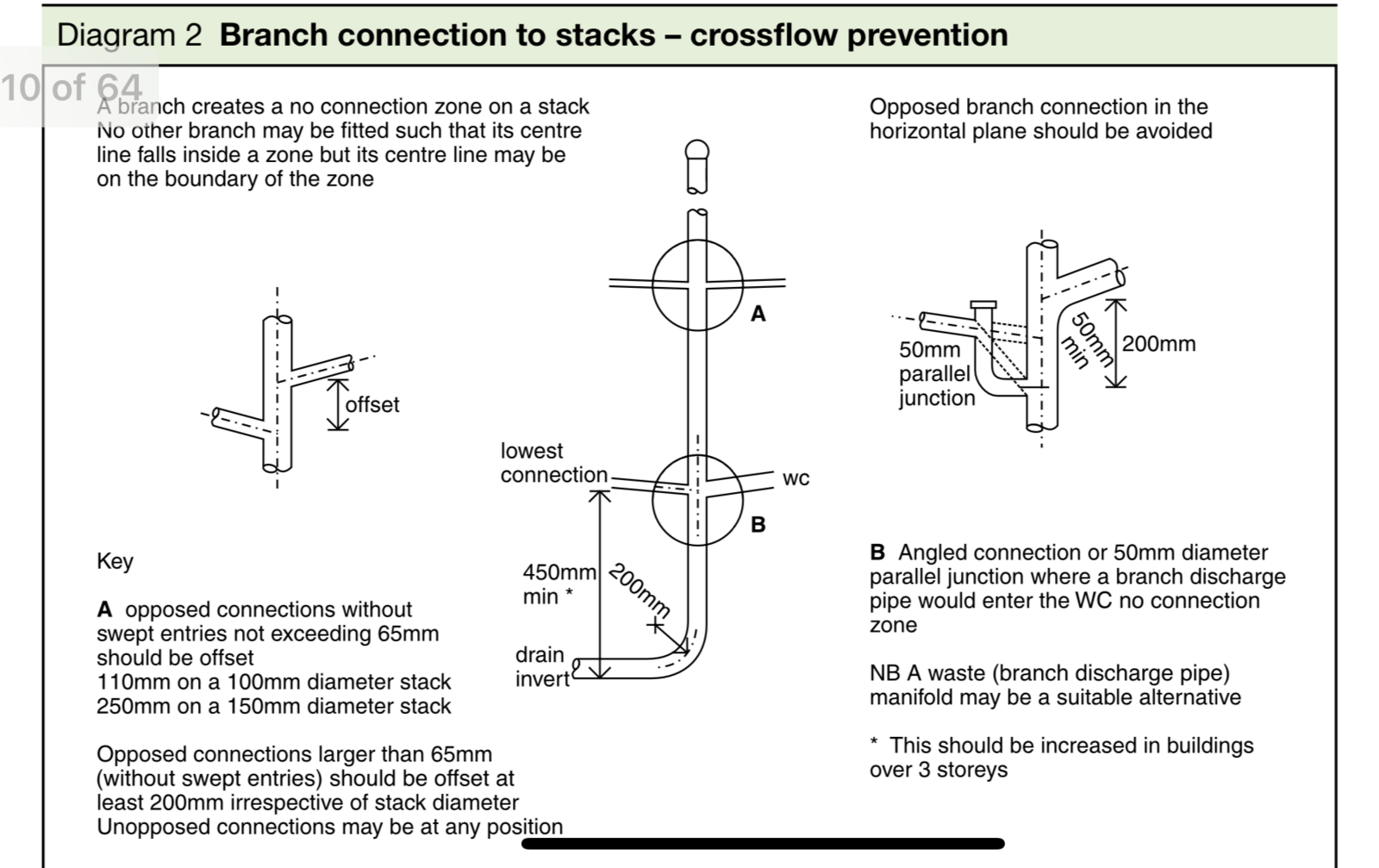

Is there a distance soil pipe bosses should be apart if there bossed in on opposite sides of the stack?
Tenth page (labelled as page 8 ) of https://assets.publishing.service.g...achment_data/file/442889/BR_PDF_AD_H_2015.pdf
Note that Approved Documents are merely ratified ways that the building regulations may be adhered to. They are not the only way things must be done; you and your building inspector may agree alternative options that can be demonstrated to comply (though in this case I expect you'll just do it as outlined in the AD)
