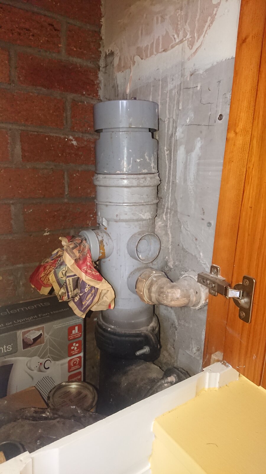

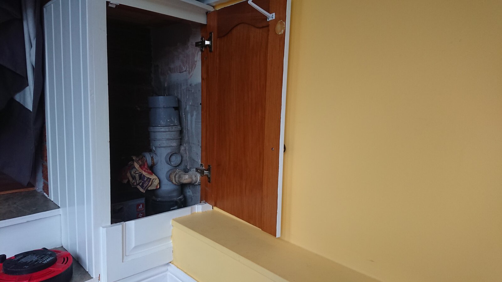

The soil pipe is in an extension on the back of the house. It would previously have been outside. The extension is probably around 15/20 years old, and was present when we moved in 8 years ago.
The soil pipe has had a cupboard built around it, still in the same place but now inside the extension. I have no issues with it but am planning on selling in the future and don't want to find a problem at the time. A couple of questions.

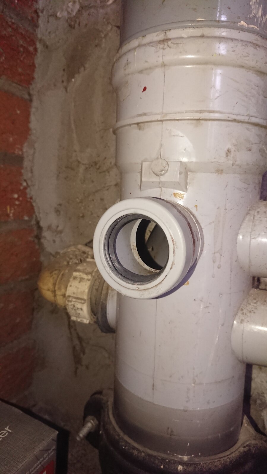

1. The newspaper is blocking up an empty port/connection. What cap should I get to cover it properly? The paper has been there presumably from when it was first fitted. No smells etc.

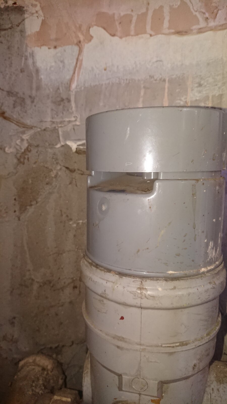

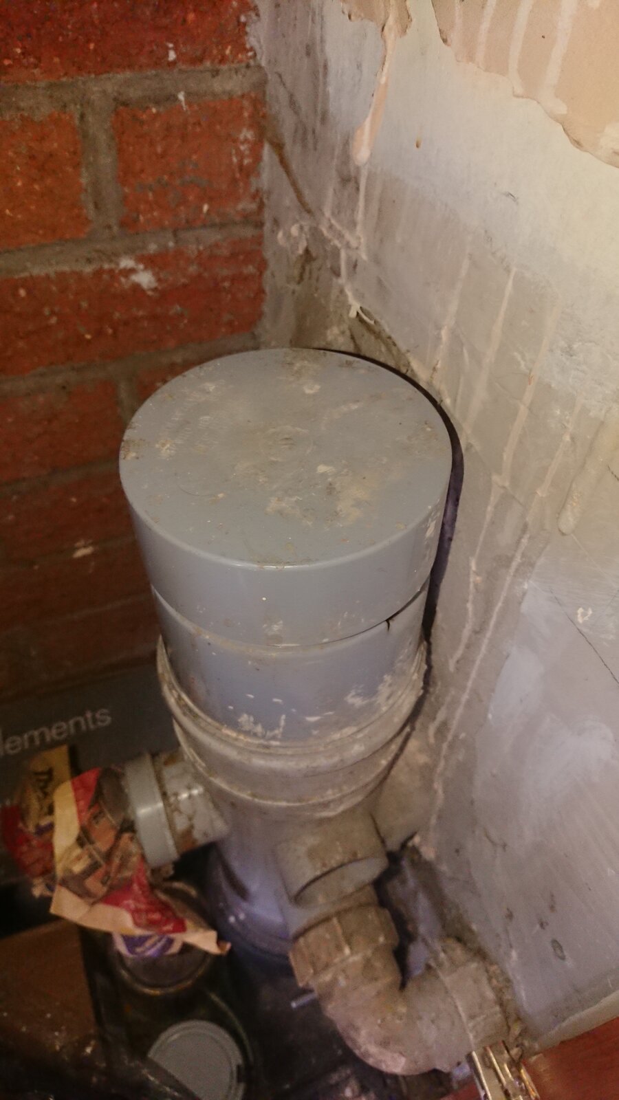

2. Should it be vented externally? There are no smells etc, no issues with plumbing/draining. Hopefully it's ok as it is because venting externally will be tricky...
Thanks.
DSC_1378[1].JPG DSC_1379[1].JPG DSC_1380[1].JPG DSC_1381[1].JPG DSC_1382[1].JPG
That is an air admittance valve on top. A one way air valve, to let air in, but not let sewer smells out. It avoids the need to have a pipe running outside, up the front wall or through the roof.
Measure the diameter of the hole, to source a blanking plug.
Great news, thanks both. Good to hear it doesn't need to be vented externally, and a plug should be easy to find. Thanks!

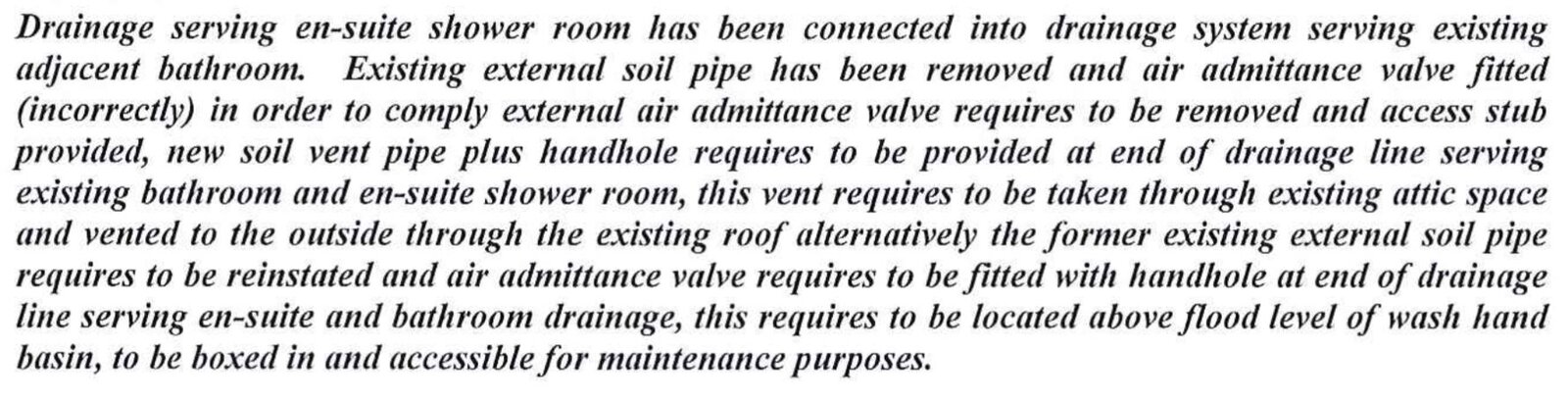

Sorry to drag this up. Just found an old document relating to this installation. Can anyone tell me why they've said the AAV has been fitted incorrectly? Thanks.
You've answered your own question in the first line of your original post.
The soil pipe was originally external and would have vented to atmosphere at roof level, allowing the drains to breathe. Extension has then been built and for whatever reason, (possibly cost, possibly laziness), instead of drains and/or stack being rerouted to continue to vent externally, the soil pipe has been chopped down and capped with the AAV, removing the vent, and effectively sealing the drainage system.
They are asking for the vent to be reinstated, and are saying the new run serving the extension (?) can be terminated with an AAV.
Thanks for the reply. I have a poor understanding of this as you can tell. I thought the purpose of the AAV was to allow air into the drains, and therefore the stack could then be routed internally. Sounds like that's not the case? Would the external soil pipe have also vented to atmosphere, rather than just allowing air in to prevent a vacuum in the drains?
Why would the new run serving the en-suite (put in by previous owners) be allowed to be terminated with an AAV when the soil pipe itself is not?
Just trying to clarify because your reply is at odds to the first two replies above. And then I found this document which flags it up as an issue and I'm asking again.
Thanks.
AAV's do exactly that, they admit air into the drains, issues often arise as they wont allow positive pressure out. Your problem is, a former vented stack, that would allow air in and out of the system, has been capped with an AAV, so any positive pressure is not able to escape to atmosphere unobtrusively. What often happens in these situations is, any positive pressure building up in the system looks for the easy way out, usually the shallowest trap, which tends to be a shower. People come on here asking about smells and/or gurgling traps, first thought is usually, have they got a vent or is there an AAV fitted.
Building Regs state the highest point of the drainage system must be vented, if the en suite was connected into the drainage system downstream of the original bathroom, (and assuming there was still the original open vented stack in situ), a second vented stack was not necessary.
