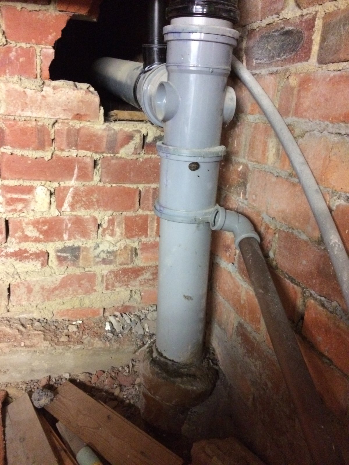

Hi there,
Hopefully someone can help. There is a gap from the plastic pipe to the clay pipe as shown on the image. I was not sure how to seal it / what product to use. There isn’t a leak dripping as such but you can see the dirt between the crack and there is a slight smell of drainage. I did not know if I could use some sort of sealant or what would be best?
Jason
Hi Jason,
Hard to tell from photo as it links to plumbers forums (external site), but if it’s 4” then use a drain connector such as a McAlpine dc1bl. HTH
Thanks, not sure if the attached image is any better.
Many thanks
The McAlpine fitting might work but a problem is that the clay bend is slightly skewed to one side.
One way would be to lift out that amateurish jumble of fittings and pipe to attempt to get the McAlpine on the pipe, and into a cleaned up hub.
But any movement might break the seal on the strap-on waste fitting above?
Or, you could cut the pipe above the clay hub to remove it, and fit whatever will work in the bend hub?
Or you could leave things in place, and simply clean off the hub rim, and make good with a sand and cement fillet?
It looks like you have an AAV - but, if so, it seems to be too low down in the installation. When needed it could well be flooded and useless.
Do you have an access fitting/clean out installed out of sight? Or could you get access thro the AAV position?
Do you intend to connect the loose waste pipes to the 110mm pipe?
The 110mm pipe must be clipped.
