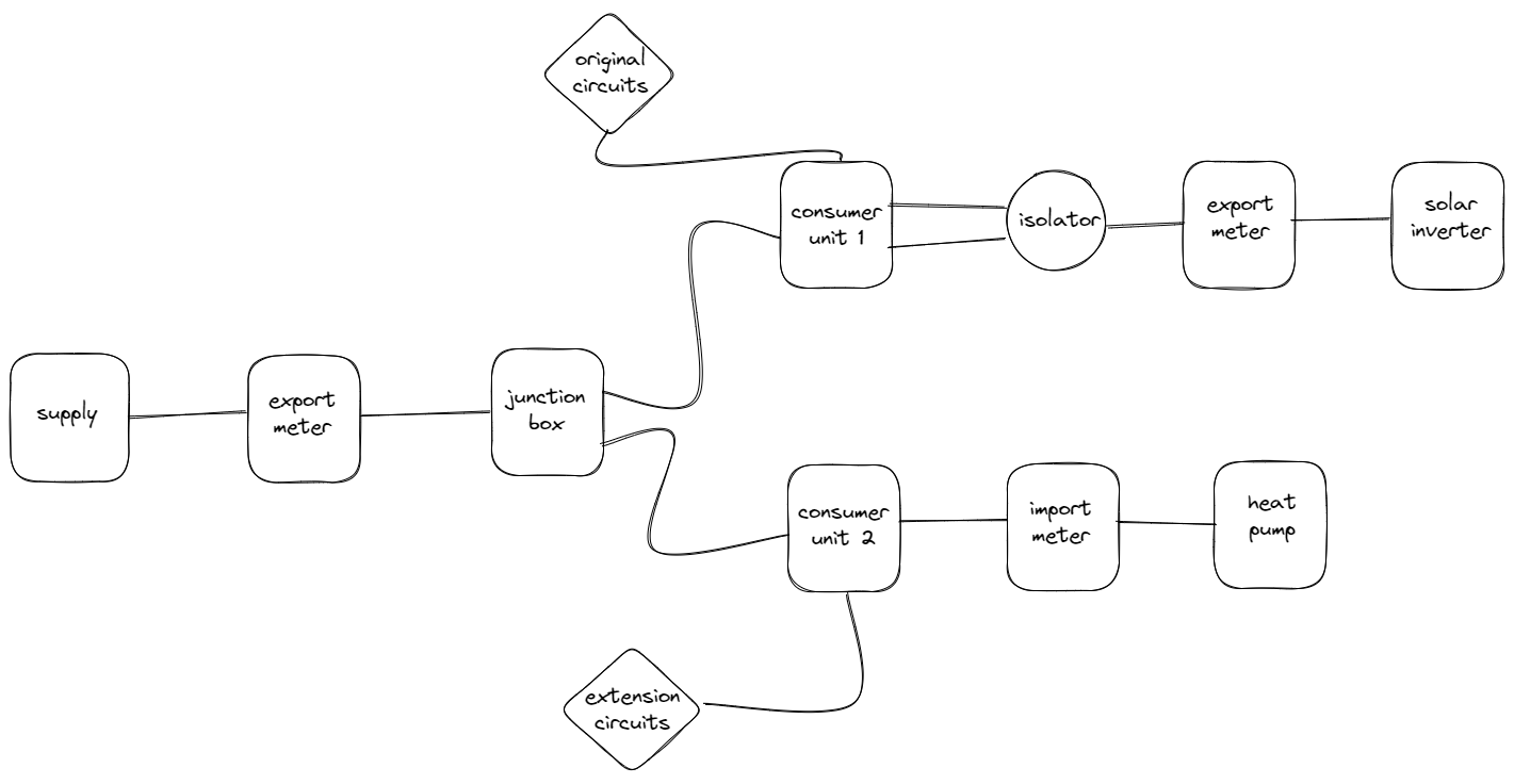

Hi, sorry to resurrect this thread but I have this same situation and it seems like the second consumer unit is bypassing the solar and only using mains power. Solar was already connected when the second consumer unit was added, and the electrician who did wasn't sure whether it would work or not... Does something need to be changed to get solar to consumer unit too?

The only issue I can see is the labeling of the meters. The one next to the inverter would usually be called a generation meter. The one nearest the supply would be an import meter and would be what you would pay based on. The other one doesn't do much unless you are on some scheme I don't know about.
Basically the generated mains would find its way to whatever wanted to use it rather than go through the import meter.

This doesn't add up, the junction box cannot "know" to somehow let energy flow from the import meter to CU2 but not from CU1 to CU2, unless it is not merely a junction box [I don't know the word for what such a thing would be].

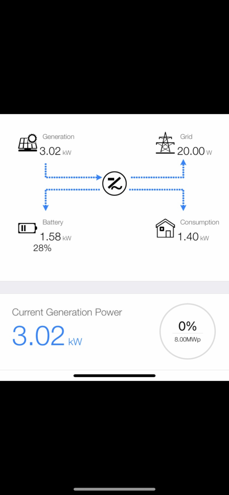

I have solarman app connected to the inverter. It doesn’t ‘see’ any consumption on consumer unit 2, but it gives consumption on 1, generation, battery, and export.
When I first looked it said generating 3.02kw, send 1.58kw to battery as below.

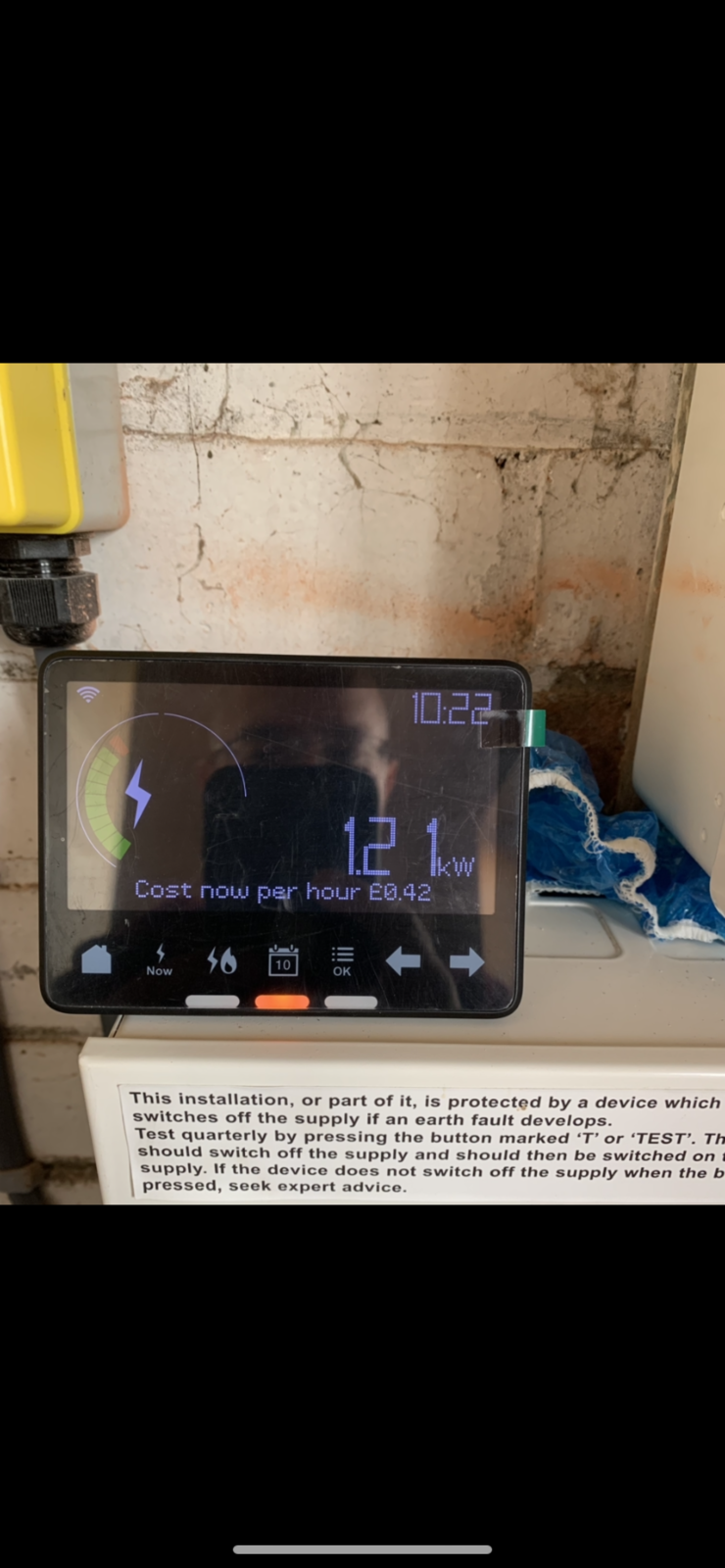

At the same time, my smart meter said I was taking 1.21kw from grid.

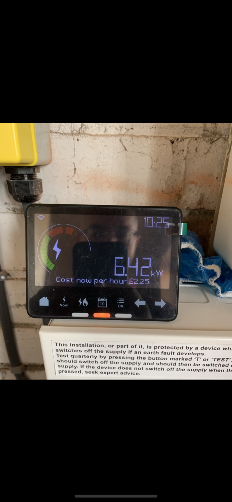

I then turned the oven on (consumer unit 2). Battery charge had gone up a bit, and draw from grid went to 6.42kw.
It seems maybe the inverter prioritising the battery over usage? I didn’t notice in January, but now the days are longer the battery fills up early afternoon. and I’ve paid for a bunch of electricity at the same time.
Do you know where in your diagram the measurement current transformer(s) are? I get the impression they are not positioned correctly. Mostly because the import doesn't show the same as your smart meter.

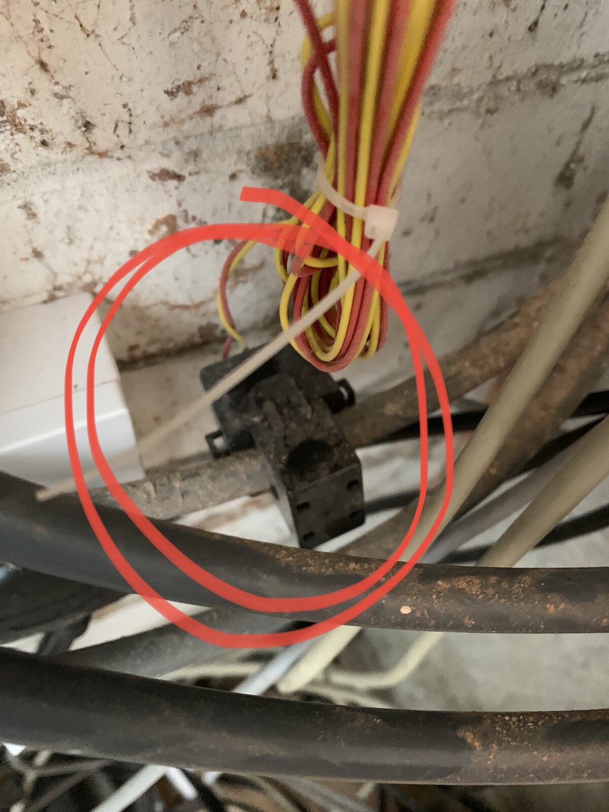

Is that the current transformer the thing in the pic below?
The cable runs from a port in the inverter for current transformer and this widget is around the live cable to consumer unit 1 as it leaves the junction box.
Yes, I would have thought this should be round the live at the smart meter.
Thanks, that makes sense... I suppose it was until the junction box was added, and then it placed on the wrong side. Is this something I can unclip and move, or does it need an electrician?
